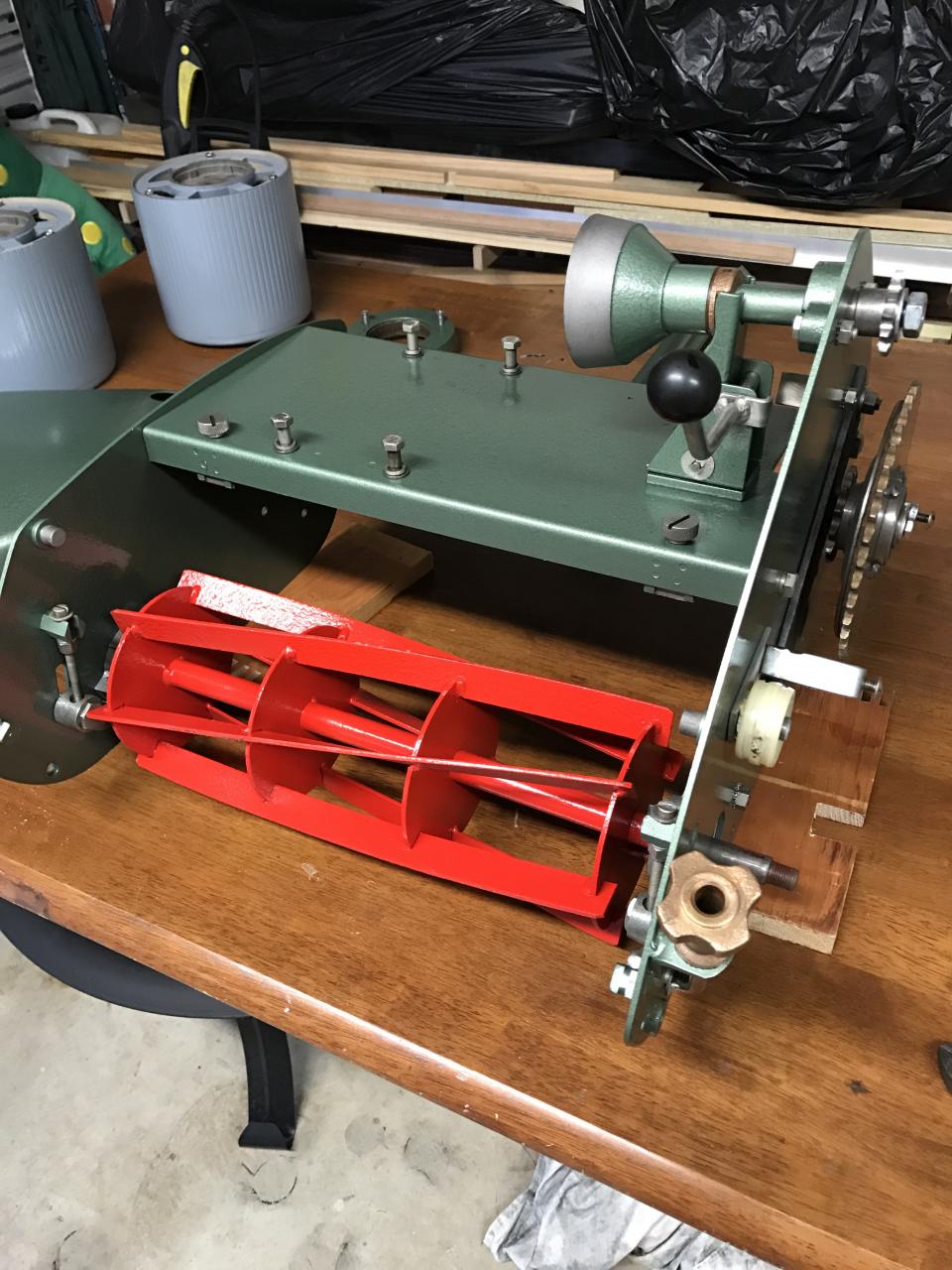

Just wanted to share progress of a 14" I am restoring. All components have hot dipped, bead blasted and/or sonic cleaned. Wanted to retain as many of the original fasteners as possible so all nuts, bolts and washers have been nickel electroplated. Will post more pics as I get time to work on it.
Hi Scott,
Why would you Nickel Plate all the fasteners ? That's highly unusual.
Joined: Nov 2016
Posts: 70
Well, I wanted to retain as many of the original fasteners as possible at the same time preventing them from rusting or corroding. I looked at zinc coating but the finish is too dull for my liking. Nickel plating can give a good look without any additional steps, is a tough coating and looks similar to the original fastener appearance when new.
Joined: Nov 2016
Posts: 70
Hi Scott,
Well it's certainly looking stunning so far.
All the original fasteners were zinc plated and bright dipped which is a process straight after the zinc bath.
Nickel has a bit of a habit of going really yellow and eventually allowing rust penetration. Zinc has far better anti-corrosive properties. Nickel is also rather brittle.
Nickel is always used in the chrome plating process as being the surface brightner under the flash of chrome that's put over the top.
Anyway I was just wondering why you have the reel installed ? is this just for the photos and then removing it again to drop it of at the machine shop to be sharpened along with the bed knife ? as I hope that's you process.
PS. I will say that as of late we are now seeing some really good restorations being done here at the ODK. Yours is no exception, it's superb.

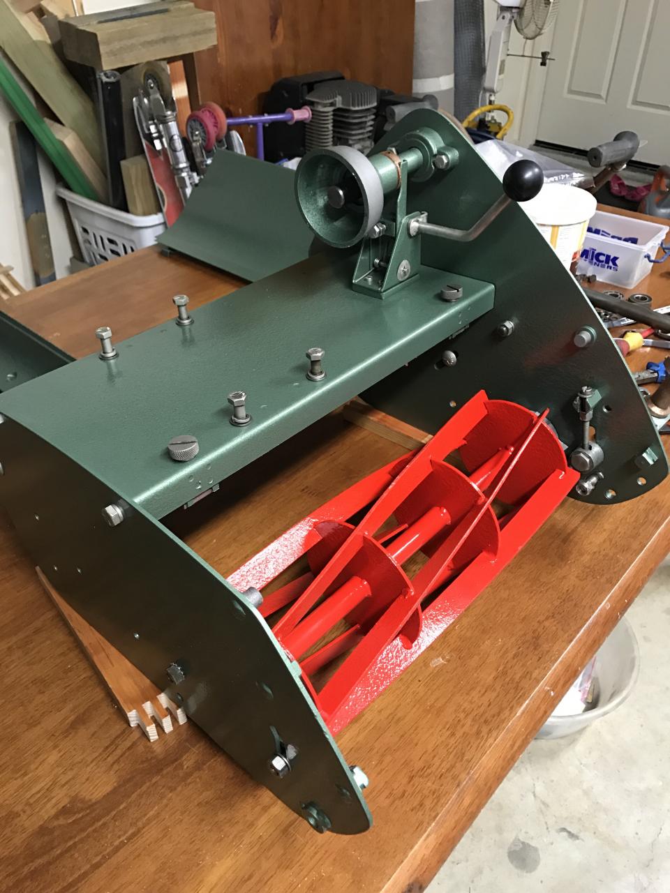

Some progress pics. [Linked Image]

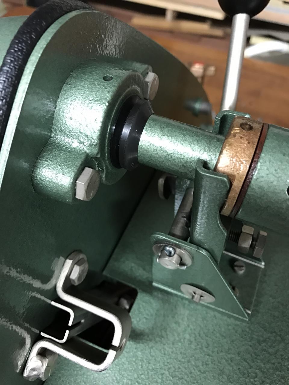

Likes: 304
Hello Scott and Mod BB
Most certainly, one of the great Model 45 restorations.
There are enough Model 45s to afford liberty in the end product.
I feel the photos will also help and inspire others.
I found this image particularly interesting.
Just look at the detail!

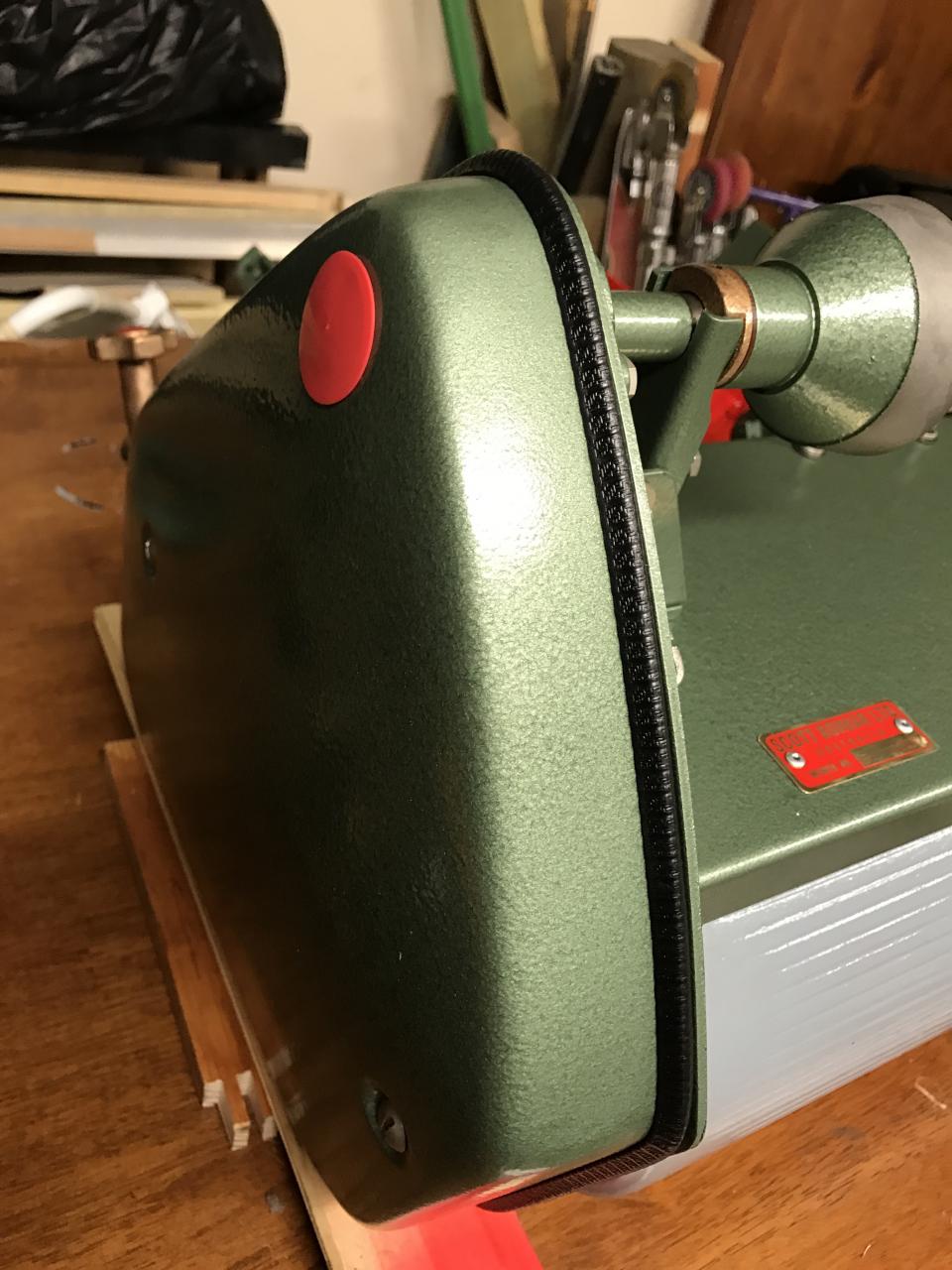

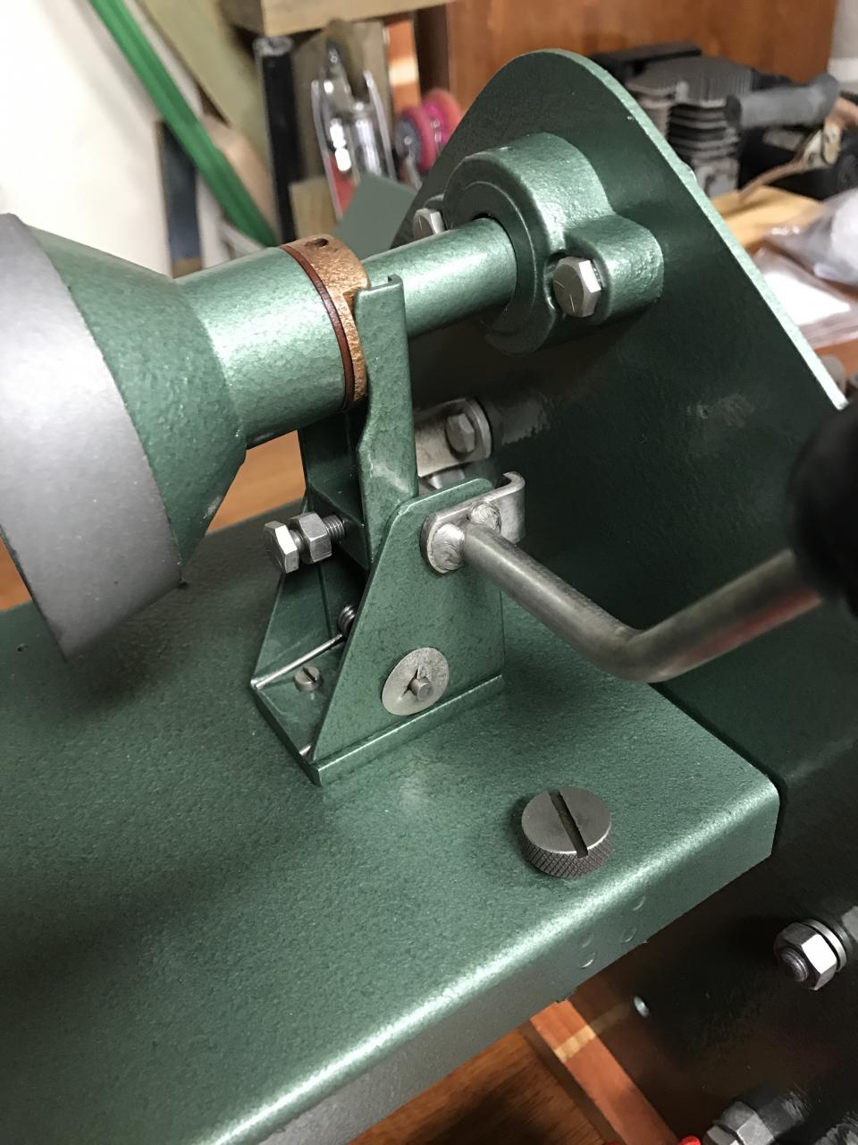

Hi Scott,
Remember that these are only small things that could be remedied,
Brass finish on height adjuster (should be green) but I like it as is.
Fasteners are Nickel plated (should be bright dipped zinc)
Thrust pad is brass finish (should be green) again I like it.
Pinch Weld on chain case (simply remove it)
