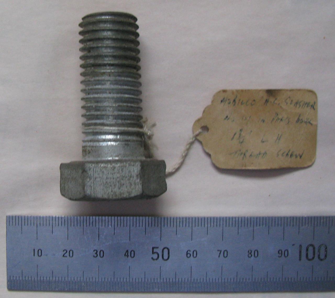

A NOS bolt for one, from my bits'n'pieces collection:
