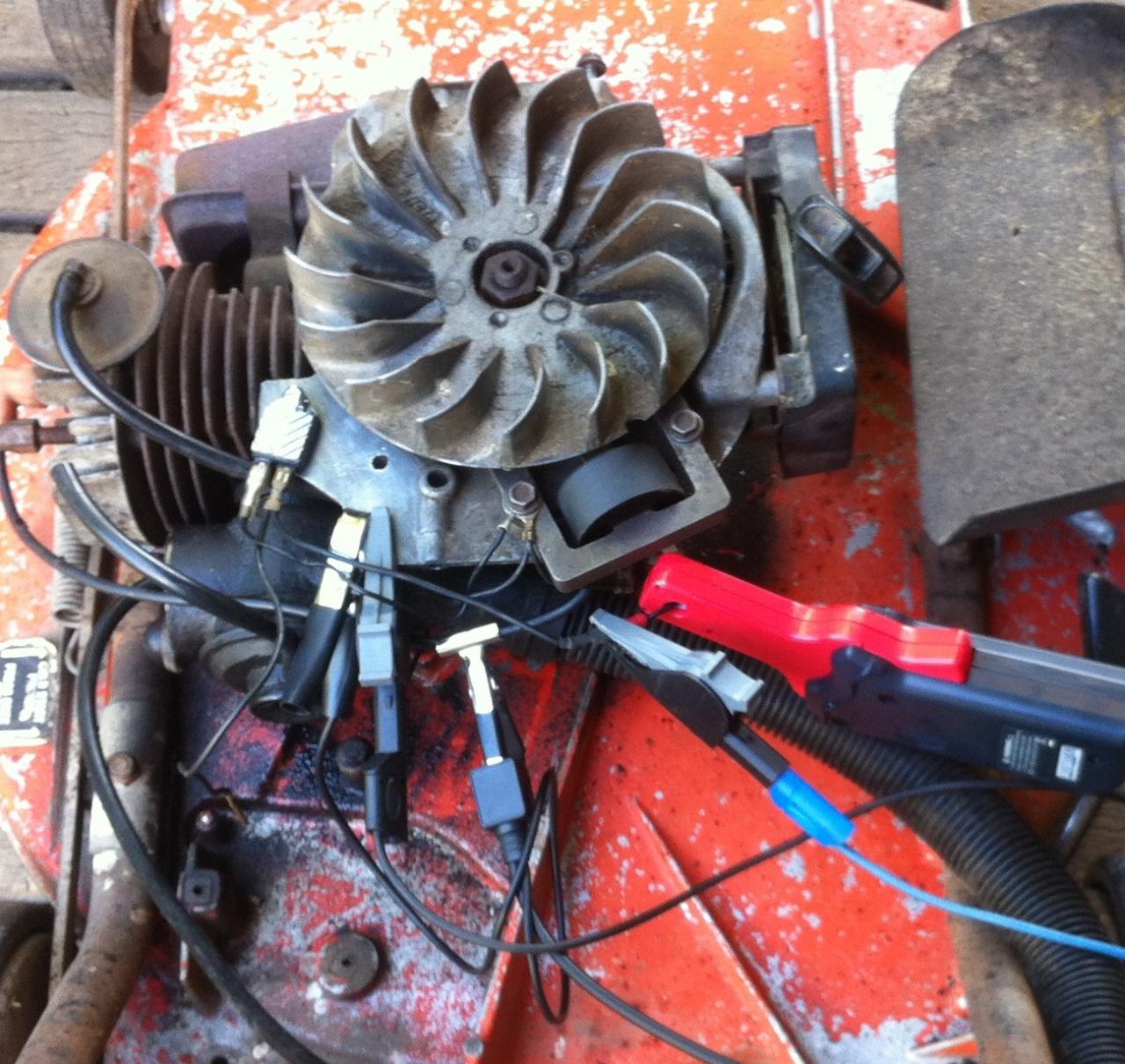

Ok thanks. It still won't start. The oscilloscope still says the coil is producing 5KV but plug isn't sparking - even with heroic cranking. I guess I need to find another coil & module. I don't think they're going to be able to mow the lawn before Christmas at this rate.

Hi Norm,
There is still no spark with the kill switch pin removed from the carby and isolated from any potential earth.
There is no resistance between the coil mounting and the spark plug.
However, there is also no resistance between the earth lead and the primary terminal on the coil - even with the primary lead disconnected. The resistance between the primary and earth terminals is 1 ohm.
This is very puzzling as I would have thought that would short the coil out.
I would also think that if the timing was out it would still produce a spark like a Briggs & Stratton will when it has sheared a flywheel key. However, Victas may be different.
The other thing worth noting is that the flywheel has a noticeable horizontal runout that runs to 1/4" on the flywheel rim. This seems to indicate that the crank has been bent.
Maybe this is the problem, although when I set the magneto air gap it was even on all three legs when spun past the two magnets.

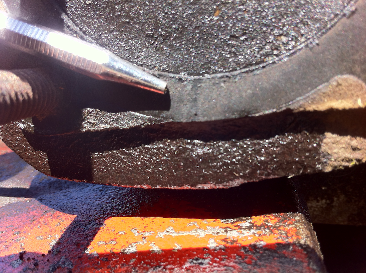

It won't start with the decomp valve installed. However, there's fuel leaking from the head gasket so that probably explains why as the compression would be too low. Once the plug is wet, it won't go until it is cleaned with contact cleaner. Then with a few backfires, it eventually runs again. I could lightly flap disc the armature where the coil goes over to see if I can get a cleaner earth. Otherwise, the spark is too weak to support combustion. I guess the reason it will restart just after it has been turned off is the hot carbon deposits ignite the fuel & kick starts it until the spark can take over! A bit like a pilot motor on the old Cat bulldozers.
Edit: I've cleaned the armature and noticed it is spreading out at the back. Maybe this is the cause? I can't really fathom what the cause of the weak spark is. Cleaning didn't make any difference.

I've cut out a gasket using thick gasket paper and PEP gasket cement. I then torqued the nuts to 15 Nm. It still won't start with the decomp valve fitted. When fitted with a second spark plug blanking the decomp port it will eventually fire as long as the plug is cleaned with contact cleaner every 3 pulls or so. When it does run it revs up to governed speed and cuts out and then it backfires and stumbles and then it blows the head gasket. It must have cut a groove in the head. I've made two gaskets with the same results. All I can do now is skim the head with some wet & dry paper and try again.

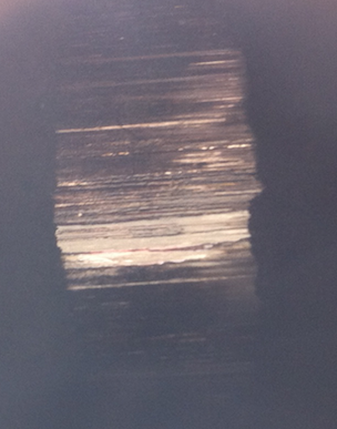

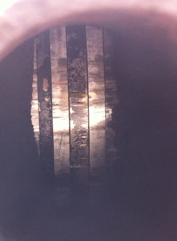

Yes Squizzy they're fairly bad. Still I have seen old Stihl chainsaws that look far worse and can at least produce a good spark!
The odd thing is why the spark is so weak.
Two replacement coils and a new module hasn't made any difference, which rules that out.

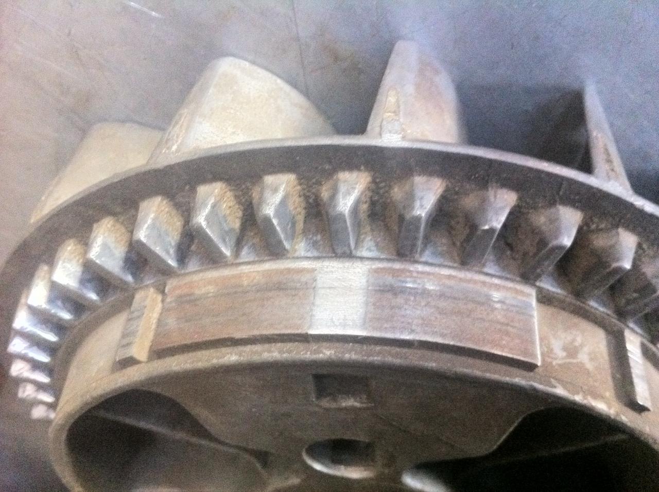

Edit: Just noticed it says Power Torque key start. I must be getting brain fade....
This flywheel has magnets 180 degrees apart. The one I'm working on doesn't. Is this an update or for another model?
Note it has the ring gear for a side starter and the magnets are level with the fins, not underneath.

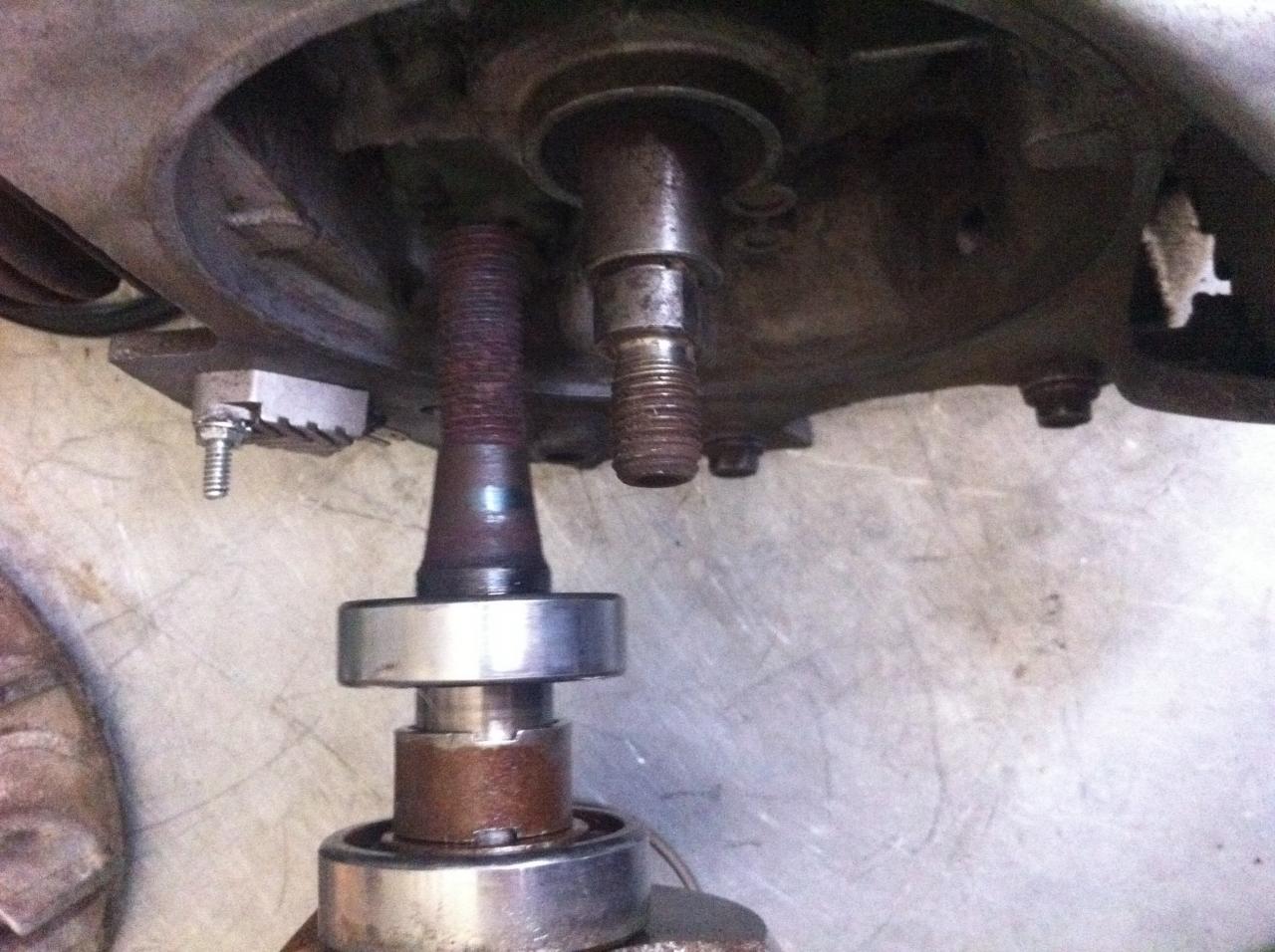

Does the flywheel on the engines fitted with the impulse starter have a cup with a nut on top of the flywheel?
I've got a scrap Victa that was seized up and this one has a cup that goes on top of the flywheel. Visually the barrel looks the same. However, the crankshaft is tapered to suit the older flywheel with the internal magneto and won't fit the later external magneto type flywheel. See the pictures below:
Flywheel off older internal magneto engine:
Comparison between older crank on left:
Comparison of older barrel on the right:
Once the flywheel nut is loosened, there is a noticeable wobble between the flywheel & the crank, which would no doubt upset the timing quite a few degrees depending on where the flywheel was sitting on the shaft when the nut was re-tightened. The flywheel came off the shaft with very little effort. Note the aluminium flywheel mounting doesn't show any signs of fretting against the steel shaft, even though it is a loose fit.
When testing the runout of the flywheel end of the crankshaft with a dial indicator, it indicates a deflection of 40 thou when rotated! Maybe this is due to a mechanic levering off the flywheel unevenly?
The crankshaft end float is 2 thou. This amount of float seems acceptable.
