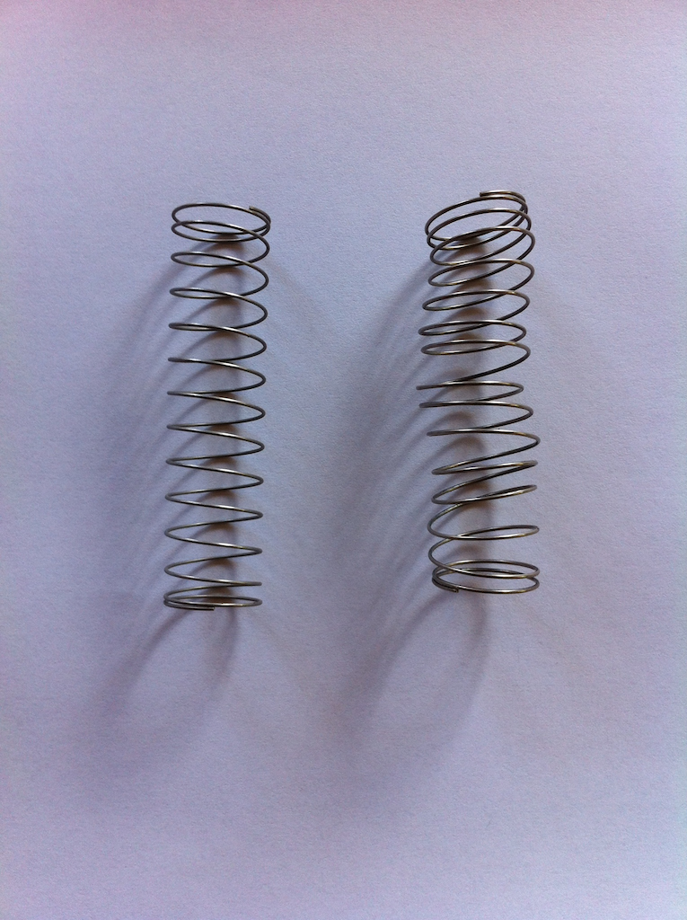

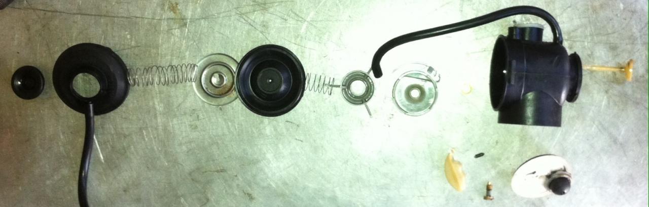

Thanks Norm. I've just put the carby back together with a new diaphragm, primer cap & main jet. I'll let you know once I get it back on the engine how I go. Caleb

Something I forgot, the "C" on the poppet faces the inlet from the float bowl section

I've just re-fitted the carby. However, when I put the earth pin in with the throttle set to half way, it jams everything up. Is this because I am pushing it in too far?
Posts: 8,215
As I said not one of Victas smartest bits of design work, get used to it you will probably have the carby on and off half a dozen times trying to get that sucker to work. Just pull it back out and see if it frees up but I doubt you will get it to work as a kill switch without replacing the rubber, but you have to leave it in there because without it the cam can come around too far and release the cable
