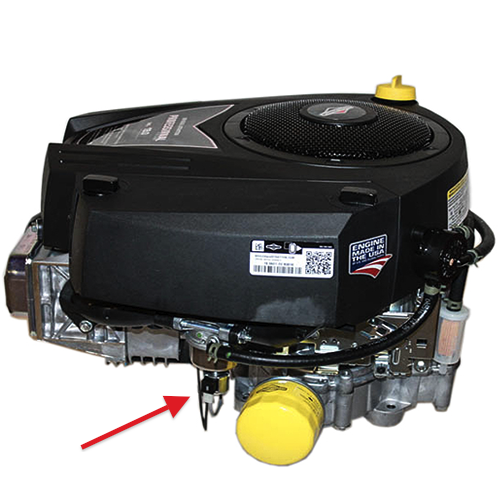

Has the Briggs got a fuel cut solenoid that screws into the bottom of the carby. If it has then check you are getting power to it and that it is working.

As Fixdit said, depending on how old the engine is of course, it should have the solenoid on the bottom of the carby. The solenoid's purpose is to prevent the engine 'running on' after the ignition is turned off.
As Norm also said, the ignition shouldn't be the cause as it uses a magneto.
See the excerpt from the B&S workshop manual below:

If convenient, can you post the engine model, type, & code? It should be etched onto the top of the rocker cover.
The red arrow in the picture below is pointing to the solenoid.
