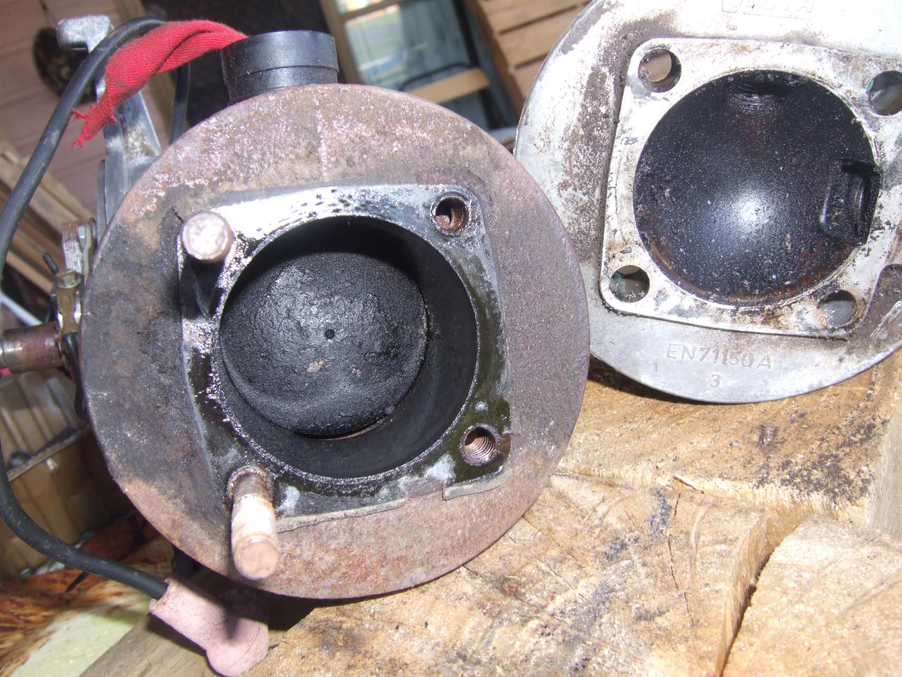

I have little experience in pulling apart the engines like you have. 1. What do you use to de-coke the piston crown and head and is it realy vital to do it at all?
Scrapers [see above], and a small fine wire brush wheel in an electric drill are the handiest tools for this job. Yes it is a necessary task, as if the carbon builds up too much, it can crack off in chunks and cause damage. Pre-ignition can occur from hot carbon, as well - it usually happens when the carbon is thick, and the surface rough.
2. what is a proper method to remove the old gasket without digging into the metal in the process. I recently tried doing it with a used razor blade on an old powertorque and found it a frustrating experience. I ended up resorting to rubbing the head on sand paper mounted on a sheet of glass to remove all traces!
Scraper/s,as mentioned above. BTW, lapping the sealing surface of the head using fairly fine [400-600 grit] wetted wet & dry paper, backed by sheet glass, is an excellent way of ensuring that the surface is flat.

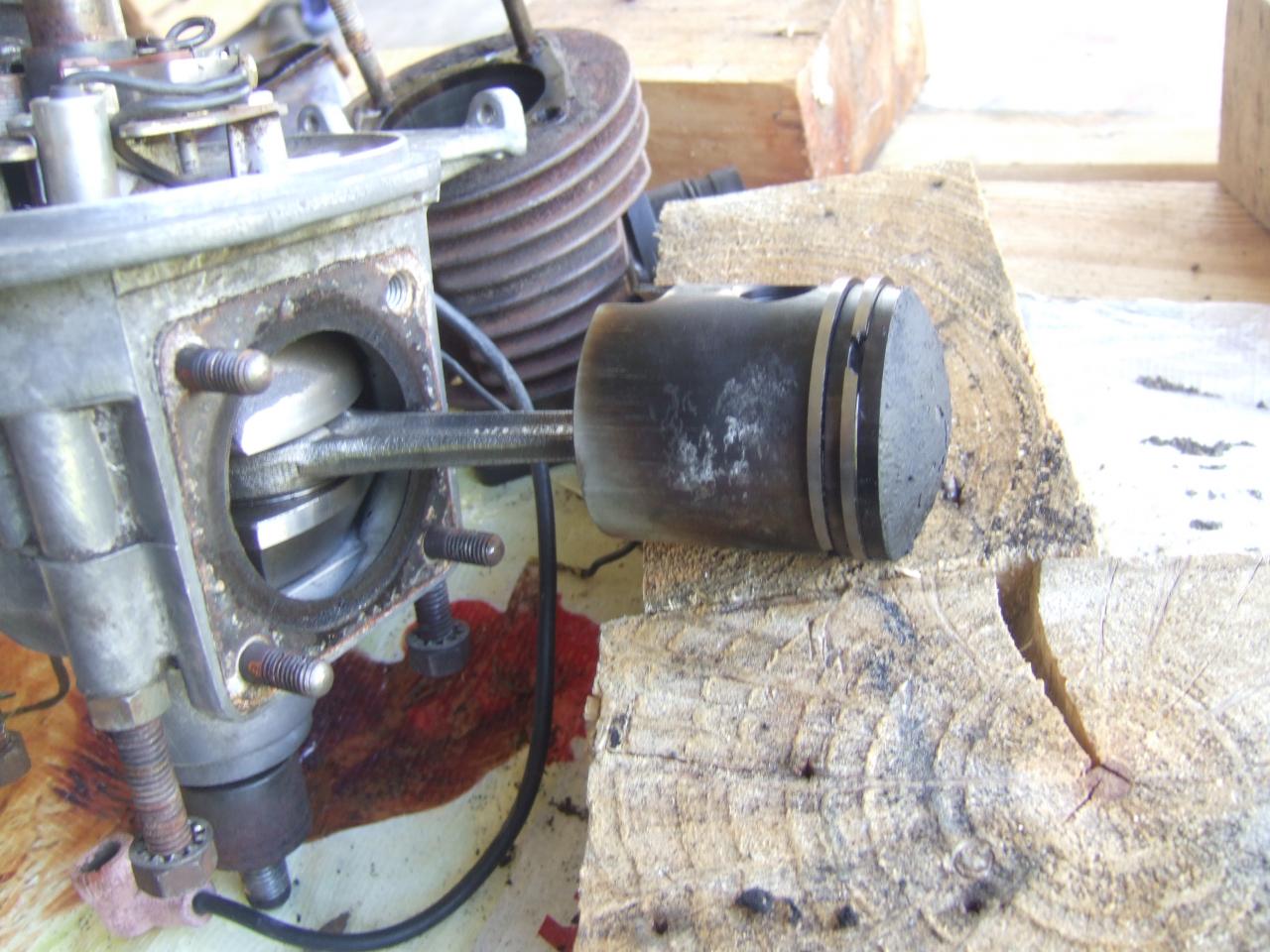

Hello Gadge,
I had a spare set of rings and comparing the two I can easily see how the ones from the mayfair have lost their spring will be putting the new ones in.
speedy

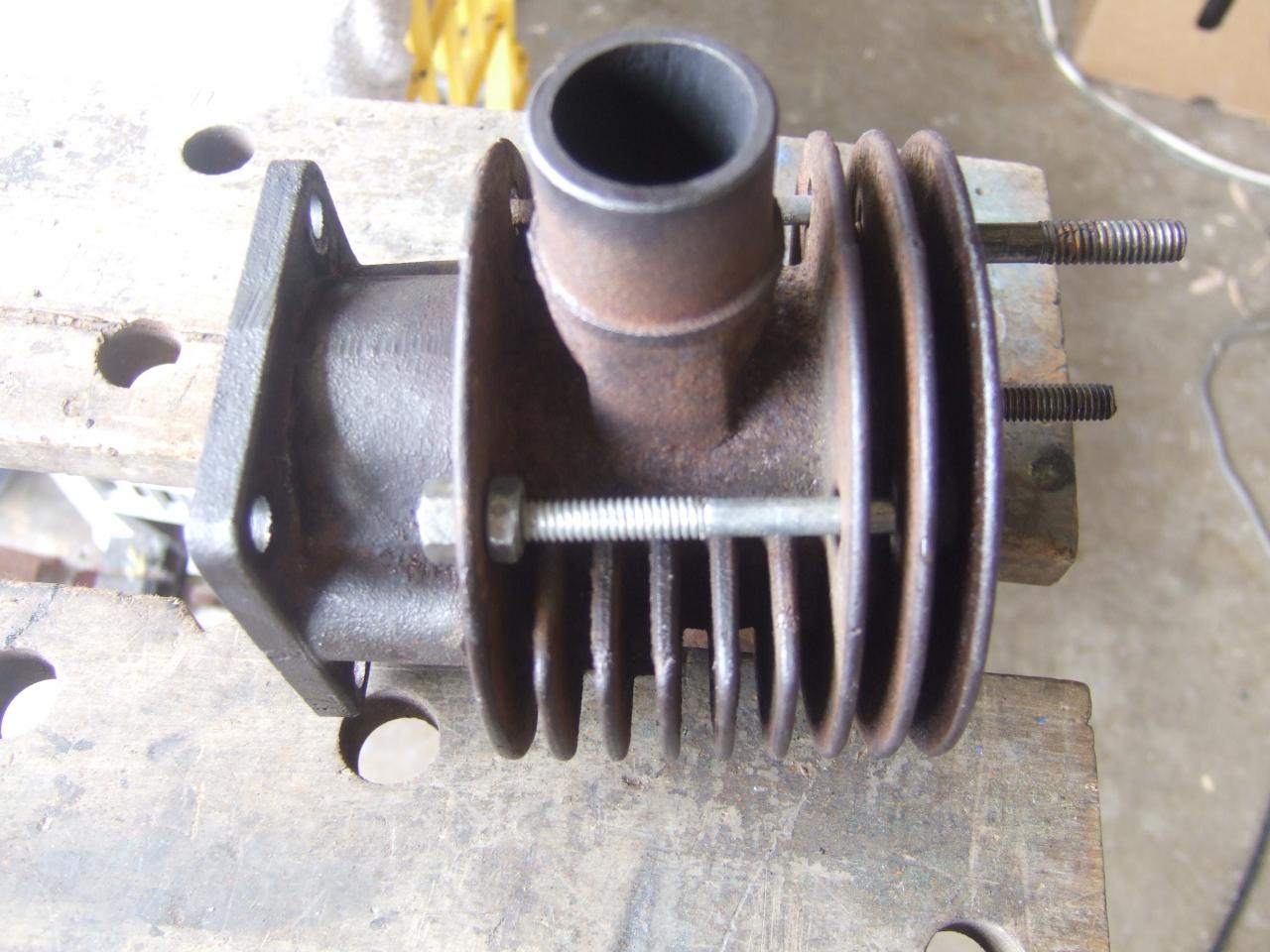

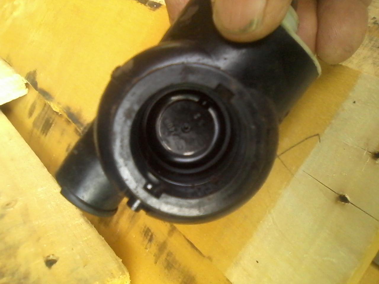

Gwtting things together, rebuilt decompresor, and carby it was missing the small spring between the two things inside...... a new big o ring and looks good.
Tried a repair on the muffle, may save $30 as the warden doesn't like me spending money on my hobbies.....
Buggered a barel gasket as I didn't use two pieces of wood to res piston on.....
Get one tomorrow.

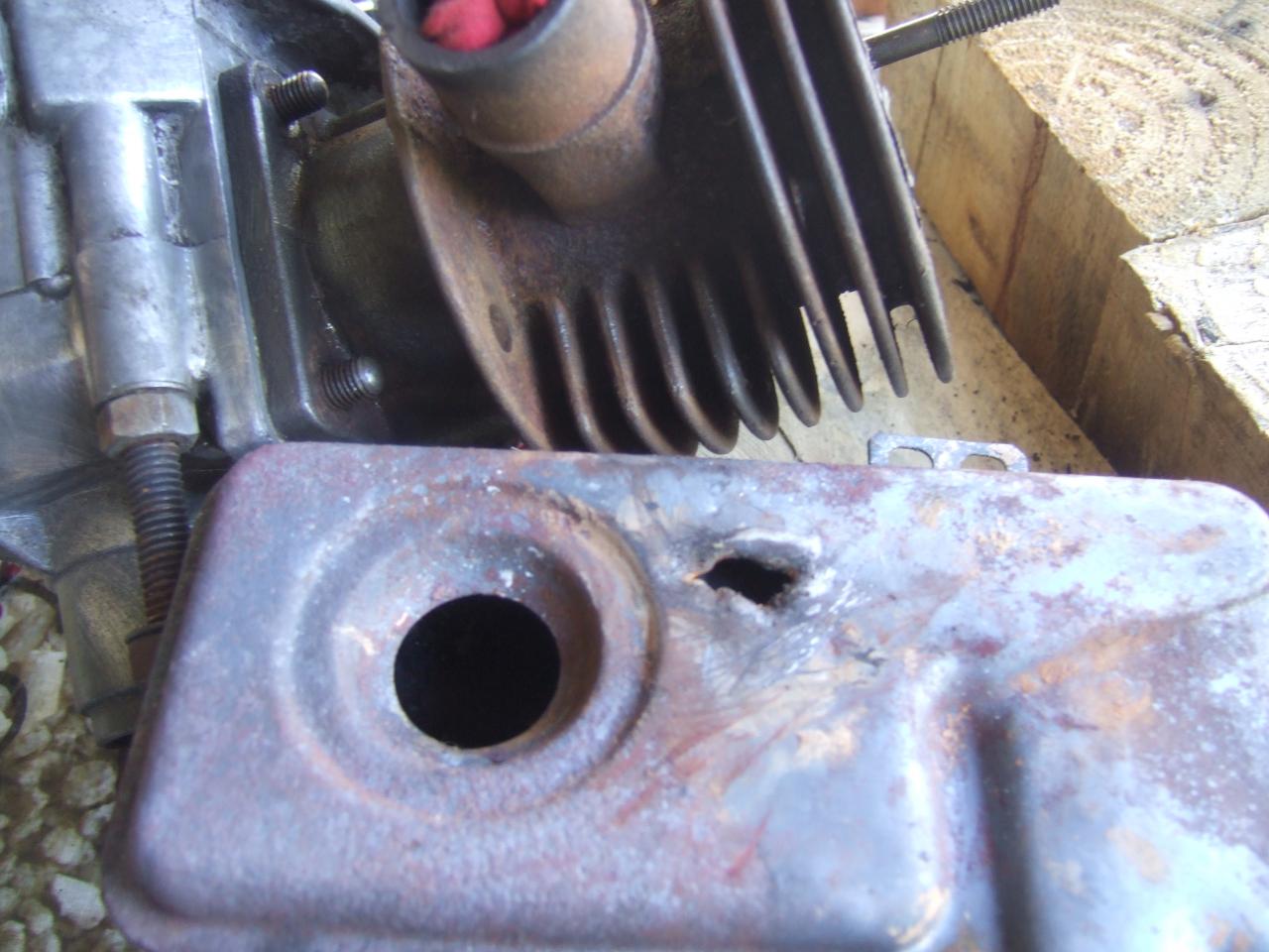

Is that a sealing layer I see under that metal plate? Did it need more stuffing inside? The muffler off my 125 has it missing where the gases shoot in. Is that normal?

It's a piece of head gasket, might help. I didn't fill it with anything, might put a couple of those metel scourers in. You need that gasket where the muffler meets the manifold.

Fixed that missing rod with a cut off bolt.
It's coming together [Linked Image]
speedy

Posts: 8,216
speedy, what is that bolt for?
speedy #80240 20/12/16 06:40 PM
Joined: Feb 2015
Posts: 67
Thatd be where the muffler clips hook onto
speedy #80241 20/12/16 07:24 PM
Posts: 8,216
of course, silly me

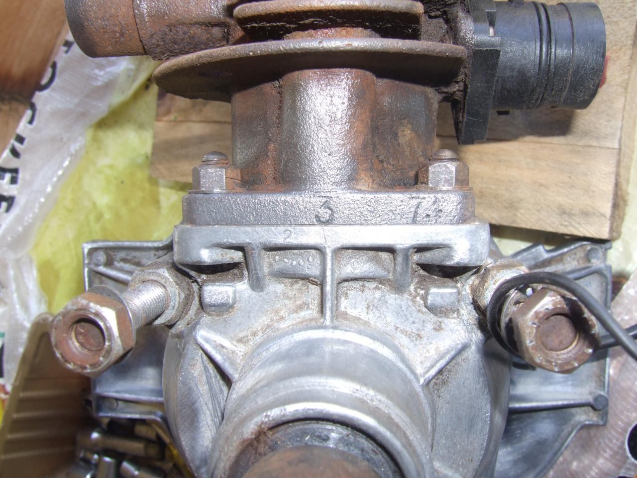

Put it all together, good spark, fresh fuel getting to plug, compression, wouldn't fire.
Tried to check timing 1 eighth inch before top dead centre. See in the pic there is not much adjustment of the plate as the holes are ound , not elongated as I have seen on another 125. Try again today.
Now the pull start doesn't grip so I'm just using the easy starter......

Got the timing right and put an orange needle valve in as the other one was sticking. Runs well......
Only now the easystarter loosened the flywheel nut and it flew off in the grass .......... somewhere, but I'm happy with the engine now.
