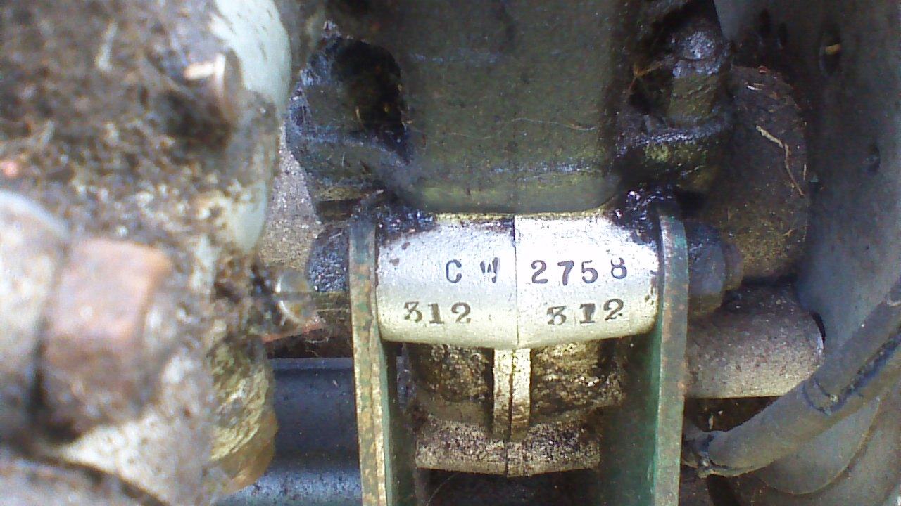

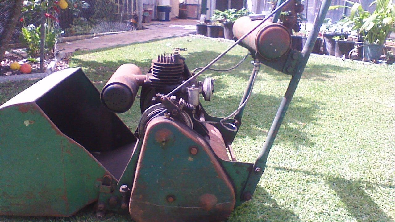

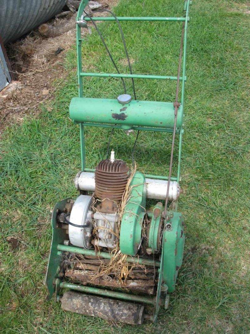

Picked up this Royal Enfield mower today, it is 14" the motor is seized but it is complete except for a spark plug. It needs a lot of work to get it going but if I did not buy it it was possibly headed for the scrap yard. I haven't un-sized a motor to date and any pointers would be very much appreciated. I believe these mowers were made from 1932 to early fifties with a break during the WW2 period if any one can help with a date of manufacture that also would be appreciated.
Last photo is only numbers I can find.

Congratulations, was that on Gumtree ? I saw one on there and wished I lived closer. Nice piece of history you have bought, it does look to be complete. Freeing up the motor depends on how bad it is, I have freed a few but they have been left to sit and surface rust in the top of the bore was the problem. You will have to pull the motor off to have a good go at things, I think the the head and bore would be one piece. You could start with some penetrating oil of some kind down the plug hole and after letting that sit for a while give it a try. If no luck try some gentle heat then cool then more heat and cool.
Hopefully it will free up and the bottom end is ok. Below is an interesting thread that may help in your restoration
https://www.outdoorking.com.au/forum/ubbthreads.php?ubb=showflat&Number=26015&page=1
Hopefully members can add some of there successes regarding freeing up a seized engine.

Thanks guys for all that info am trying the soak method now the piston is at the bottom of its stroke and the fluid runs into the crank through the intake but we will persist for a while. The motor has not run since sometime in the 1960's I an told so it hasn't run for 50 years.

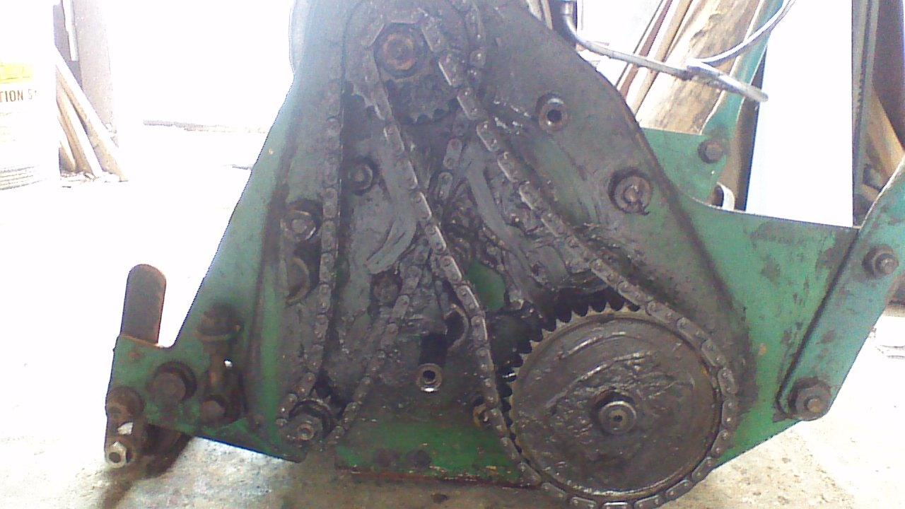

Took the cover off to satisfy your curiosity Jack this is what I found.
Thanks again
If it don't go its not good.
Yep,
that's new information to me.
The later models had all-chain transmission.
The pre-war models had all-gear.
Ridiculously over-engineered for small machines.
I guess the post-war machines had to be made at a cheaper price
in order to have a market. There was stiff competition and I do not
think these machines sold beyond the mid-1950s.

Looks like the motor is different or been turned around too as muffler is under the fuel tank on the one with gear drive. My muffler is at the front.
Thanks Jack
Yes,
I think the motor is still a midget, but RE were playing around
with early forced cooling.
Yours does not appear to have a factory cowl either.

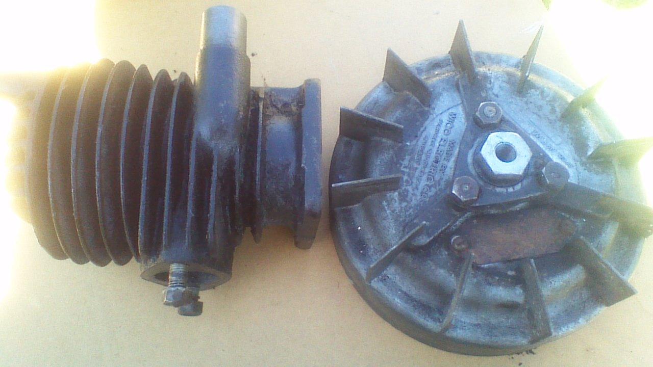

Yes I will take a photo when the motor is back together, it is now un-seized, turns out that it was not the piston that was stuck it was much simpler the backing plate was corroded to the flywheel. Got it loose by running a engraving bit around between the two. Woke up to this when I tried to remove the flywheel and the backing plate started to buckle as the flywheel just started to move. Have removed piston from the cylinder to check both - they are fine and rings are free in the groves, can still just see the cross hatch on the cylinder.
The above photo shows an extra bolt in the crank case mine only has in total four bolts in it. I will get some photos of the motor in bits tomorrow when light is better and its not raining.

Hi exfarmer
Yep, more photos for the record would be appreciated.
It is great news that the engine is not seized.
That your machine only has 4 crankcase bolts does not suggest a Midget.
I wonder if this is Royal Enfield's own engine?

The engine has bore of 1 7/8" (haven't worked out the stroke)
The backing plate for the magneto has SPEC No FW and can't read the other no's then under that serial 167498. The flywheel has SPEC No FW 1 39. Both have Wi [Linked Image]
co Electric Co on several places. Carburettor has AMAL LTD.
As you may be able to see the cowl has baffle in it to direct air flow I think you may be right that the motor is one of Royal Enfield's own.

Hi exfarmer
Great photos!
I have discovered that the RE Club has a dating service.
I better clarify that ... they have factory records...
The magneto - Wico - looks the same as Victa used.
This suggests to me this is a RE engine using some outside ancillaries-
Wico and Amal. [I do believe, now, this is not a Villiers engine].

Yep according to the RE sight they made all of their mowers after the war with their own 98cc motor. Hopefully tomorrow I will find out if its got spark after adjusting the clearance on the magnets and setting points. The piston is back in the cylinder and a new gasket between cylinder and crank case and it has compression------- so far so good.

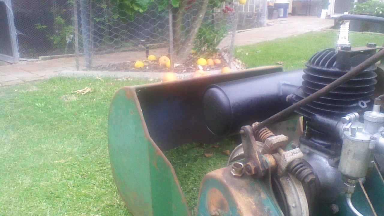

A haze of exhaust smoke and grass in the catcher First time in 50 years!!!!!! Yes it runs, clutch slipping needs sharpening and bearings, needs paint and decals but motor is fine now.
Thanks for the info and help it is appreciated. Will post photos when all the work is done which will take much longer than sorting the motor.

Easy fix ! Well done, good feeling when you get an engine going after years of sitting idle. Any chance of a video ?
Hello exfarmer & Paul C
What a great result - and after so long!
It is rewarding when these old mowers are given a new lease
of life. These machines were the best of British.
Thanks for saving this one.
