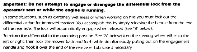

Put the dif lock on in the wet , now it refuses to go back in any tricks to unlock it I assumed you just push it in and put the clip back over.thanks

Buckets
Regards
Buckets

Thanks Buckets, it works ! regards Turnout
