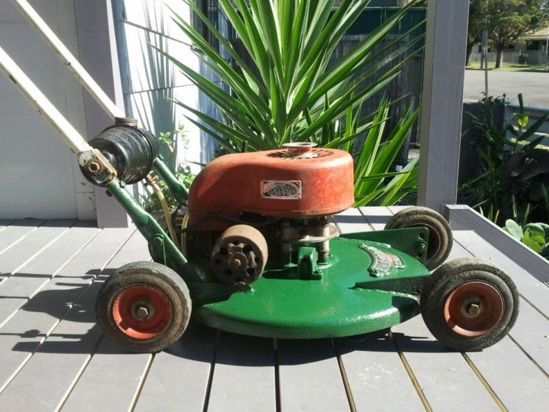

A Champion Senior lawnmower appeared at auction in October, 2016.
Advertised as a 'Collectible mower', the description told a remarkable story:-
DESCRIPTION
"This refurbished Champion Senior mower circa 1950s was a prototype intended
to have a foot pedal rope start. The disc was adapted to take a spring arrange-
ment and the Villiers engine (with a solid polished bronze flywheel) was raised
on stainless spacers to accommodate a curious rope system via a deck mounted
pulley (see pic). The system never worked and the project was dropped. The
unit was then sold as a factory second and was used as a conventional mower until
around 2000. It is believed to be the only prototype of the project ever made."
The accompanying photos showed three of the four special features, a base-
mounted pulley on the LH side, a crankcase raised by spacers, and a foldable
handle. The fourth feature, a 'special' blade holder was not included in the
auction photos.
When I saw these pictures I immediately recognised the significance.
Another machine with similar features had been advertised back in 2012!
If the mowers were not one and the same, then this indicated something far from
that of a a prototype ... that never went into production. This was a production machine
... but missing 'things'.
I know something else from research conducted years' ago - Champion made a
Senior Kick-Start model from late 1957. Definitely a production model, but none
have been recorded intact - in a complete configuration.

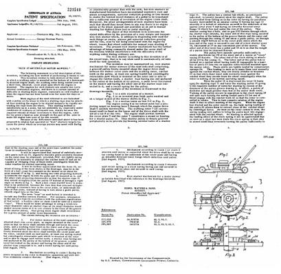

PART THREE - PATENT
In the 1950s kick starts were used on many Australian and imported reel mowers.
The advantages of kick start systems were taken up by a few Australian rotary
mower makers. Here I specifically refer to the Austral-Villiers Apatamatic,
the Scott Bonnar Model 22 Spincut and the small Atom Mofast.
These designs were complex (Adaptamatic) and awkward (Spincut). A more
elegant solution was patented by Champion Mowers - one that did not involve
ratchets, racks and segments, etc., acting on the flywheel. Instead, a clever
system acting on the blade holder disc engaged the spring mechanism located
directly above it. This was energised by a kick pedal located at the rear.
The patent was written in broad terms to accommodate a side-mounted pulley as
seen on the auction machines.
It was an exciting discovery ... to find Patent 30118, lodged in August, 1957.
The patent explained the function of the pulley I saw in the auction pictures.
The reading of the patent explained much more ...
CHAMPION - KICK-START PATENT - c1957
Likes: 304
