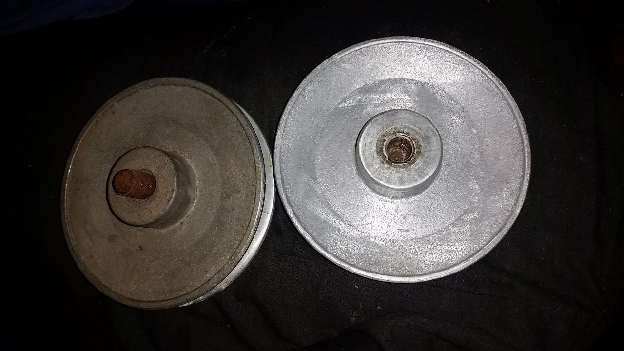

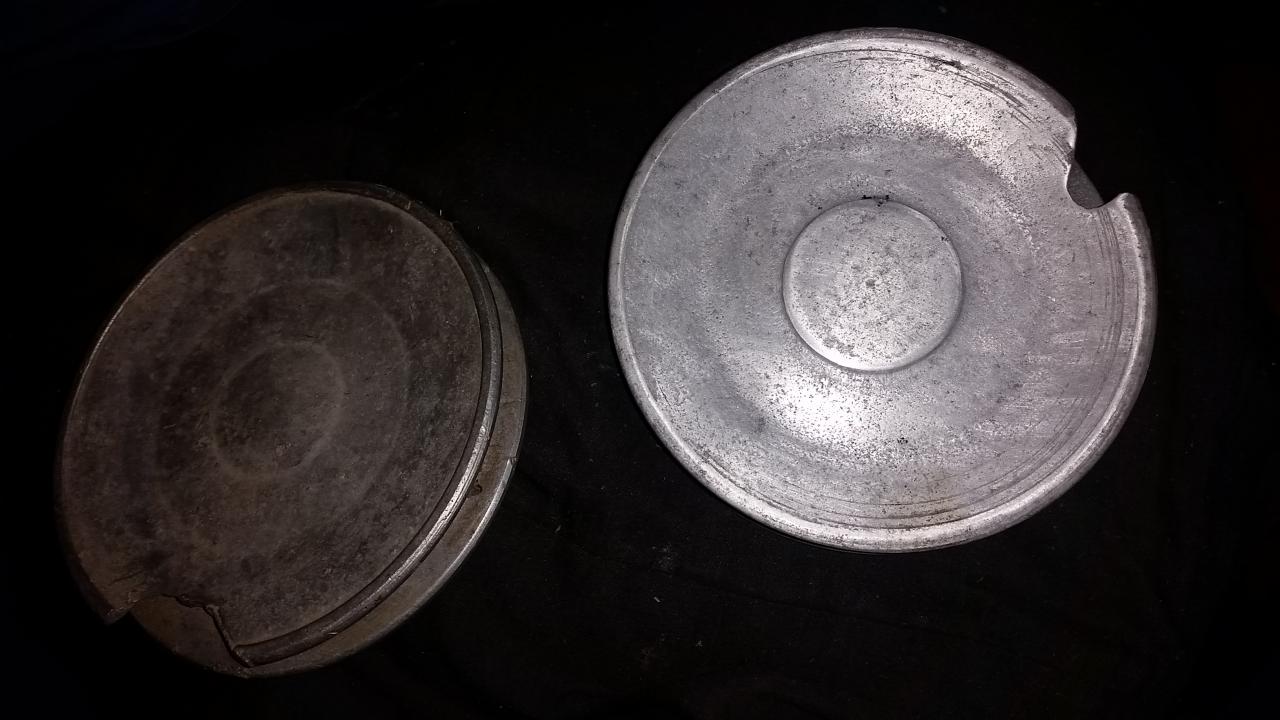

can someone tell me why are these different [Linked Image]
Just different castings.Most likely different manufactures.
Joined: Aug 2016
Posts: 15
i thought that they might of come off a different models thank for the advice cheers2
They all came out around the same time which I believe was during the model era.As far as I know there really isn't any specific model to each style.
