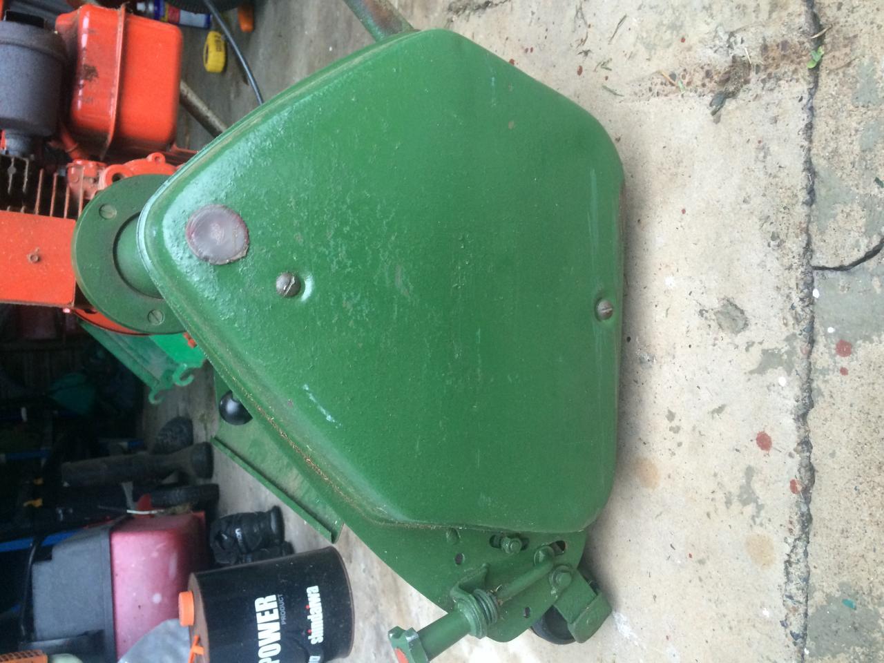

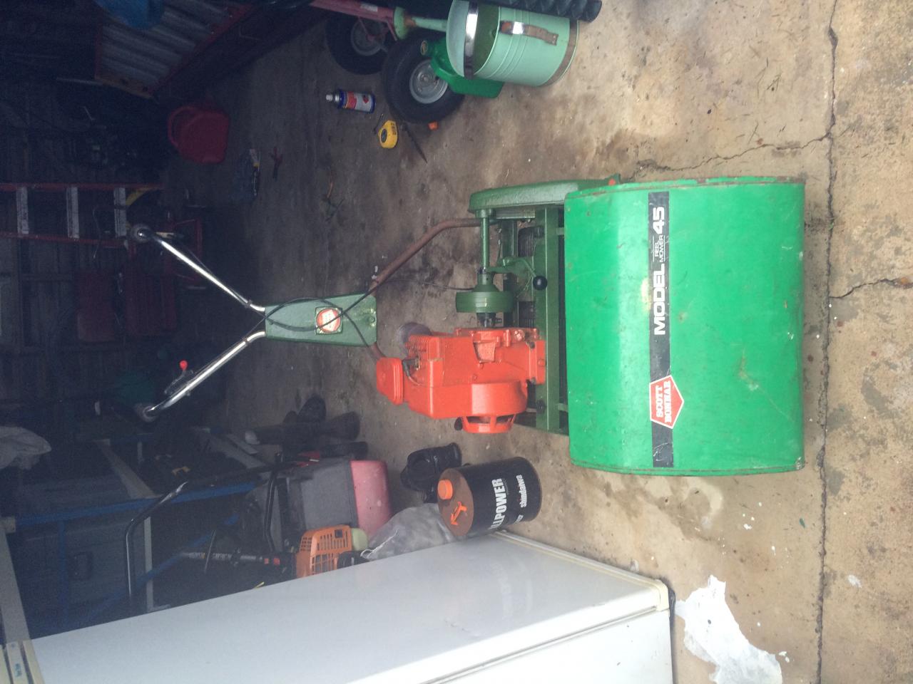

[Linked Image]a
some assorted pics of the beast before i started to dismantle.

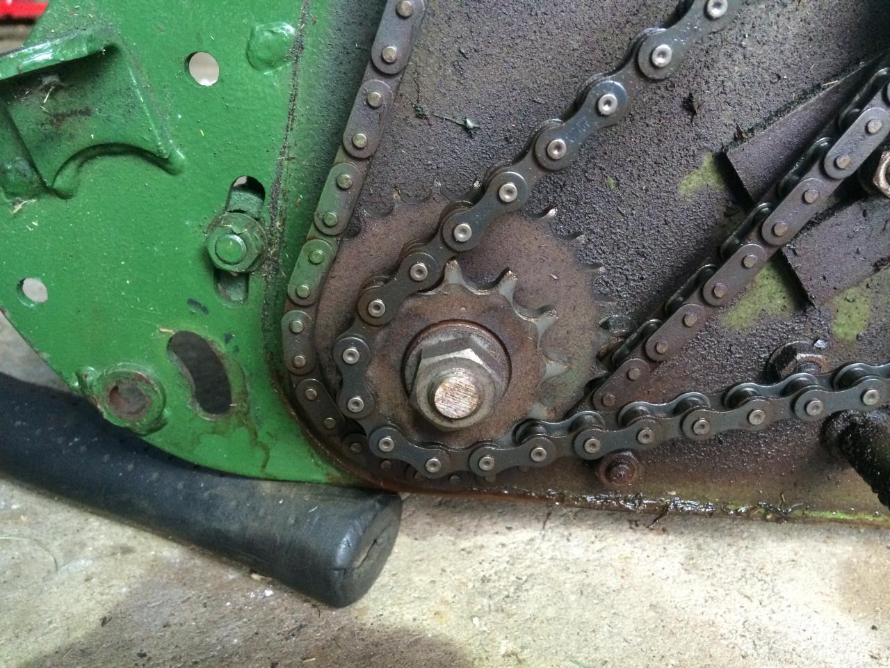

Do these pictures help to identify the mower? The cogs and chain look to be in good condition. The reel adjusters need to be tapped with a hammer lightly to take up the slack when adjuster nut is backed off and the screw is wound to move reel closer to the bed knife. The mower worked well on mowing the yard, however I have a Buffalo lawn. I was advised by a local mower shop that the 45 would be perfect for my Buffalo grass. I have since found that i need to raise the cutting height above the standard SB 45 to maintain healthy grass. an increase of 10 to 20 mm is required. I can increase the length of the slotted adjuster or increase the diameter of the front roller to eek out some height. any other suggestions?

16th of September 1980 is the date of manufacture of the engine, add another 5 months (due to Xmas break) and you'd be pretty well around the mark of the mowers birthdate (Feb 1981). There is no way of dating it exactly, but there are various items which give us more of an idea. Now looking inside the drive train area we can see that it was originally painted in "Apple Green" which I already knew because of the throttle assembly and the style of SB stickers that are on it.
Now as far as cutting it higher and butchering the mower in the process, this is absurd. My father in law had buffalo as did many people that planted there lawns in the 1930's onwards. Buffalo is nothing new and he cut his massively large lawn with a Model 45 for 25 years or even more I think.
One thing that will have to be evaluated is the PTO shaft on the engine after you remove that butchered clutch half which will require replacing as a high priority. Leaving it like it is will only inflict more damage if it hasn't already done so to the chassis rails due to running unbalanced and inducing stress fractures.
As far as tapping the adjuster set screws is concerned, that's a no no. If you undo the the two bearing carrier bolts very lightly, you'll find you won't have to use a hammer at all. Honestly it's a tool that's rarely used in my repertoire of engineering. The locking nuts only have to be undone a tiny tad so as to reduce the play that you'll induce into the process. All you need to do is adjust it correctly then do up the two carrier nuts nice and tightly, then check the reel to bed knife contact and if satisfactory then just nip up the lock nuts on the set screws and you're done.
All I will say is your lawn is way too thatchy and needs to be cut right back to a base level and allow it to re-grow. Then set the height you desire and you'll be right. There's no need to modify the mower in any way, just the actual lawn.

Thank you I'll start getting parts list together. The adjuster lock nuts and screws were seized and would not budge for 3 days with WD40 and gentle back and forward action to get them moving. I had not intended to use a hammer as a routine course of action but to see if when the adjuster was backed off the reel would move closer to the blade as it was fixed in place and not moving with the adjuster backed off. I will adjust the bearing carrier bolts. On reassembly i will replace the adjusters and all bearings. Thank you for giving me an indication of the vintage of the mower. I had thought it would be older but a hard life ages everything. Since the initial mow on the purchase day and the discovery of the clutch damage the mower has been out of service. Pending investigations into repair costs ect. mower height of 30 to 50mm are recommended for buffalo grass leaning toward the upper end. My lawn is not old enough to be heavily thatched and in manny places was showing dirt after being mown on the highest setting with the SB. Being in much better condition will alter the cutting action and performance of the mower. However short Sir Walter in hot Queensland weather will soon burn off.
