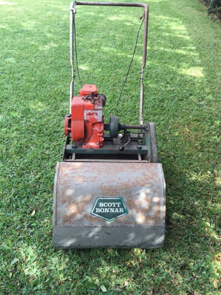

Hi guys,
I've lurked in the shadows for a while and the way you all share information has given me the courage to start a project of my own - I'm going to attempt to restore 2 Scott Bonnar 45 mowers.
I was just going to buy one and then I found another one with the same model number, so I have the intention of having a crack at one first and then gifting it (if successful) to my dad for Christmas. He shares in my love of all things lawn/mowers. Once I've got some experience with that one, I'll try to restore the second one for myself. Mower #1 won't kick over because it hasn't been started in a year or so...so that's going to be my first job - getting it running.
The catch? I'm a 30 year old female and I don't have any experience taking on this sort of a project, so I would really appreciate your advice and support as I try to tackle this.

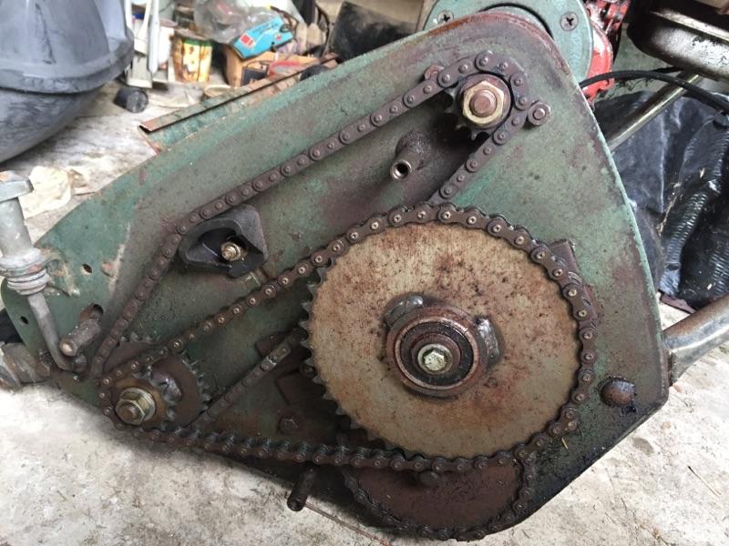

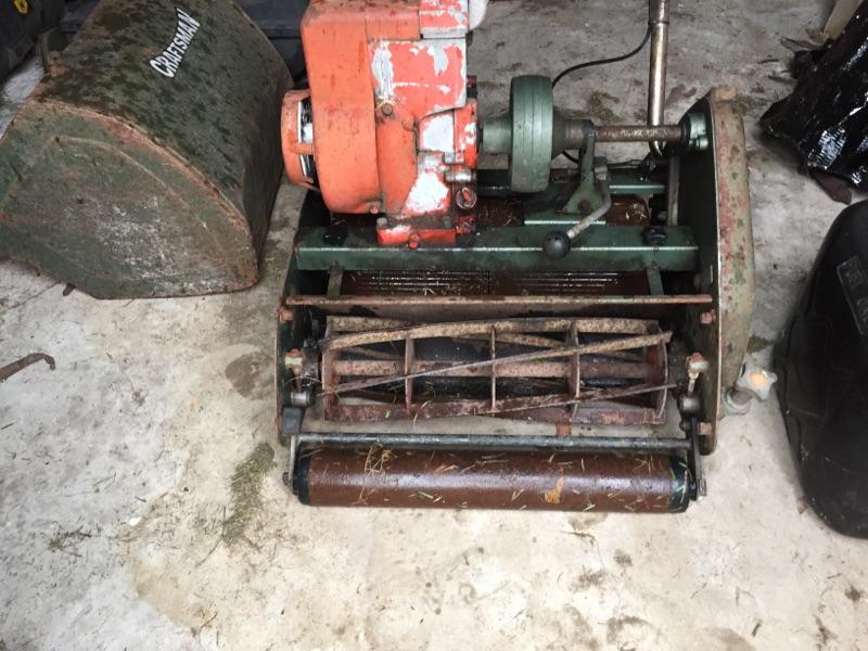

Mower #1:
I pick up mower #2 on Saturday:
It is in working order, but I won't touch it until the other is complete.
Hi emk3,
Wow, now that's an eager projected project. BTW welcome to the ODK Forum.
Well you're certainly going to have your hands full taking on two.
What you have there is special run of mowers called the "Craftsman" which is basically the same as a "Lawn King" model 45 but finished in Green opposed to Pacific Blue. These had the slightly lower powered engine than the normal "Scott Bonnar" issued machine and also the "Pram" handlebar which is somewhat different to maneuver compared to the standard winged bar assembly, all in all it's just a matter of getting used to that different arrangement.
When you say the mower won't kick over, are you referring to the piston will not travel up and down in the bore or that it just won't start ?

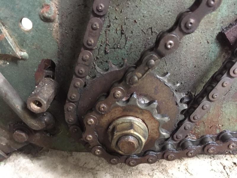

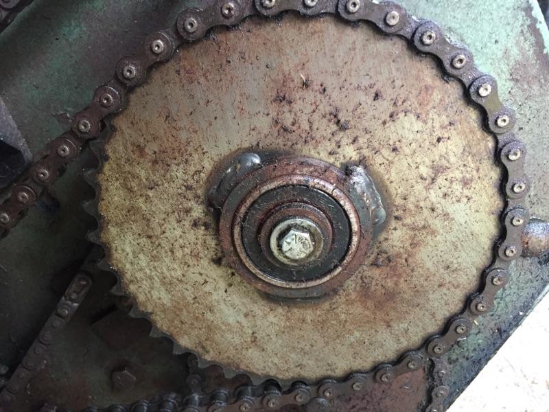

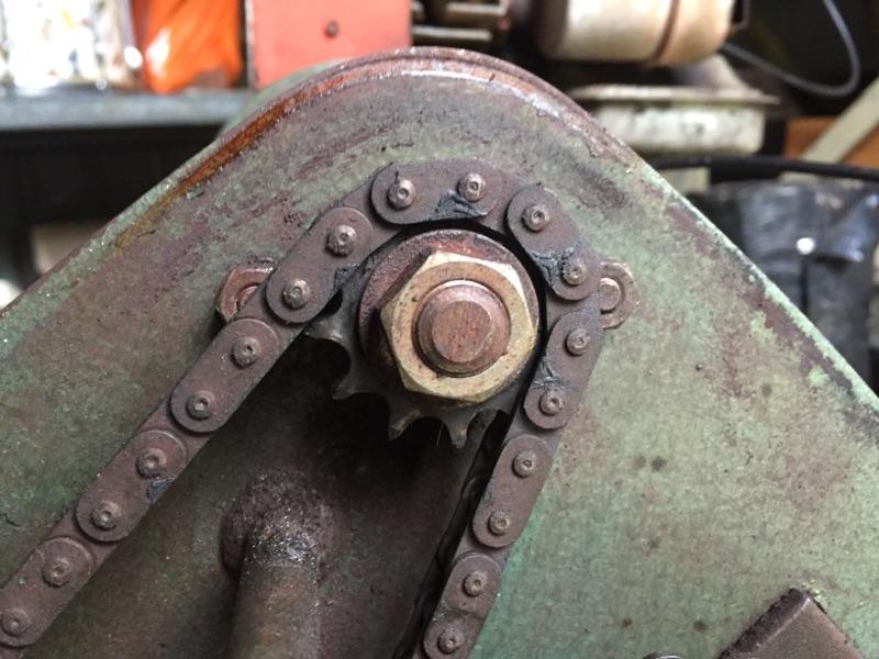

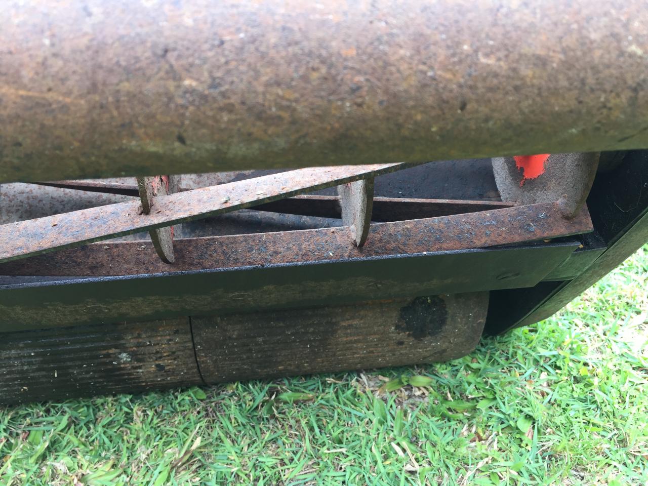

What are your thoughts on the reel, chain and sprockets? Can I get by with the originals, or do you think I may need to replace some of these parts? Once I get it going, I'll start taking it apart and degreasing everything and start the prep for painting/reassembly.

As far as the sprockets etc. are concerned it looks as if the main powertrain chain and sprockets have seen better days. This is the one coming from the top small sprocket on the PTO (power take off) shaft. The other one being the land roll clutch chain looks not to be in too badder condition. Lets put it this way, I've seen much worse and yours will carry one for a few years yet. Cost is a major factor when deciding how far worn an item is as it's going to inflict pain into the hip pocket.
One thing I would check very thoroughly and that is any signs of rail fatigue around the inner engine mounting bolts. I can't see properly in your photos but it seems there might be some signs there. Can you please give me a close up photo of the two rail mounting points which are on the inner side of the engine and not the outer ones which are nearer the side plate of the chassis.

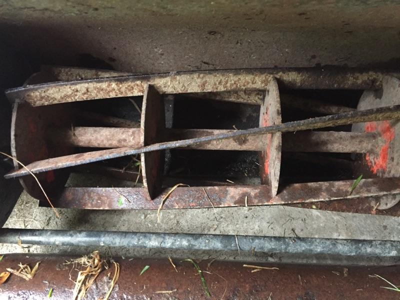

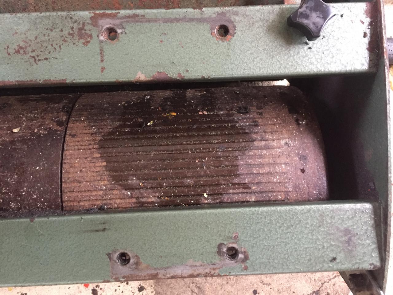

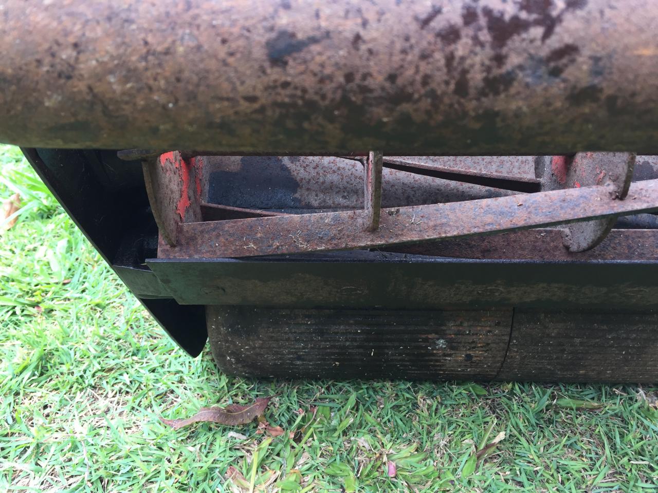

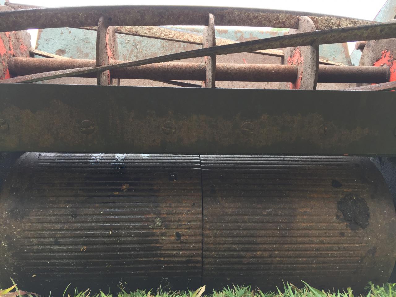

You'll reel has plenty of life left on it as far as a regrind is concerned but I'd say the bed knife will require replacement. If you could tilt the mower back on it's handlebar and take a couple of close up shots of the leading edge of the bed knife so that I can assess it and advise you best.

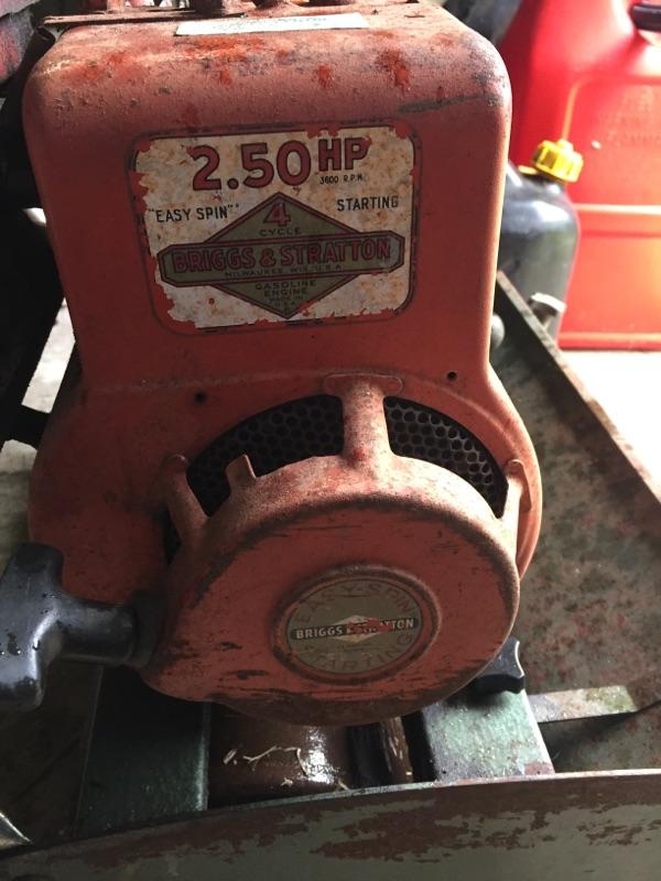

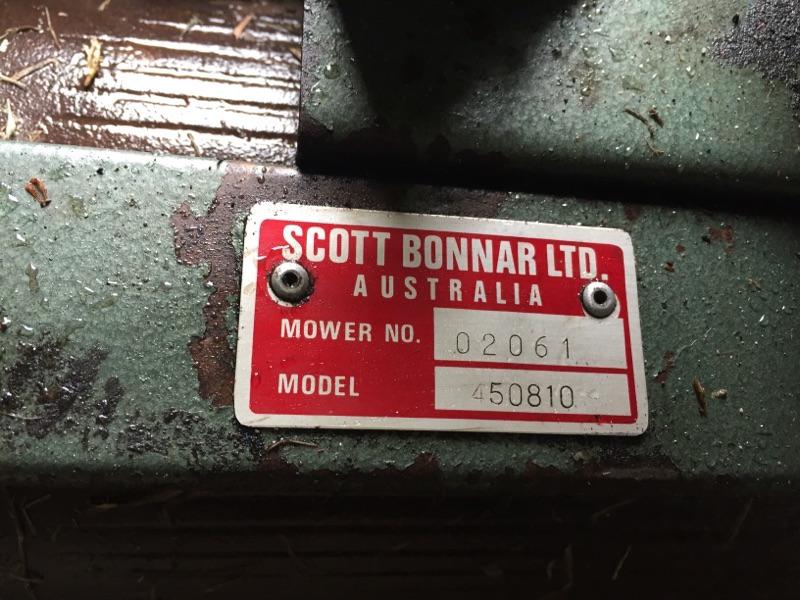

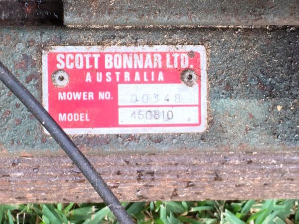

Update - I've just cleaned it up enough to read the numbers stamped on the motor:
80 102 0233-01 77042201
Engine was produced on the 22nd of May 1977 which tells me either the engine has been changed at some point or the Air cowling has been substituted due to the starter assembly failing.
The colour of the machine tells me it was built prior to the end of 1976 when SB changed it's colour scheme from Alpine Green to Apple Green.
Hi,
I'm no expert on engine model numbers etc but I THINK you mean April? (Unless I'm reading the wrong part of the number?) I only say because I can never remember on a briggs what numbers mean what.
Thanks,
Pete.

Yes it should've read April and I should've known better as my birthday is in May, how many times have I written the 5th. and not the 4th. ???

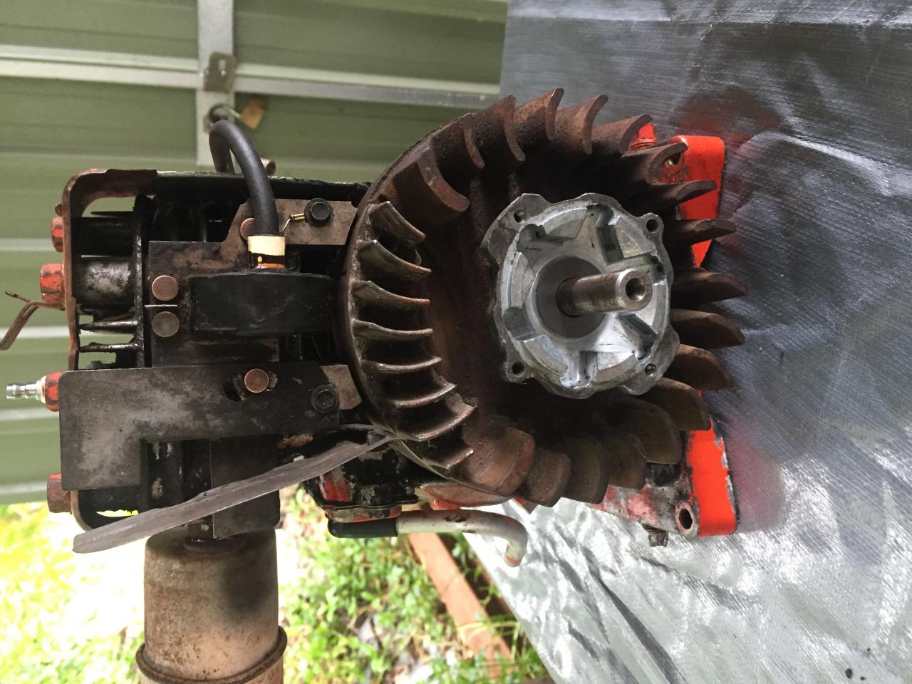

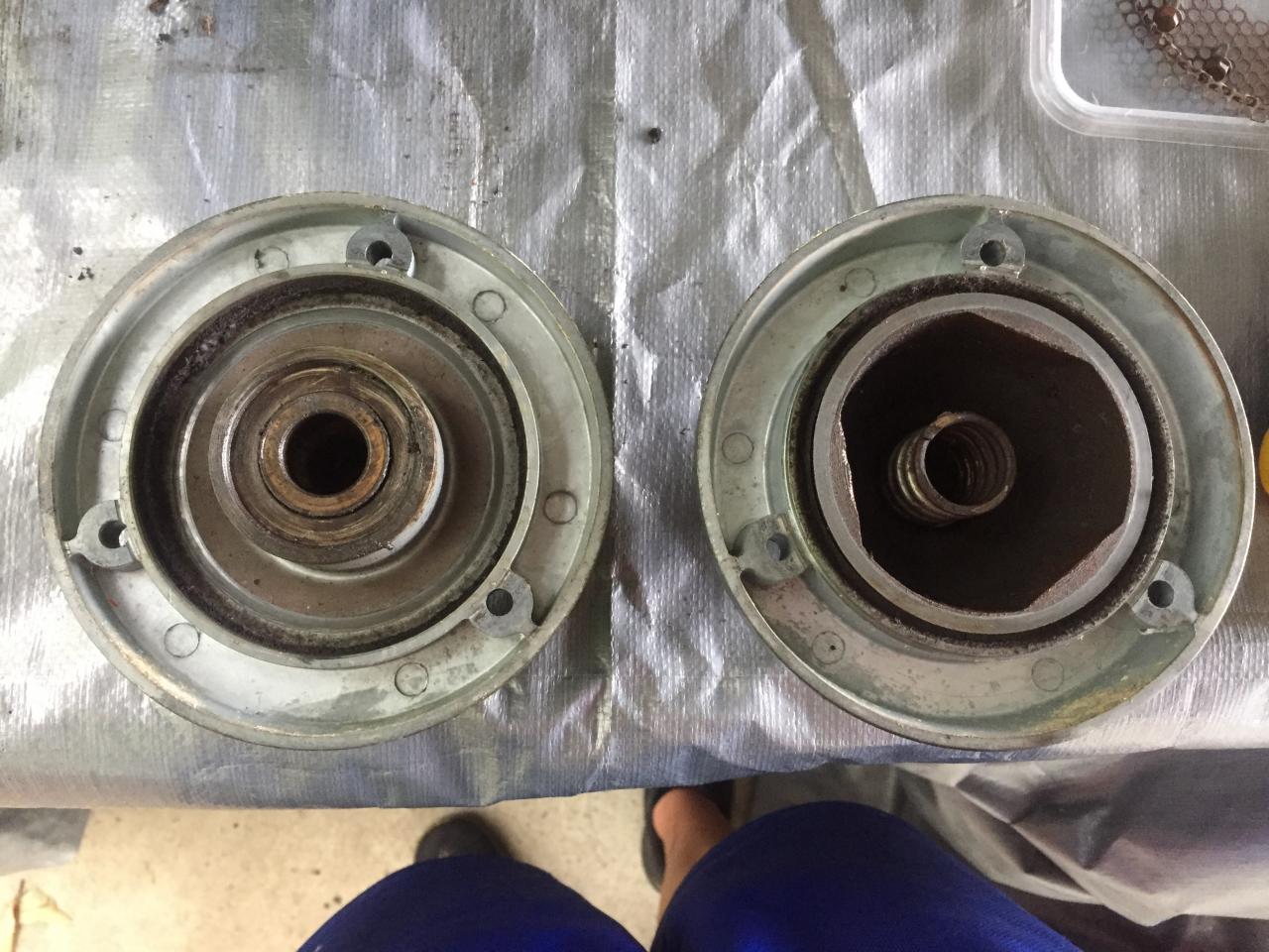

A few more photos of parts of the engine, clutch, engine mounts and also the bed knife..
Please leave your advice.
I'm also thinking of just changing to electronic ignition as I might end up saving myself some time in the long run with trying to figure out the spark issue...Is anyone able to point me in the right direction in terms of parts that are cheap/2nd hand?
Hi all,
Your mower's chassis is good with no signs of stress fractures, something which is so common on the Series II Model 45.
I have to agree with member "vccom's" comment regarding the checking of the points which are behind the flywheel. Many times these get stuck in conjunction with the plunger which operates them from the crankshaft, thus no spark. The system is reasonably goof proof.
Your reel will go a few more sharpenings but I feel your bed knife won't go another round, especially in the centre area, thus a new one will be required.
Don't attempt to undo the screws securing it to the sole plate as you should just take out the whole sole plate assembly and take it along with your reel to the engineer of your choice. Being that you are in Queensland please don't ask me who to take it to as I don't know anyone in that neck of the woods so to speak.
