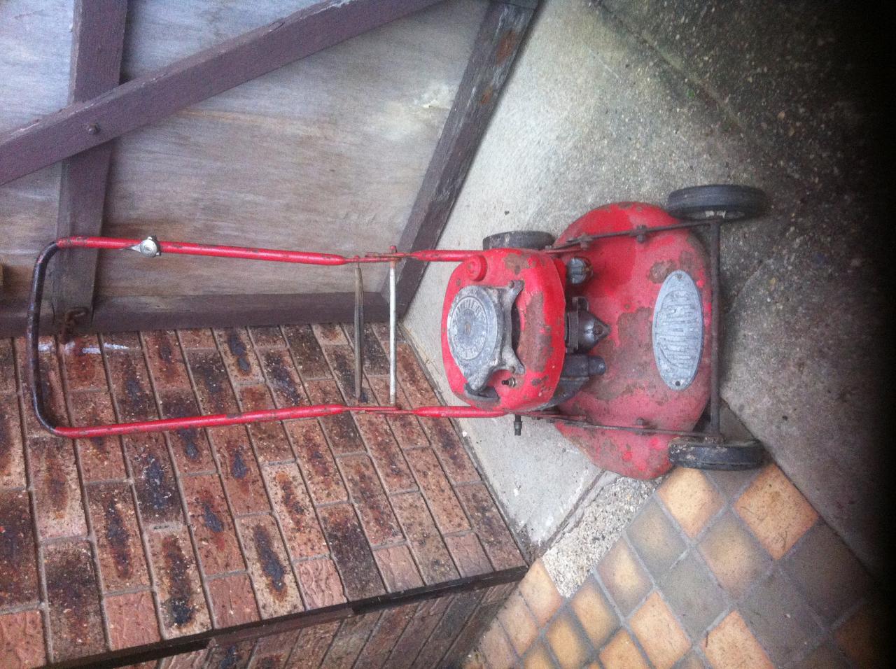

First is the mower in full view

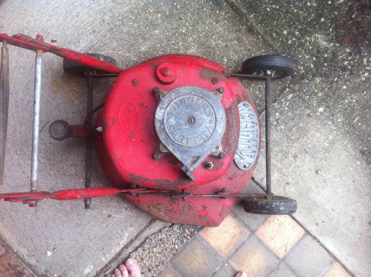

A look from above the engine showing Villiers imprinted on starter, cowling and Villager on base.

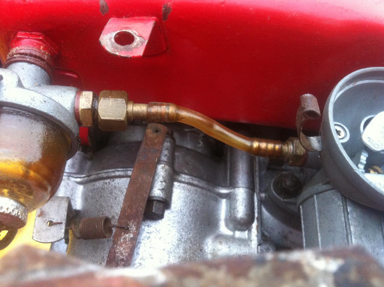

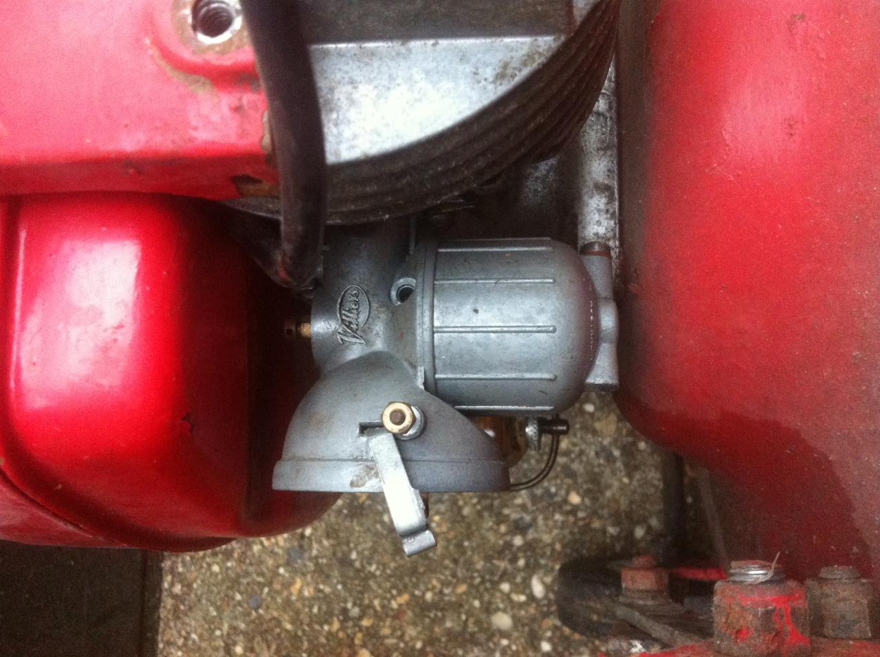

There is no throttle cable connection on top of the carbie and the air cleaner is missing. Owner thinks he may still have the air cleaner, but not sure.

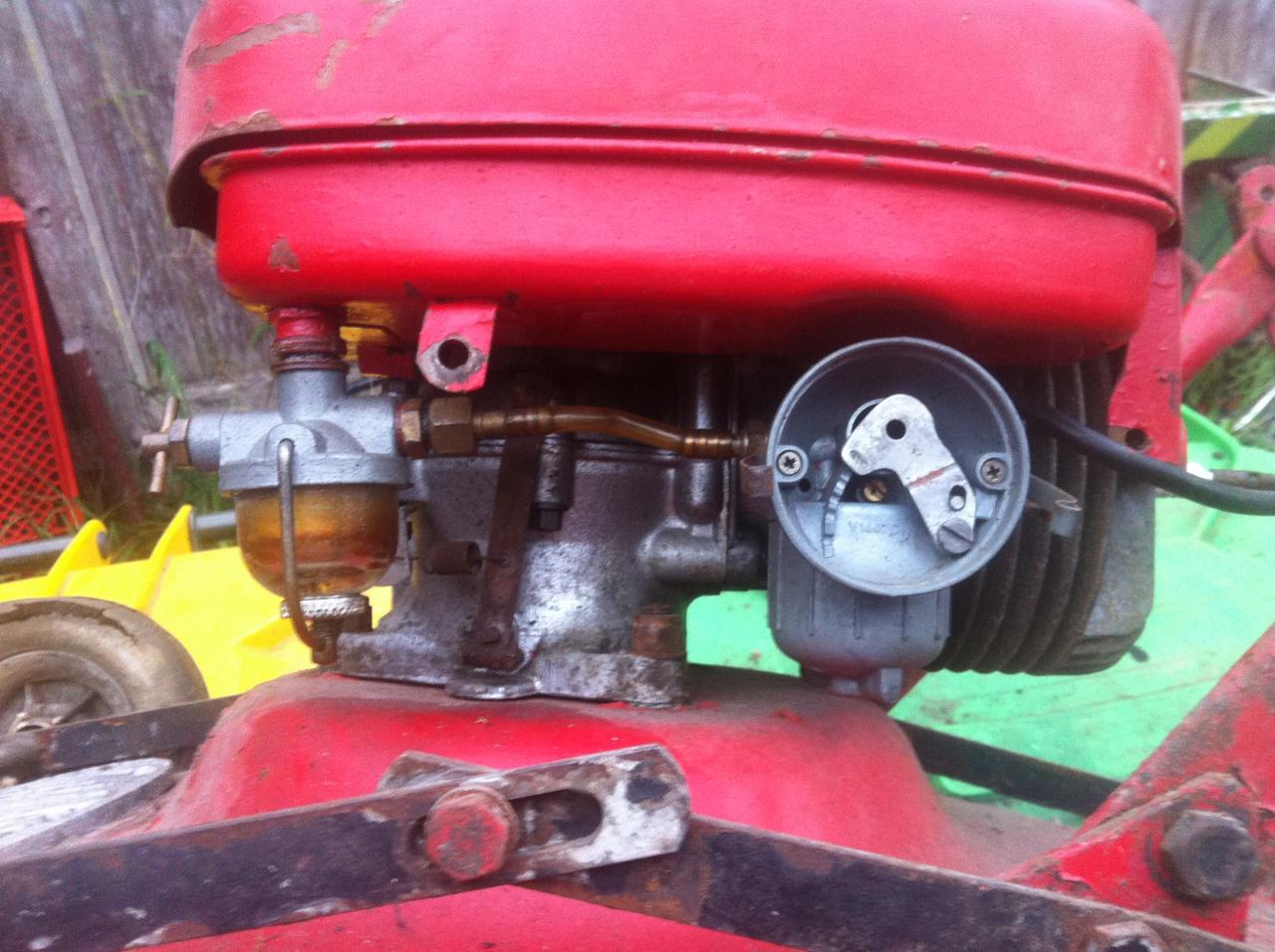

Side view showing glass fuel bowl to carburetor. I gather the air cleaner bolts to the tag just right of the fuel bowl. Inside carburettor is stamped V1447C
I am guessing the lever in the background is auto-speed control. If so, there should be a wire linked to the carburetor. If this is correct, that may explain why there is no throttle cable, but unsure. Maybe a bit of wire, such as a good piece of throttle cable, can be bent to length for it to work.
Front view of engine. Points located at front of motor under clipped cover. Engine stamped 477X 102065 on block below the points box.

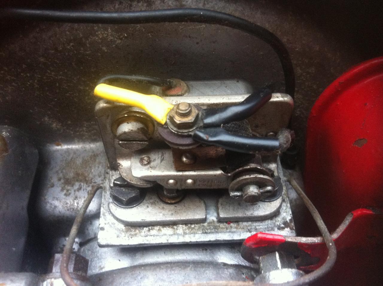

Photo of points. When checking for spark, we also checked points, but they didn't seem to be moving.

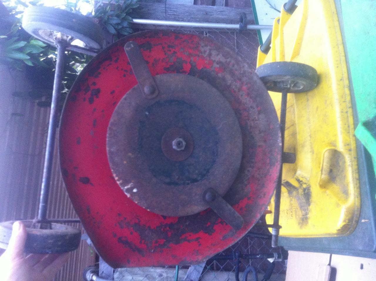

Just an shot of under body. Blades will need replacing if I can get the engine running and any missing parts that may be required.

Looks like an auto, make up a throttle linkage for the lever. I will find you some info on the settings for the points and plug type, remove the points and check that the small rod that actuated the points is free. Don't lose the rod as it might fall out, check the on off switch on the top cowl is working as well.

For the missing link from the governor to the carbie, I used a piece of B&S throttle cable and, before I read your post, by chance and a guess, had made it so it was linked in the full open position. Also cut the spring back a little as it seemed too loose for full throttle position.
Carbie and fuel bowl have been cleaned, but needs gaskets (missing) for the glass bowl and for thread to fuel tank due to leaks.
Rotated motor and can feel the points moving, so haven't touched them yet.
