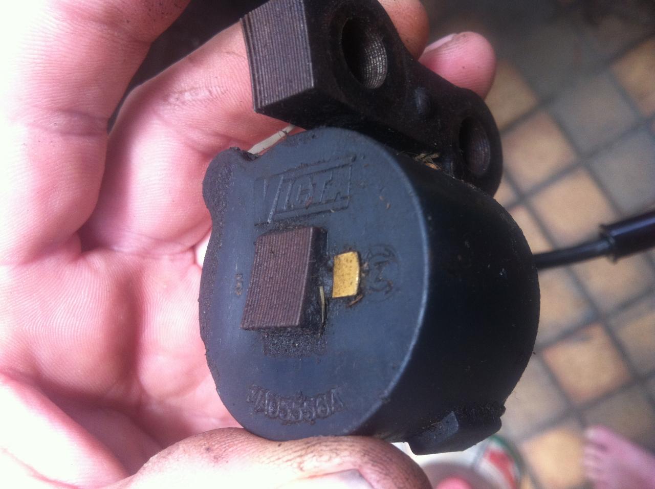

I'm currently trying to get a Victa Powertorque 160cc engine running (possibly a VS160 series 400 or Series 500 2-stroke) and, due to spark issues stemming from a missing spark plug end and boot, I have swapped out the old MA05556A coil with a MA005599A coil from another powertorque motor (obviously and older motor, but still an all-in-one block engine).
The replacement coil I installed was recovered from a seized engine I had picked up in our local bulky goods throw-out and is slightly different to the original, but I now have spark and the engine is running with this MA05599A coil.
The issue I now have is that I can't seem to get the throttle cut-out to work. I'm not sure if this relates to a compatibility issue with the coil, the Ignition Module, Condensor (maybe) or some other connection. I'll have another look in the morning at the cut-out assembly on the carbie, but I didn't touch connections at the ignition module end of the ignition system.
I have attached a photo of the old coil, but the replacement is already installed on the mower, so I am hoping someone may have an idea of any difference between the two coils that may affect proper operation of the mower.
The original coil appears to have a capacitor, or some other electrical component, built-in to coil itself.
Other differences where: -
. The original mounting bolt heads for the coil MA05556A were 11mm compared to 12mm on the MA05599A and smaller in thickness.
. Length the metal contacts protruded through the coil MA05556A are less than replacement MA05599A, but it fitted okay and gapped using a business card.
. Original wiring to the ignition module for this mower was utilised as the wiring from the replacement coil had already been removed.
I tried to use a screw-in type replacement spark plug boot (the orange one shown in the photo), but it didn't want to work. This was the second of this type I tried but, for some unknown reason, both failed to get spark through to the plug, yet there was definitely spark at the end of the lead. Trust me, I can guarantee power was getting to this point. :-)
Thanking you in advance.
Daryl

I have provided some more photos of the existing coil and the mower in question.
Rear of coil MA05556A only has two connections, same as MA05599A
Not sure what the brass tab is, but the protrusion of the metal contact out of the coil is small compared to the MA05599A version.

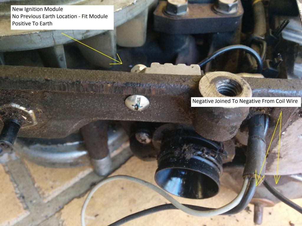

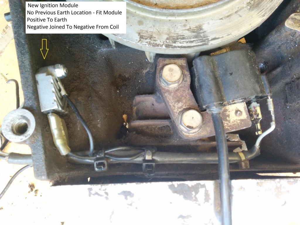

New to this forum and this topic is of interest as I have an older Victa with a failed MA05599A9 (built in ignition model).
After removing the coil I now have an after market coil and separate ignition, however after wiring it up as per instructions I still have no spark.
Any ideas?
Have been advised to wire it as per the positive diagram below,

Re the coil clearance I set it at first with a business card and then reset to 0.25mm as per the flywheel notes using a filler gauge. I will revisit and have a look.
Relocated Ignition Module (Now sitting under Carby) - http://imgur.com/k4J2K1P
Coil Spark Plug Wire Reading OK - http://imgur.com/6CMZy41
Off Wire Reading OK - http://imgur.com/MPG3Np1
On Wire Reading OK - http://imgur.com/eV6tg5p
Connected positive as ground, then negative. I can feel the charge (tingle) when i hold the spark plug wire but not spark.
Scratches head frown
Posts: 8,216
A tingle is no good you want a good belt, if you close the coil gap right up you will increase the spark. I use a brass feeler gauge which is probably 10 thou
Joined: Sep 2016
Posts: 5
Hi NormK,
I will double check but I have set it using a 0.25mm (10thou) filler gauge.
