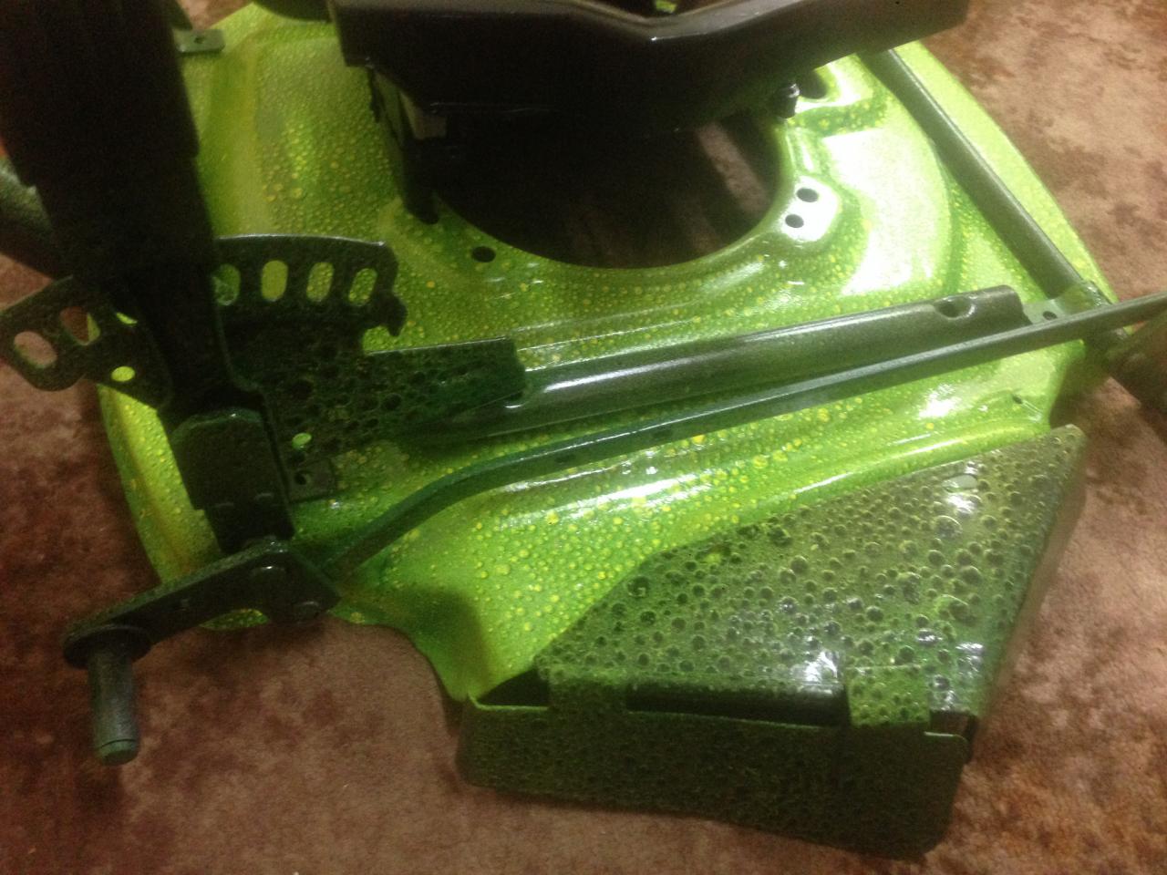

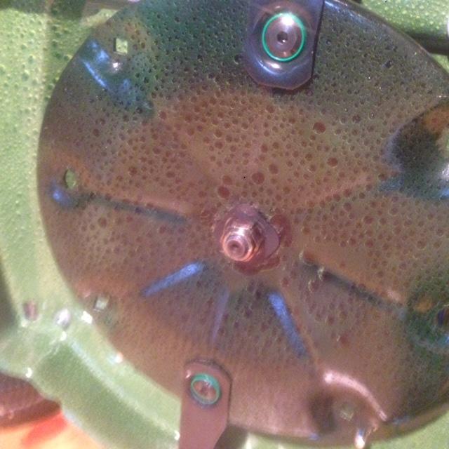

I picked up a Victa Utility from Berri in SA. It had been used until it's (premature) death on a property.
After a while of sitting in my drive way I stripped it all down and had a little play. The engine has been rebuilt but I was a little bored of the same old finishes so I had a little play with the water drop effect.
So far I have done the handles, axles/height adjuster, blade plate and underside of the body.
The underside was done in Brunswick green base coat, water droplets applied and dusted with yellow.
The handles blade plate, height adjuster and axles were done in gloss black base coat, water droplets applied and dusted with yellow then dusted with brunswick green.
The top of the body is done in yellow and will be dusted with brunswick green (After water of course).
In a couple of months when the lot has dried enough I'll clear it, apply decals and clear it again.
This machine was to be auctioned off to raise money for Oz Harvest charity but I'll miss the deadline unfortunately.
Here's a couple of pics so far ... (Sorry about the photo quality). It looks much better in the flesh
If I remember I'll keep this post updated.
Pete.

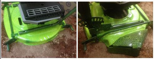

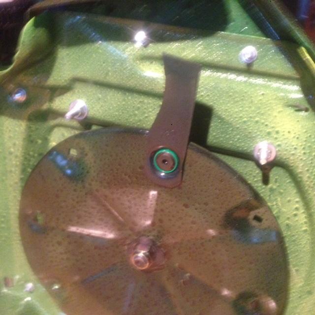

Posts: 325
Some more photo's
Again these photo's are ... well crap but you get the idea. I'll start assembling it on Sunday or Monday this week time permitting.

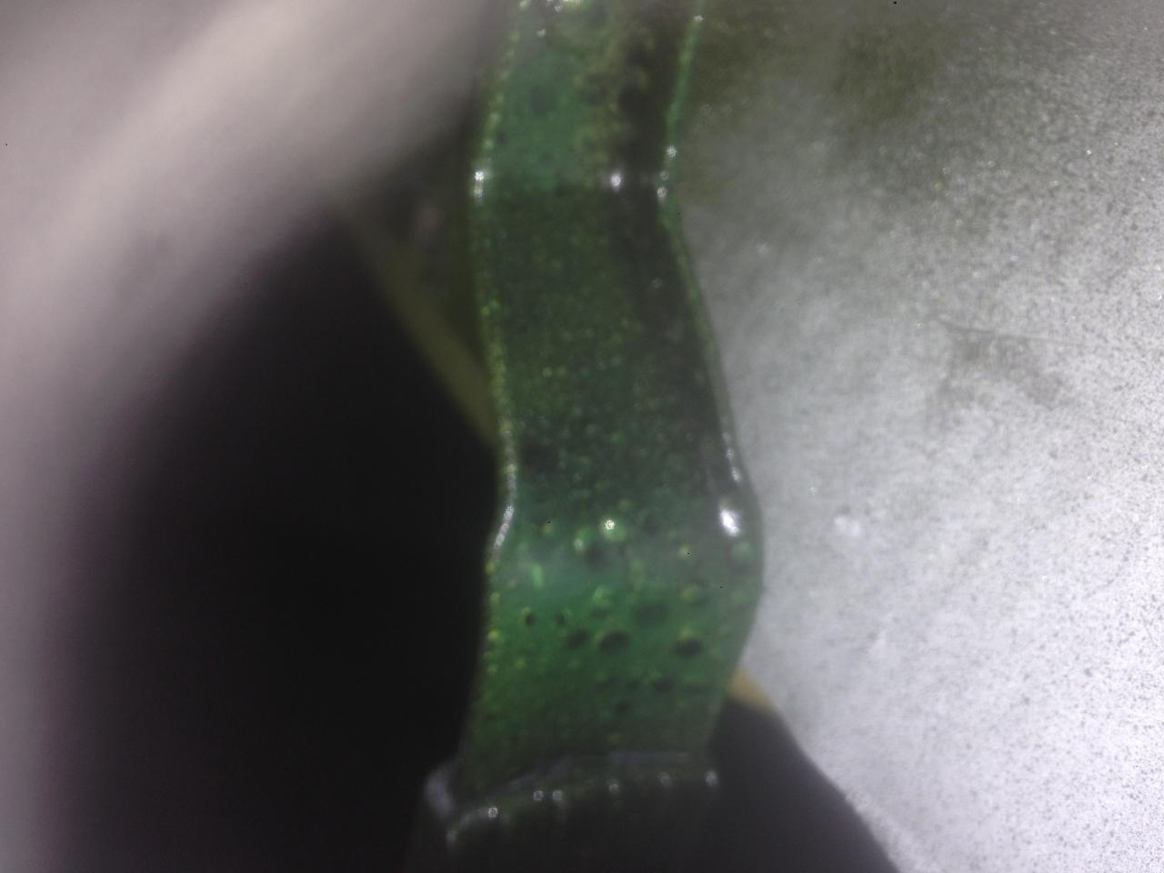

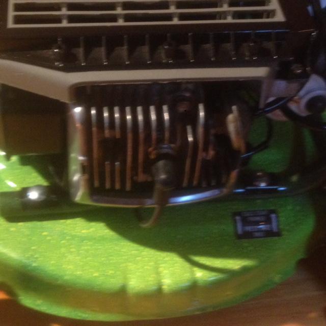

Posts: 325
OK So I actually finished the clear coat yesterday. It dried overnight (Not fully cured though) so I mocked it up for a photo shoot.
I'm just waiting on some new bolts etc and starter cord handle from eBay. Next weekend it should be fully cured and ready to assemble. Hopefully I'll get the engine painted up today so that can go on next weekend too.
Here's some photo's
Posts: 325
And put together it looks like ...
That's it for now ...

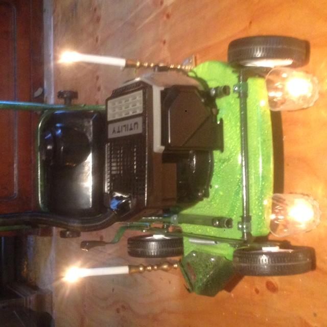

Posts: 325
Update ...
All that's left to do now is polish the head and bolt the engine on.
Looks like I'll make the deadline for the charity after all.
The underside of the body is the same pattern as the top only colours reversed. Once it's all finally put together properly I'll take more detailed photos.

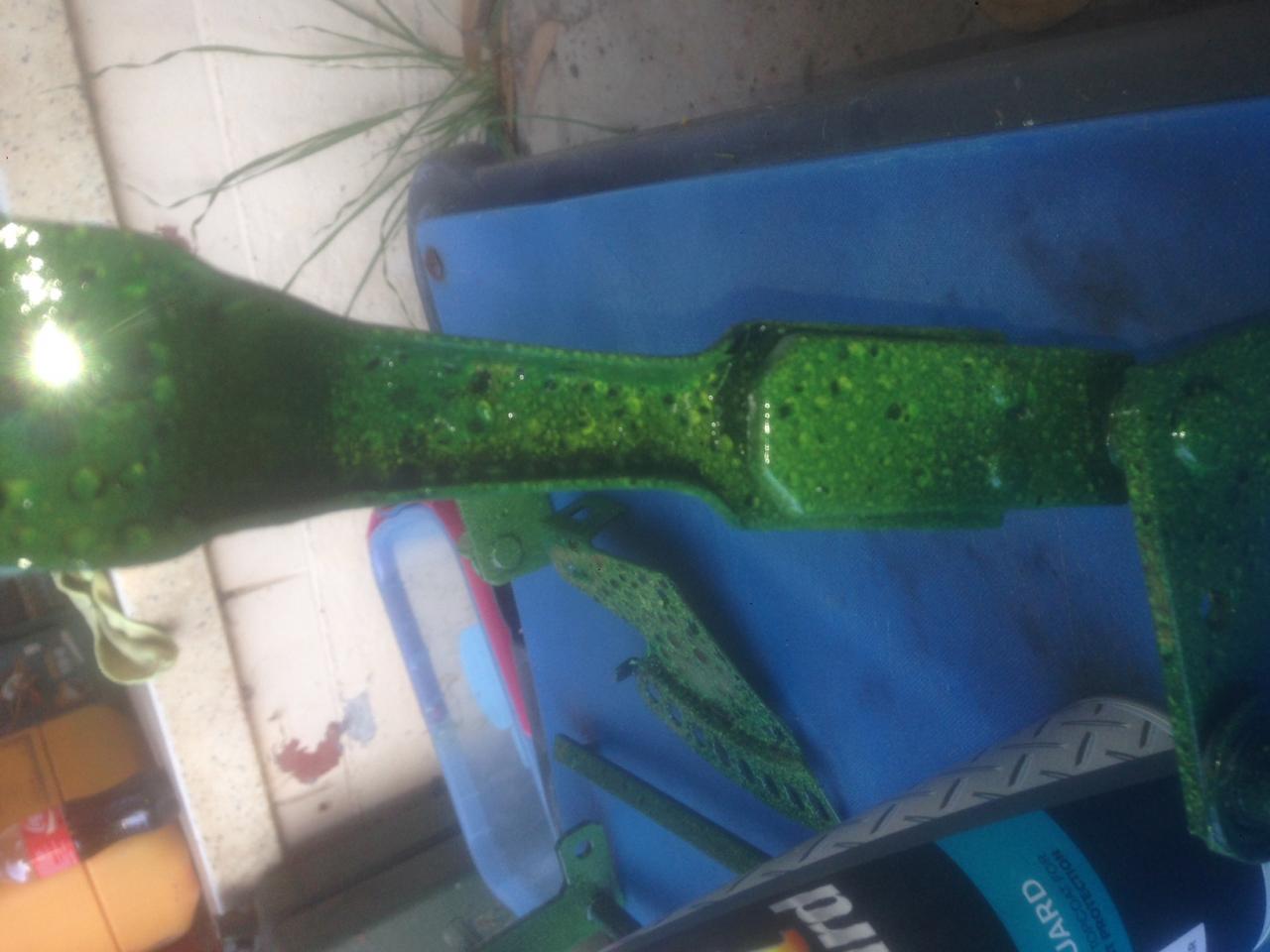

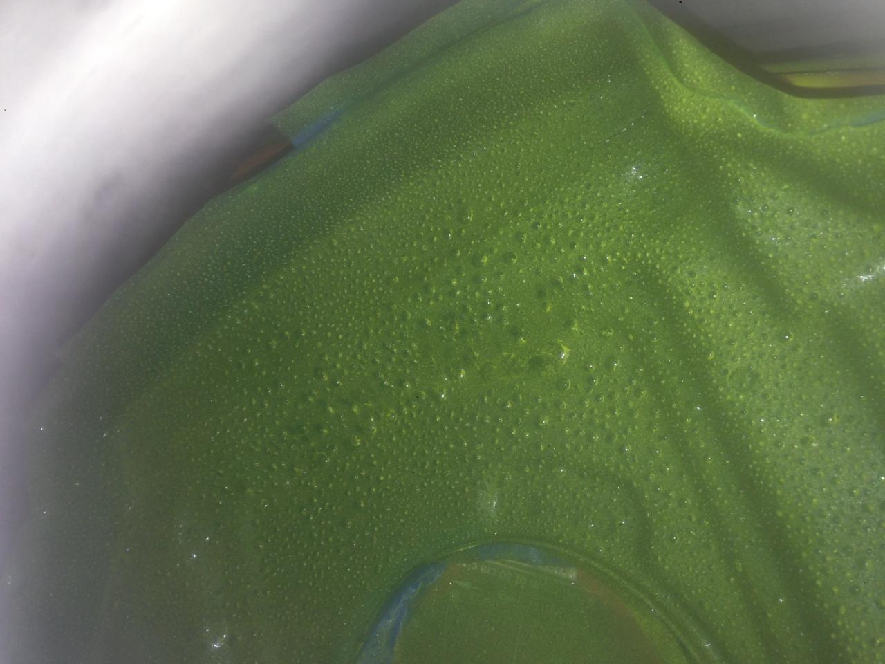

Posts: 325
Thanks Jack.
It's really not a hard effect to do. Just takes patience.
All you need to do is (always using enamel) apply a base coat, spray a bit of water on with a spray bottle until you have the pattern of drops you like then lightly dust with more enamel on an acute angle over the water to create the effect. If you then spray with a darker colour the opposite direction it brings the pattern out more.
There are a few tricks:
1/ select colours carefully - you don't want colours to clash
2/ let the base coat fully cure before spraying with water
3/ if you don't like the pattern you're getting with the water dry it off completely and start again
4/ (MOST IMPORTANTLY) know when to STOP dusting. It's VERY easy to go overboard with the effect.
5/ Allow a LOT of time for the water to evaporate and the paint to cure before touching it. tipping it up when the water has not dried will make it run.
6/ If you don't like the finish do a new base coat over it all and start again.
Here is a shot of the underside of the base ...
Pete

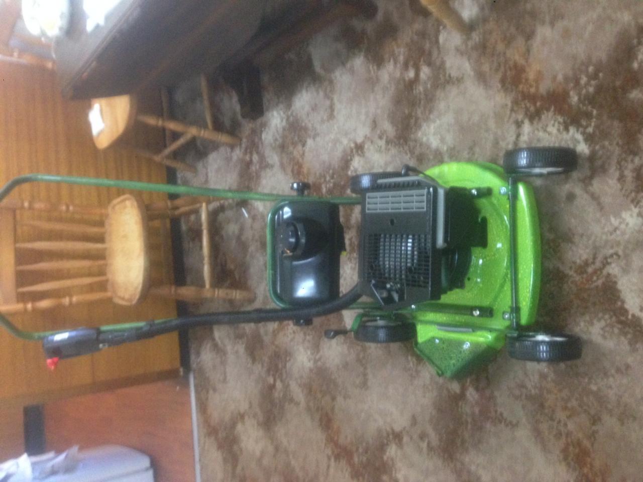

Posts: 325
Update time ...
Received the new plate (I ordered a new one in gloss black but they sent me galv).
All complete and listed for sale.
PLEASE SPREAD THE WORD. All funds raised are going to OzHarvest. I've listed it on eBay with a $150 reserve (It has cost me around $500 to do so I'm hoping it will at least get the reserve!
Some pics below but please check out the listing ...
