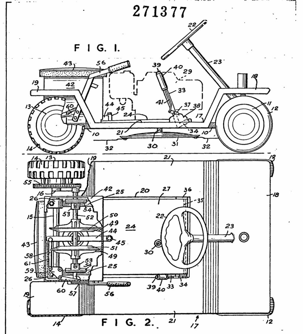

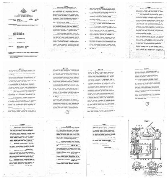

PART THREE - 1963 Patent
The main feature of the Mowmobile was not the styling - borrowed from
North American trends - but the unique friction drive system, patented by
Own Cox. That drive (now called a 'Live Drive') is still used today on some
Cox Industries' ride-ons. Amazing.
Global Mod Gadge has researched and found the original patent
lodged in mid-1963. It shows the direct drive feature of the cutter head.
Note that the original friction drive had a hand operated lever, rather
than a foot operated rocker-pedal, that would be used on later Cox models.
OWEN COX - PATENT - 1963

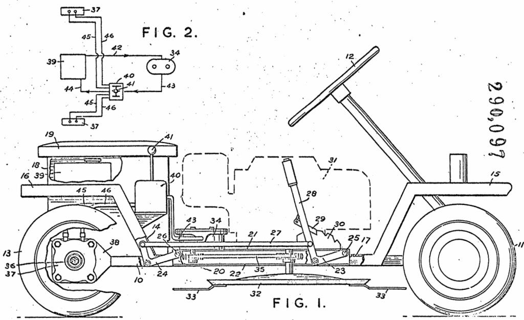

PART FOUR - Patent 49203 of 1964
I include this patent for its curiosity value. It suggests that Owen Cox
was looking toward the future of lawnmowers. It was a hydraulic drive
Mowmobile!
It never went into production - probably because hydraulics would
not have been cost effective on residential ride-ons.
The system was non-controversial: hydraulic pump, control valve, reservoir
and drive motors. We would see this system employed on large commercial
mowing machines by the end of the 1960s - on gang and golf course equipment.
I guess the advent of small purpose-built gearboxes, transaxles, and hydrostats
were better solutions for the ride-ons of the future.
