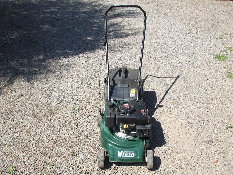

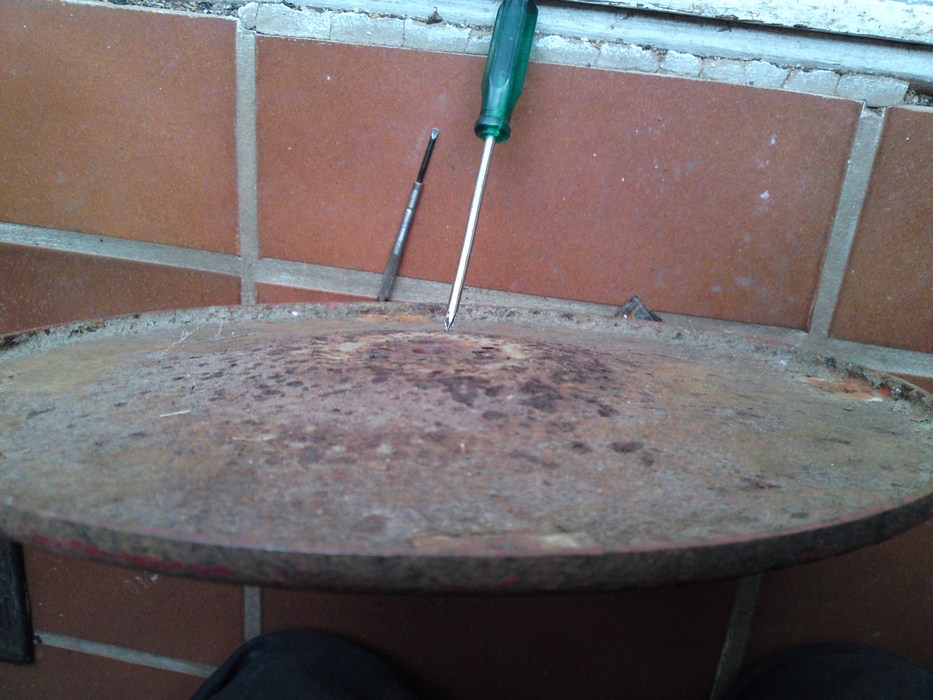

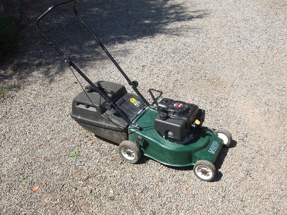

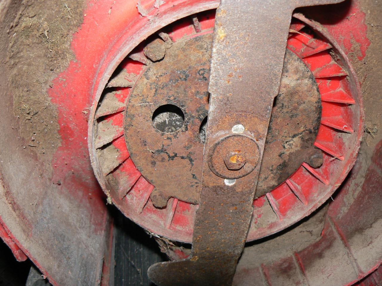

Hi guys,easy conversion,here are some pics from years ago. ![[Linked Image]](https://www.outdoorking-forum.com.au/forum/uploads/usergals/2016/09/full-9569-30261-zdscf1592.jpg) ![[Linked Image]](https://www.outdoorking-forum.com.au/forum/uploads/usergals/2016/09/full-9569-30262-zdscf1591.jpg)
Joined: Jul 2007
Posts: 580 Likes: 2
I've done the same conversion without any problem.

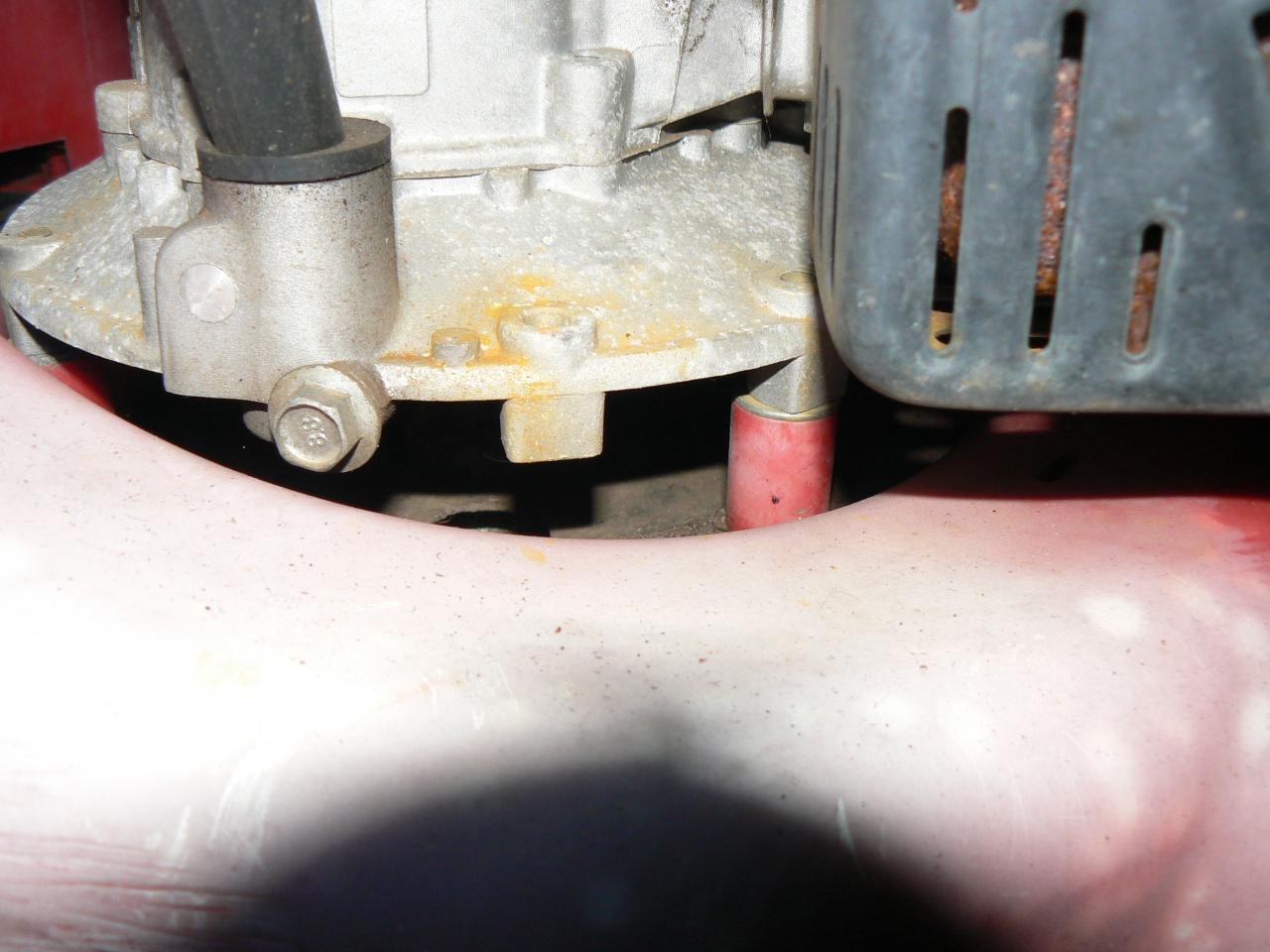

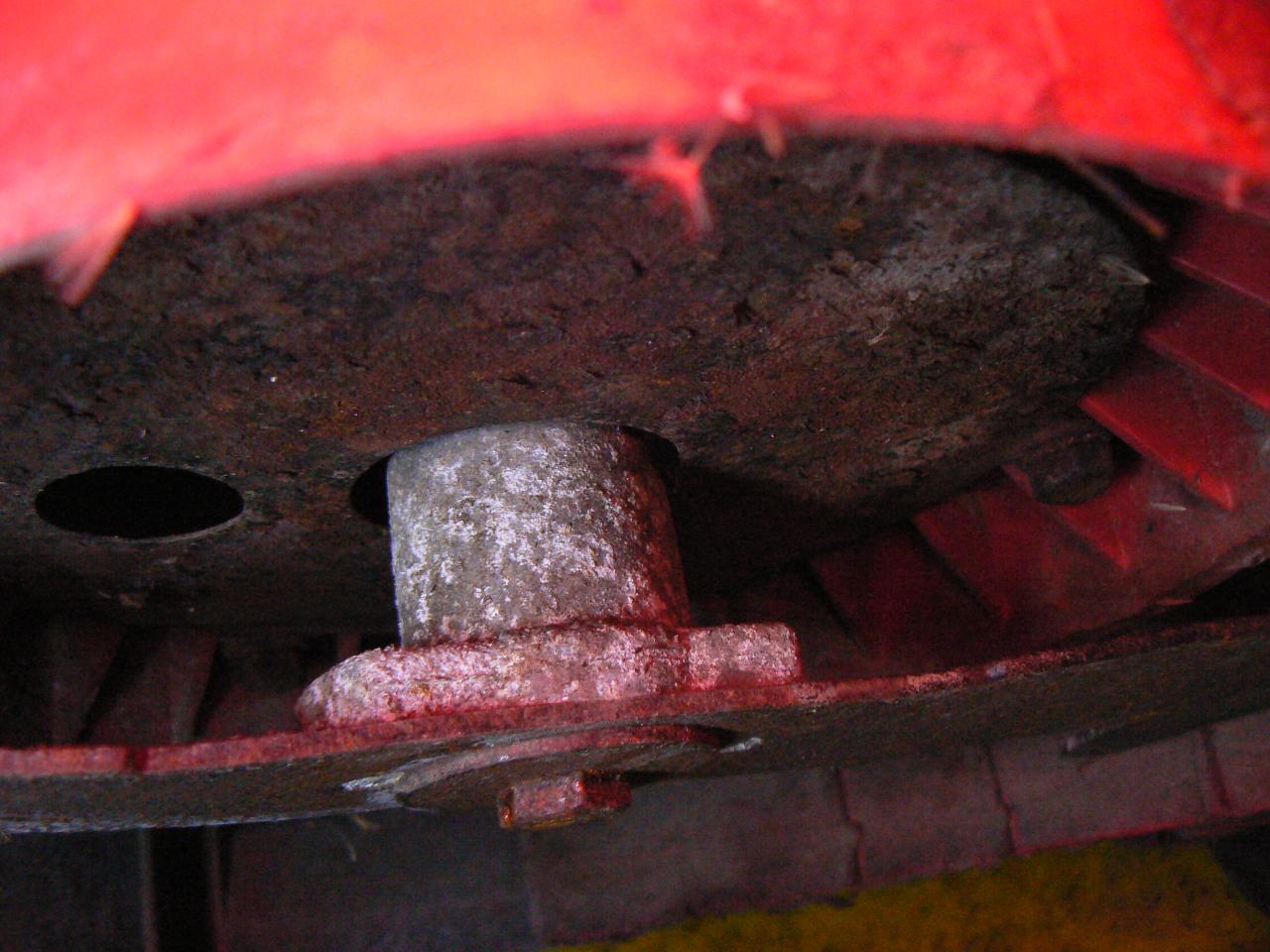

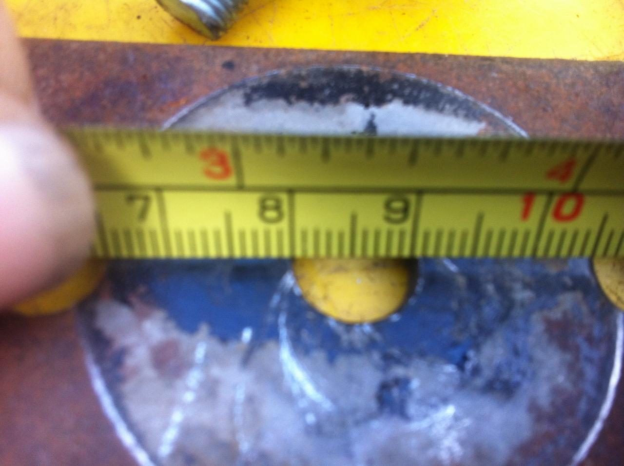

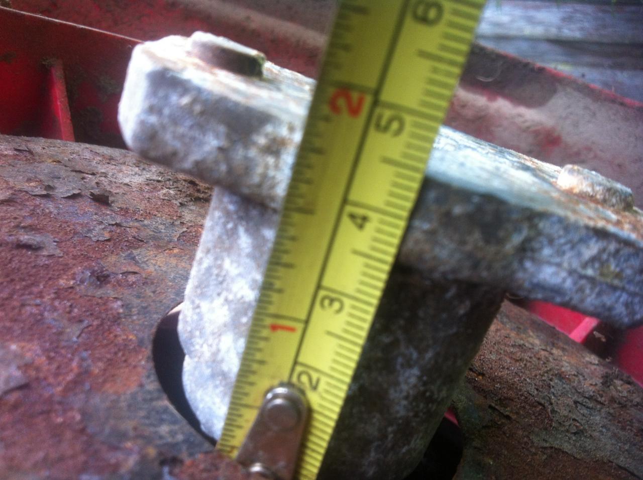

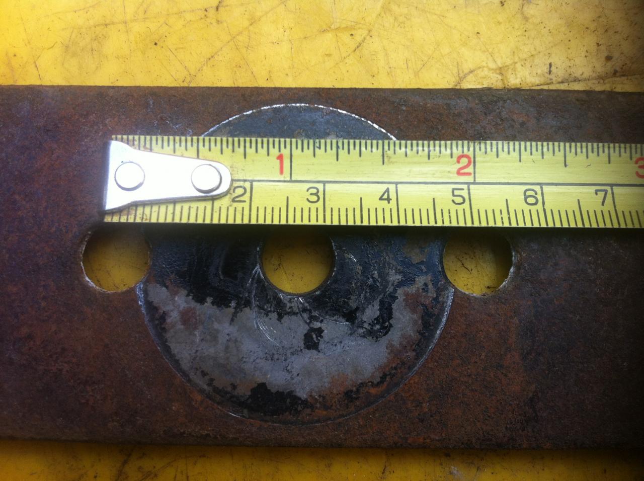

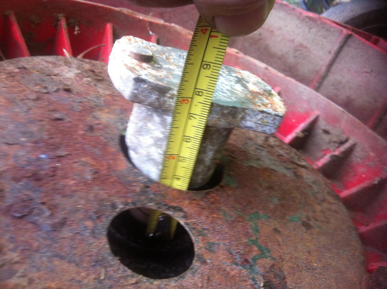

Hi maxwwestern and sparker. What did you do about changeover of the cutter blade? The current blade boss is around 45mm long and total length from motor to blade is about 75mm. The three existing blade mounting holes are 10mm approx 25mm apart. Considering an 18" single blade to fit the existing boss as Briggs had a 350 engine, which I believe is equivalent to the Sanli OHV350, that is running an 18" cut, so I anticipate the Sanli to handle the larger single blade as well. ![[Linked Image]](https://www.outdoorking-forum.com.au/forum/uploads/usergals/2016/09/full-9311-30302-img_3019.jpg) ![[Linked Image]](https://www.outdoorking-forum.com.au/forum/uploads/usergals/2016/09/full-9311-30303-img_3020.jpg) ![[Linked Image]](https://www.outdoorking-forum.com.au/forum/uploads/usergals/2016/09/full-9311-30304-img_3015.jpg) ![[Linked Image]](https://www.outdoorking-forum.com.au/forum/uploads/usergals/2016/09/full-9311-30305-img_3018.jpg) Tape measure is a little crude, but was close enough at this stage. Thank you for your assistance. :-)

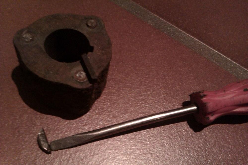

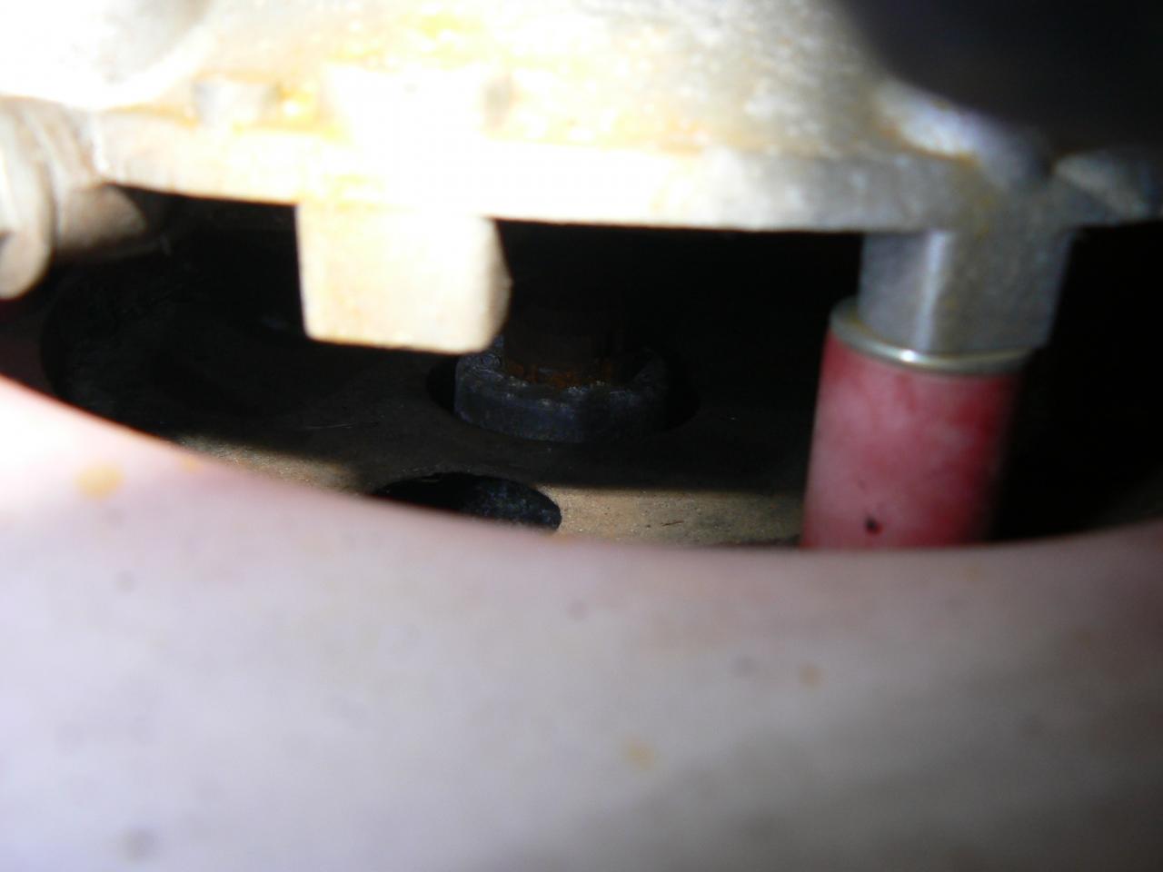

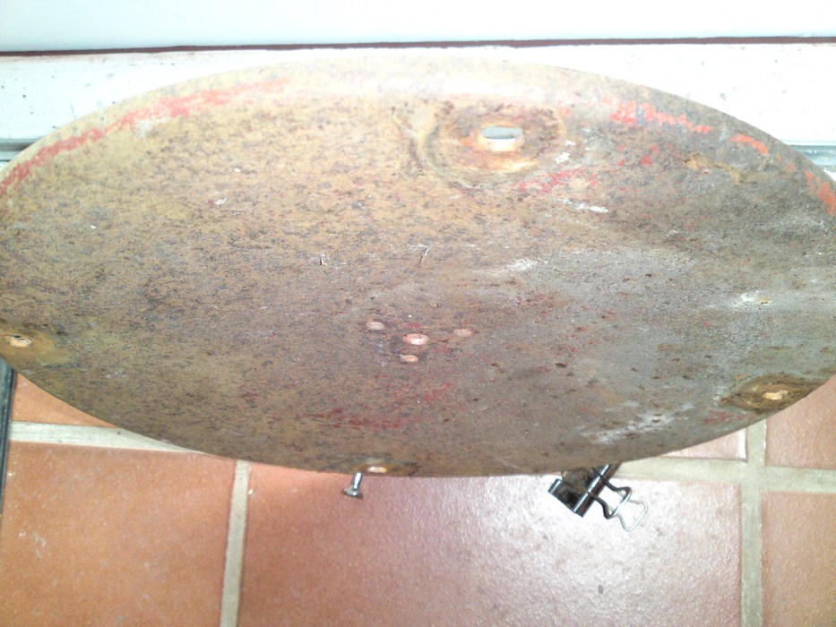

Hi Bushy260,the one in the picture was sold a few years back,your one has a alloy hub for the blade my one had a cast iron hub which was broken so I used a hub and round blade plate of an old Rover because it was a few years ago I am not 100 percent sure the exact details but have done a few engine swaps,one mower engine crankshaft had a wider half moon key so I filed the key way slot on the Rover hub about 1 mm wider then I usually use a flat round blade plate or one with a slight dish some times ![[Linked Image]](https://www.outdoorking-forum.com.au/forum/uploads/usergals/2016/10/full-9569-30331-a_key.jpg) ![[Linked Image]](https://www.outdoorking-forum.com.au/forum/uploads/usergals/2016/10/full-9569-30334-p01_10_16_17.03.jpg) ![[Linked Image]](https://www.outdoorking-forum.com.au/forum/uploads/usergals/2016/10/full-9569-30335-p01_10_16_17.031.jpg) you can turn the round plate upside down and fit blades on top side of plate to get the blades in the correct height position or make spacers or use washers to lift the engine up from the base,I have a few spare parts so I just grab a blade plate and check it fits. I bolt the motor to the base,take the hub off the crank if it is the wrong height for the blade,put a straight edge (or ruler,tape measure) across the end of the crankshaft and see if a flat blade plate will work or a dished one or lift the engine up with washers/spacers.
