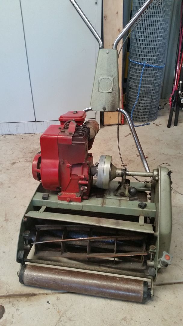

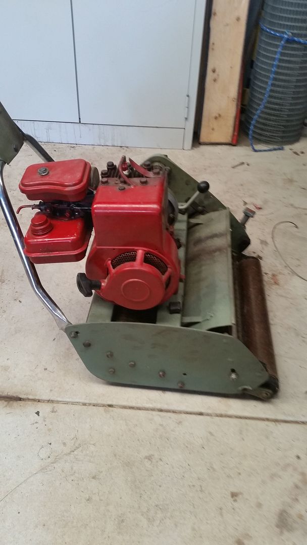

Hi everyone,
I wanted to share and get your thoughts on my $200 gumtree purchase.
I recently had spinal surgery and my old 26" reel mower had to go and seeing as I'm not allowed to fight fires for 12 months I bought this as a small project to keep me occupied until I'm 100% healed.
I'd like to put a new motor on it and clean it up so it lasts a long time with minimal maintenance. I also love the look of the red reels I've seen.
I'd appreciate any advice as I've never really put anything back together after pulling it apart before.

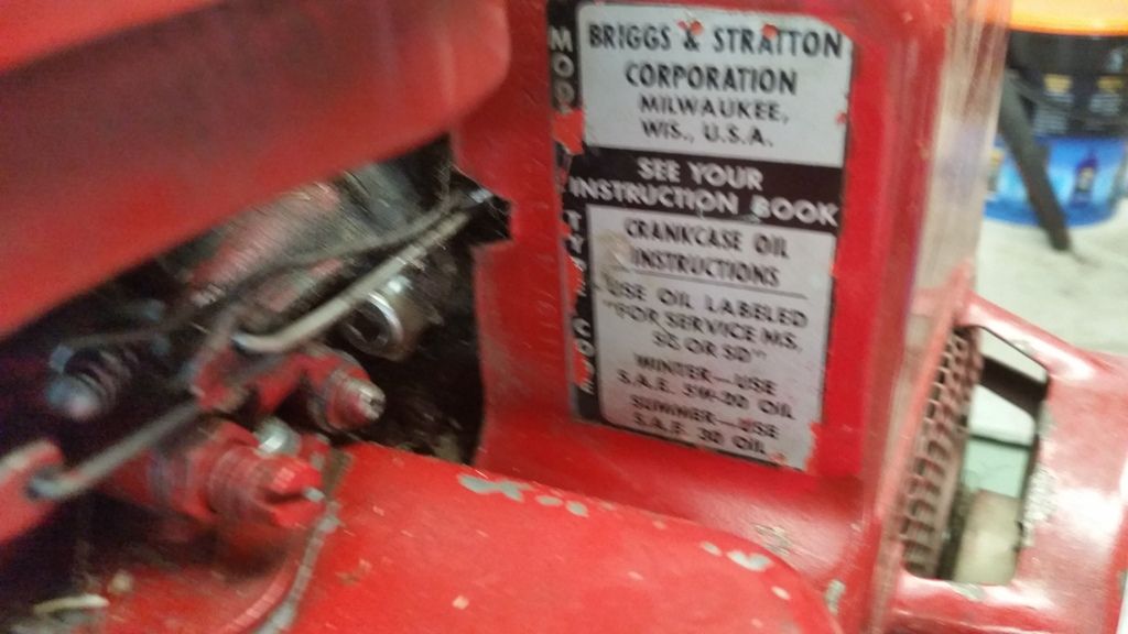

engine looks ok from here , just a little dark up top there is all have you had it running ? if smokey , maybe a honda might be the go , if its not then nothing really wrong with a briggs and easy to maintain . BUT if it is smoking looks like its been hot once or twice . discoloured up there but seen worse and still good to go .
looks like it has had a tidy up once before , wrong colours but still within requirements .. green n orange . decals you can get here or on ebay . paint is another story chevy orange or international red is engine but as close as you can find to a darker green for the rest of it as it is now looks like alpine green . too light BUT its a personal choice too .
any numbers on the engine cowelling will help id it close enough if it hasnt been changed . they are stamped into it just above muffler or beside it

Well your engine was made on the 18th of November 1976 if my eyes serve me correctly as that close up engine shot is pretty blurry. If this date is correct then it maybe the original engine from that mower but it has the smaller tank on it which indicates that it may be a 2.5 HP engine and not a 3 HP unit. Maybe you could type the sequence of numbers from top to bottom and that way we can identify it correctly and more accurately and that's provided the engine cowling hasn't been swapped over with another.

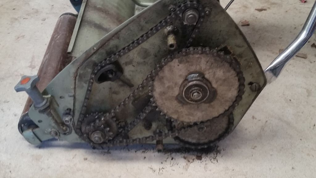

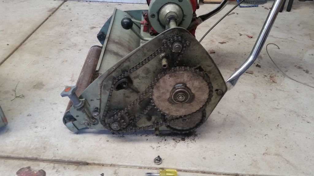

I note that a previous tenant has had rail fracture issues with the chassis and as such that's why that extra piece of metal has been welded to the leading edge of the rail. I suspect that it was the original clutch body that has worn and created this problem over time and that's why it now has the redesigned newer clutch body fitted. As your photos don't show the mower from the rear I can't see whether the rear rail has had any re-engineering done to it. Also I note that it's ID plates are not there on the rear rail but I can see only one set of holes where they were originally fitted. This suggests that the ID plate was the later Aluminum Silver / Red unit and with that the engine date does suggest that it is more than likely the original power plant fitted to a newly made mower in early (February ~ March) 1977.
Could you please supply some closer shots of the sprockets so that I can assess them properly as I feel the cutter sprocket maybe past it's use by date, but a better shot will clarify.

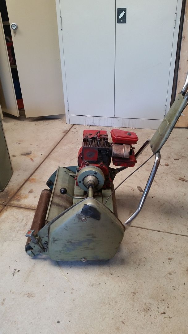

The engine is missing it's throttle control up on the handle bar and there's something poking out of the rear section of the carby / choke control area. More closer shots will identify this for us.
