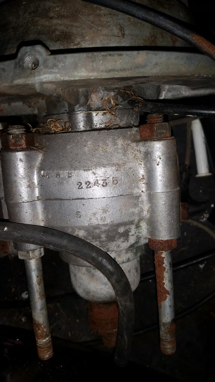

Hi all,

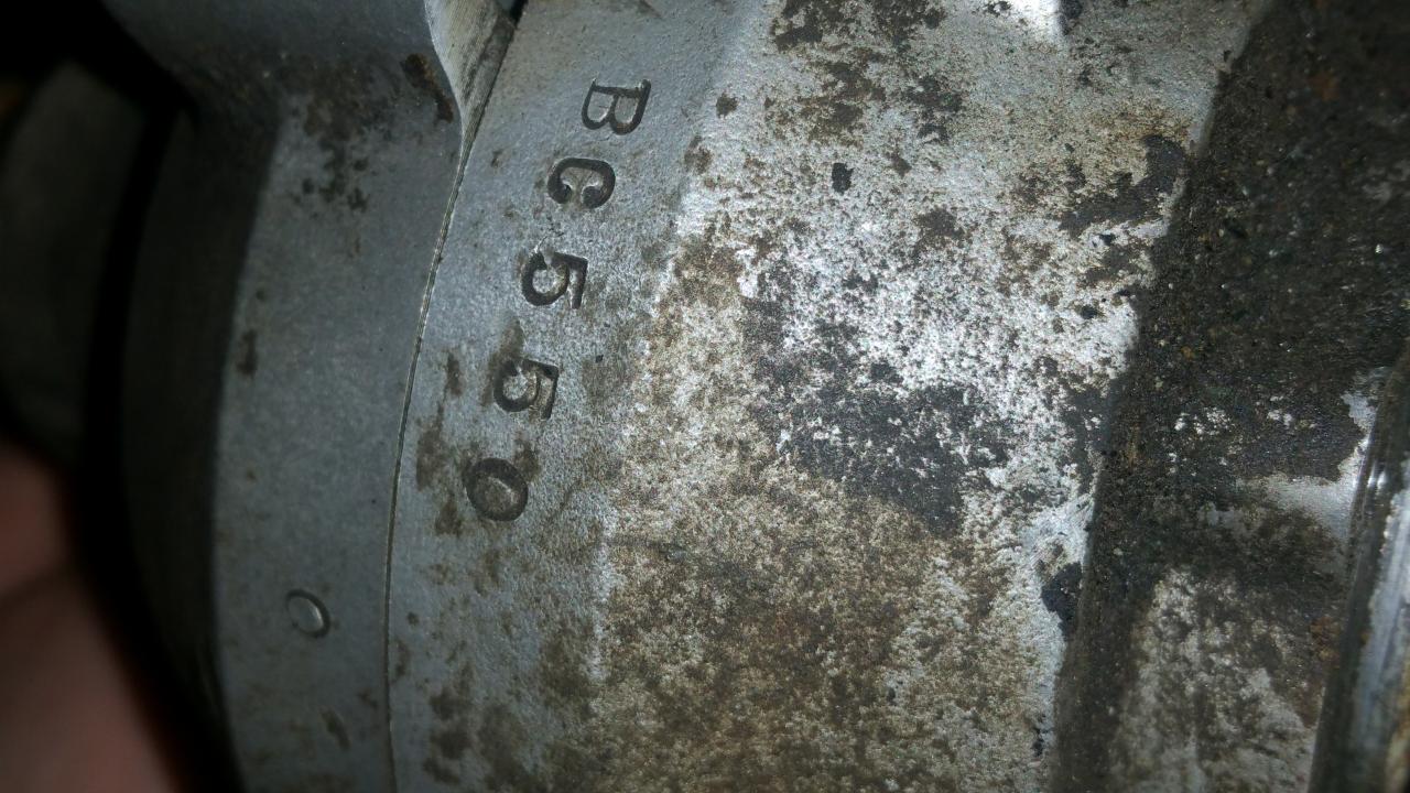

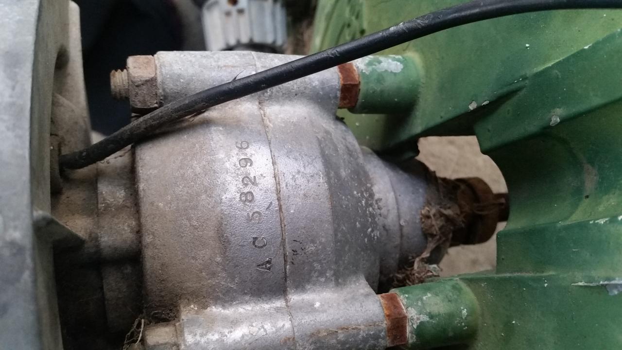

i'm new to this forum i have a few questions in regards to a couple of victa 18 specials and a box
of bits and pieces i have attached a few photos of the engine from the box can anyone tell me what exactly the numbers mean later i will post more photos including the other 4 mowers and the numbers on the engines thanks in advance
Well the numbers and letters don't really mean a lot unfortunately on these models.What I can tell you is those particular one's started in the model 5 series 2 and through until the first model Sheerline. At the time Victa had a very huge demand for their mowers,so engines numbers were fairly random,as they were just trying to keep up with the demand.A number system seemed to have taken a back seat while this demand was happening.There is a theory that the dealers were allotted their own letter prefix and the numbers were just a serial number.However no documentation has been found to support this theory.
The other numbers would just be cast numbers possibly the numbers from the moulds as they kept updating them.
There are other number which can identify the model's and years but unfortunately not these engines.

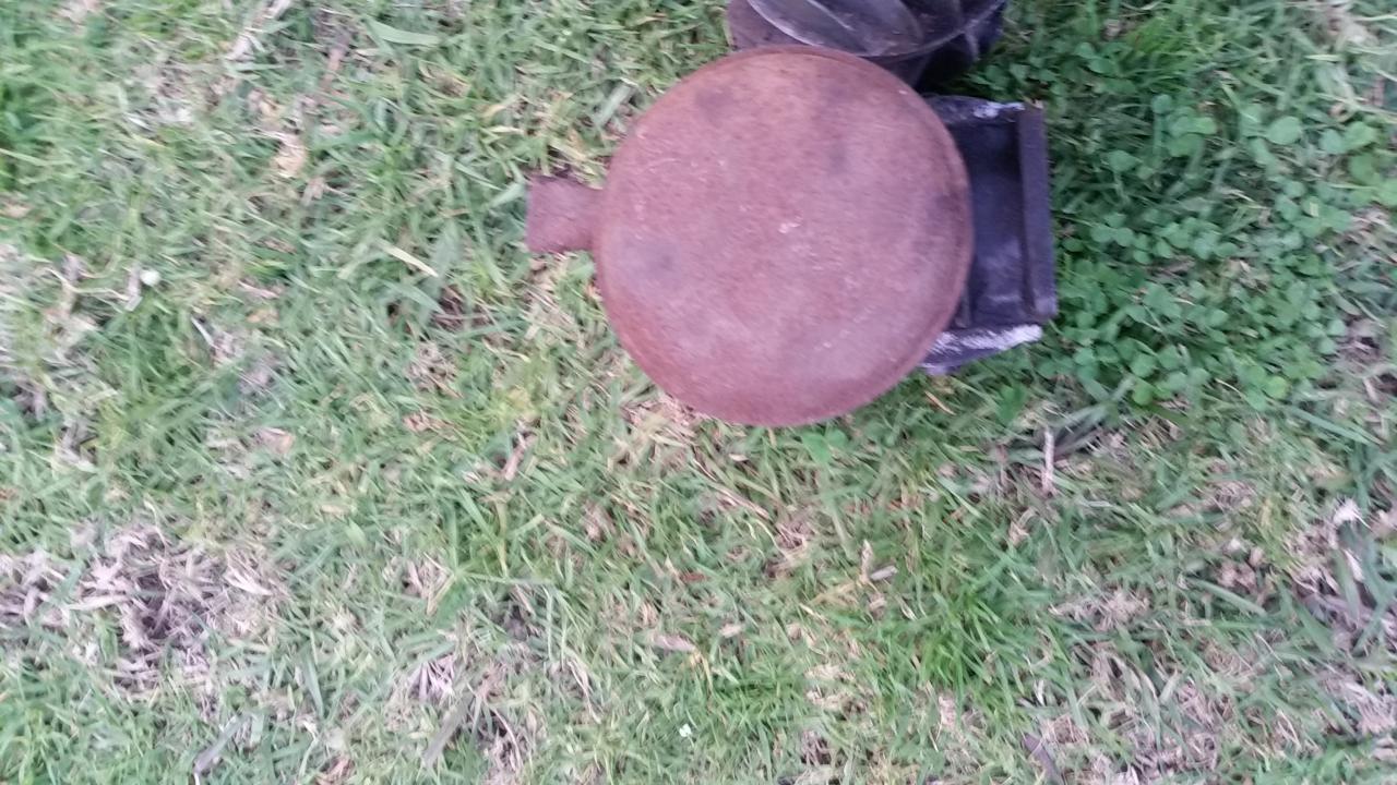

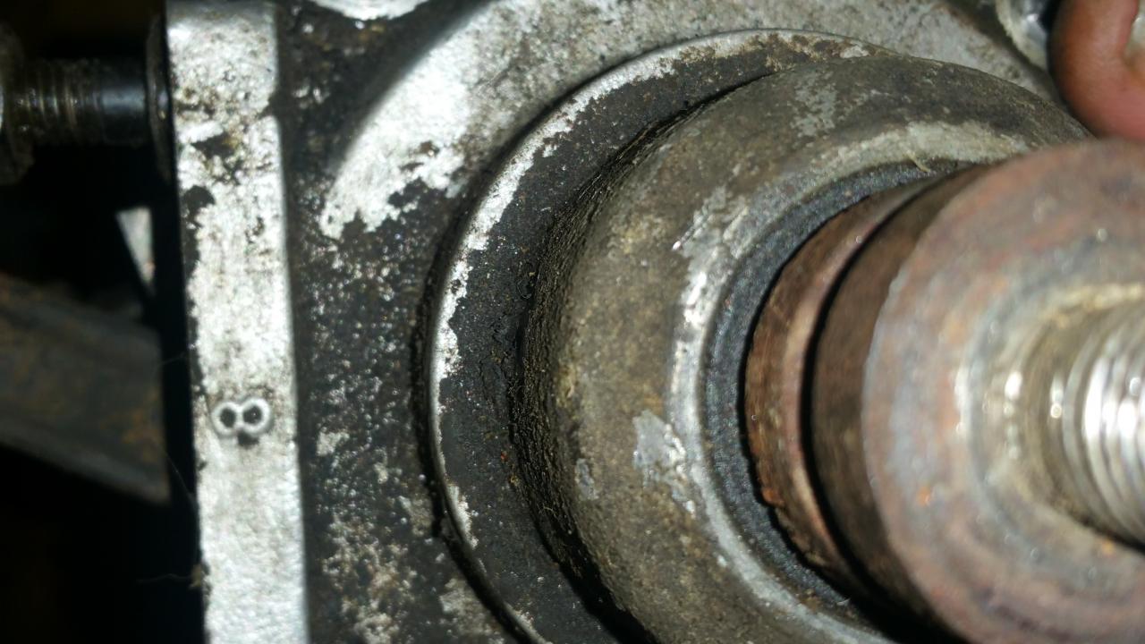

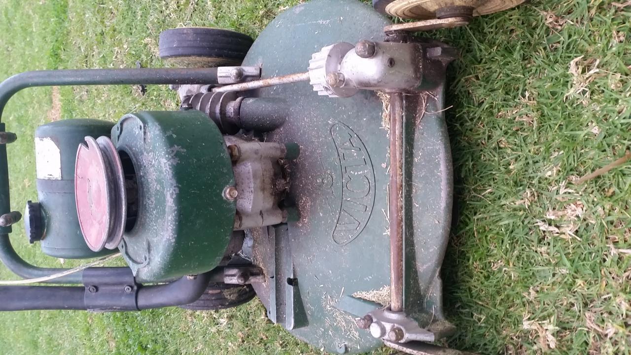

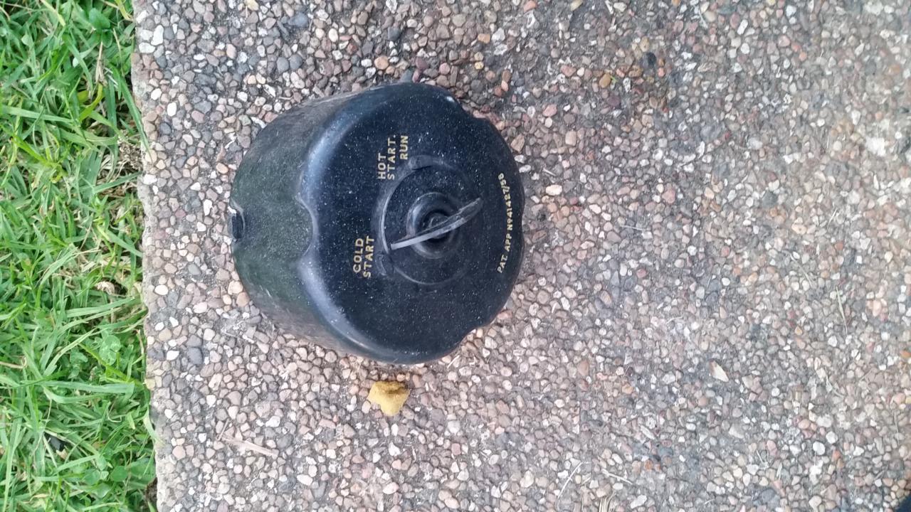

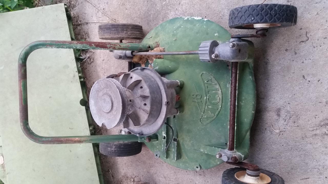

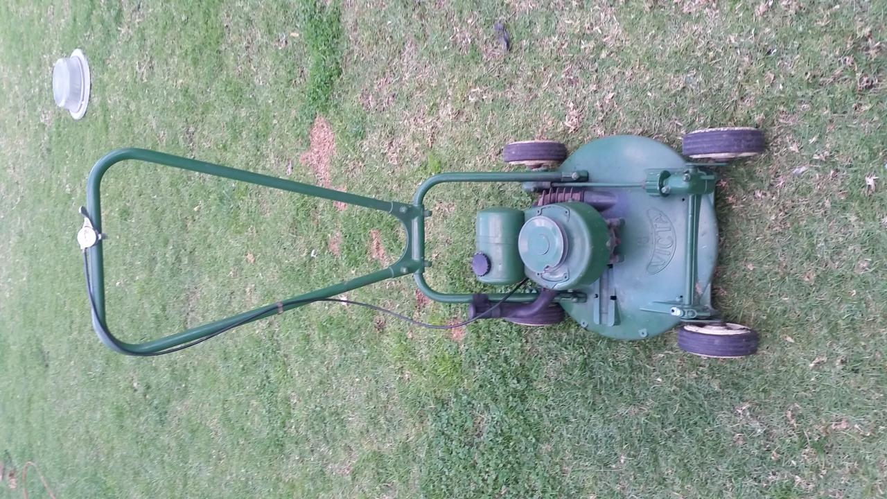

Thanks for the Info, These are the other photos that i said i would post any info on these would be greatly appreciated. the 2 mowers that are complete work & the 2 that are in pieces will work once i put them back together at the moment the pieces are in my shed.i was thinking it is strange how some of the engines have numbers and letters and some just have numbers or a single number underneath. Do you think its worth my time cleaning them up and respraying them or should i just chuck them out in the next council pick up.

The first two a both Model 5 Specials series I and both original engines shouldn't have any letters before them.I can't member off hand what the number range was.
The third one is a Model 5 Specials series II some of those had engine number and the later run had letter with the numbers.
The base with no engine seems to be a Model 5 Special series II,but someone has put the series I axles housing on it.
No I wouldn't throw them out.There not worth big money but they are worth something to collectors.They are also good for collectors that are starting out,as they are still a lot around.Also there are collectors out there that just prefer them and nothing else.So they are worth something to the right person and not worth it to throw out in the next council clean up.In fact if you did through to the kurb side I guarantee you they'll be gone before the council truck even arrives.

First one has an unmarked engine to match a HG Palmer I think.
Those pull starts are good too, they have the hard to get round knob.
Not worth throwing out, you could get at least $35 for that big black choke, and as Blumbly said, if you put them on the side of the road they will go before the council truck arrives. I sell the bases (no wheels, axles or handle bars) for $10 each at swap meets and they sell super quick, people just love hanging them in there shed.
If you don't want them put them up for sale, just don't throw them out.

Yes those starters were on either the model 4 automatic,model 4 standard and some early model 5's.The HG Palmer's (Of which you are thinking about) did run the same engine so it is very possible that numbers could match.
