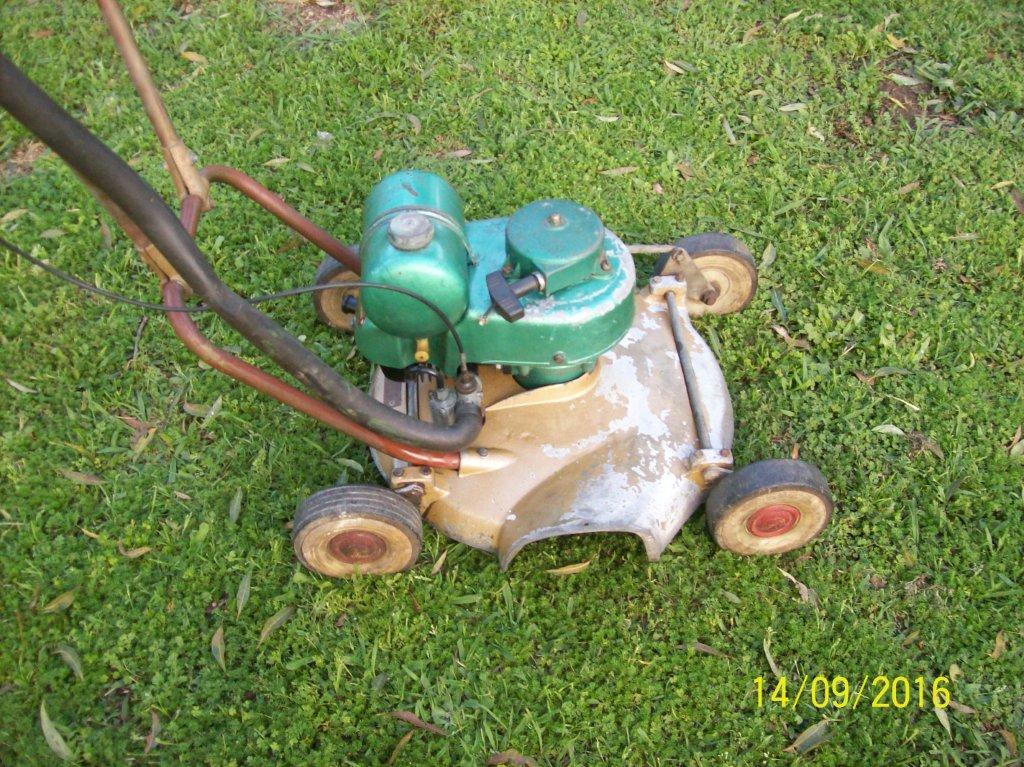

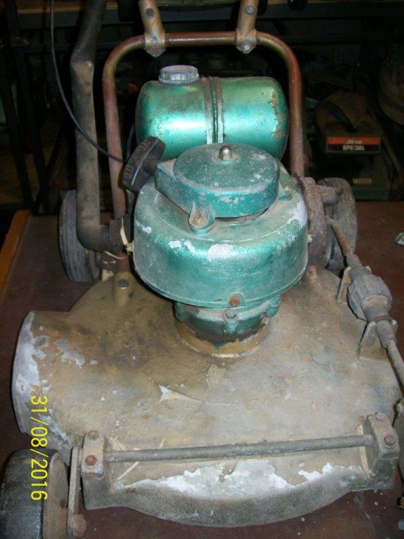

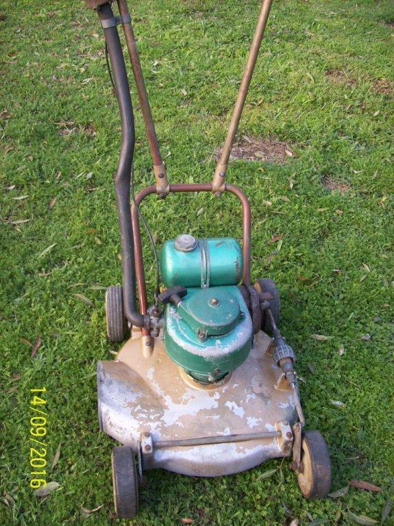

Well yet again I have managed to find another awesome Scott Bonnar model 35.The real good thing about this one is I believe I will be able to get this one going.Just have to check carby and spark and I feel it will run.Fuel tank inside is awesome.
Here is some pictures.

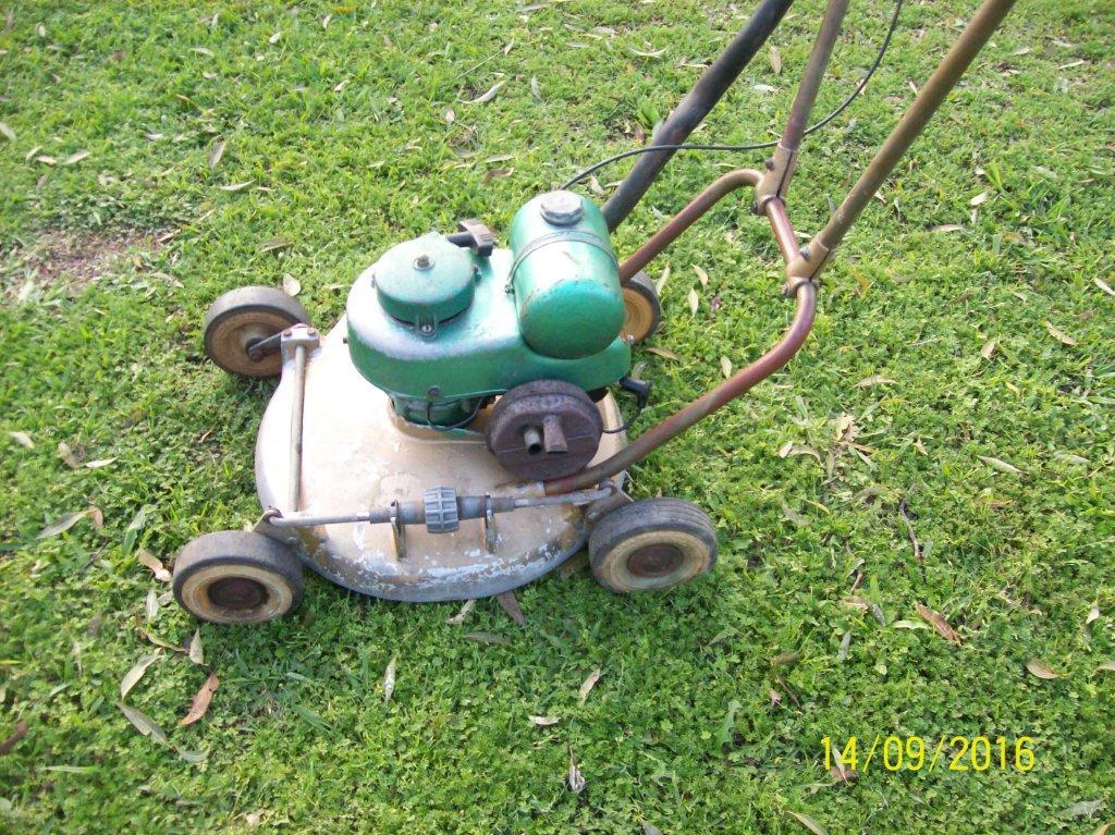

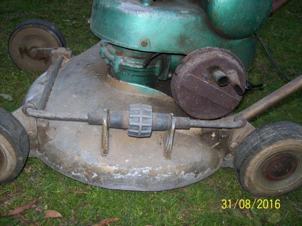

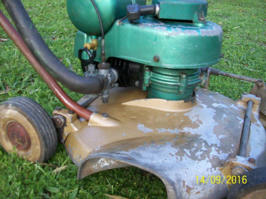

Check out the dual exhaust.I wonder if it will give it an awesome note? Like a V8,that would be good.
This is the first one I have found with this type of air-filter.
All in all another awesome find.

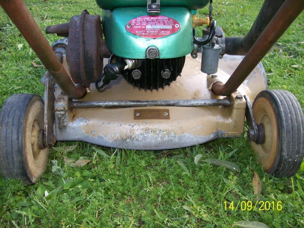

I guess the lack of the name cast into the base means this is an early machine.
I note the early machines were pre-Magister ignition.
This is not the first model (with the square tank),
but it appears to have no cowl hole for the external Magister unit.

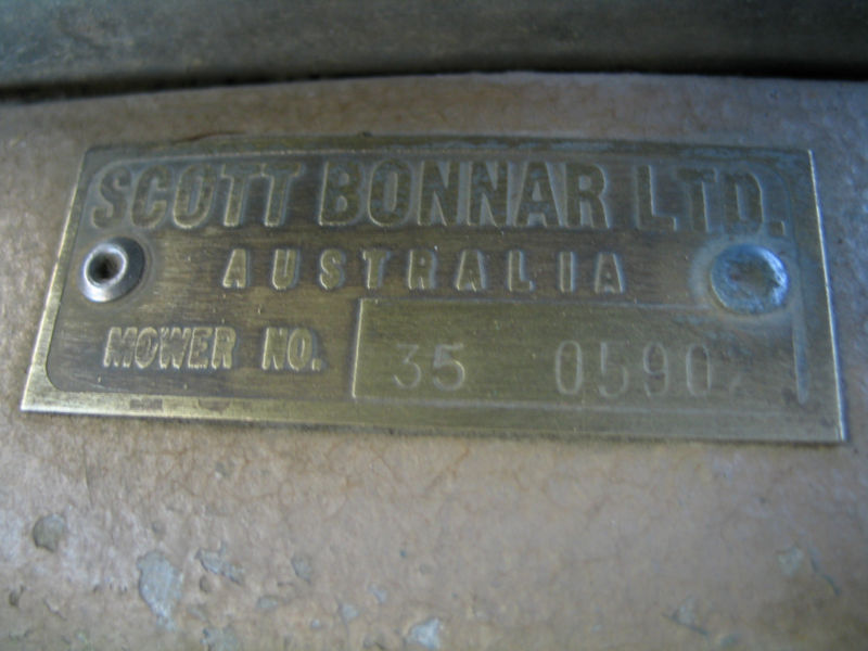

It would be great to get a close-up of the chassis plate.
OH OK Jack I know it is hard to date these as there really isn't a lot of paper work on them.Yes I also was wondering why the Scott Bonnar ins't cast into the base.The only other one I've seen without it was the one I have with LV30 four stroke engine.I am going to spend some time with it tomorrow and clean it up.I can take some more photos (I know I will) and show with it clean and hopefully some sunny.
I have noticed that it looks as though someone has done some work which is scaring me a little.As I've noticed the cylinder head is not the right way round.
As it is here.
...and this is off my other one that will have a magister on it.
It just worry's me.As why has it been put on the wrong way?

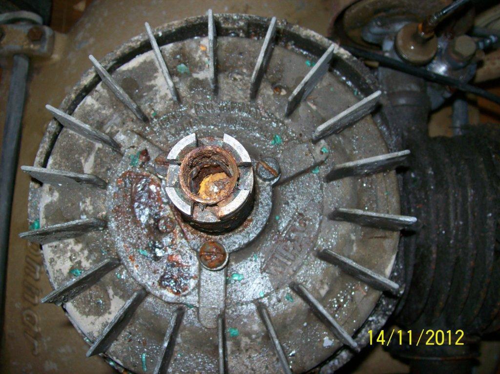

Now I think I've asked this once before as well as I have done it before,but can't for the life of me remember how I did it.I have to remove the flywheel from this scotty,but unlike other mowers the stater nut is different.
See below.
Now I'm sure Scott Bonnar had a special socket,but I don't.
Any ideas of how I can remove it without doing any damage to it?

OK starter nut was successfully removed and no damage. Awesome also does anyone have one of these mowers?Just like to see some pictures.

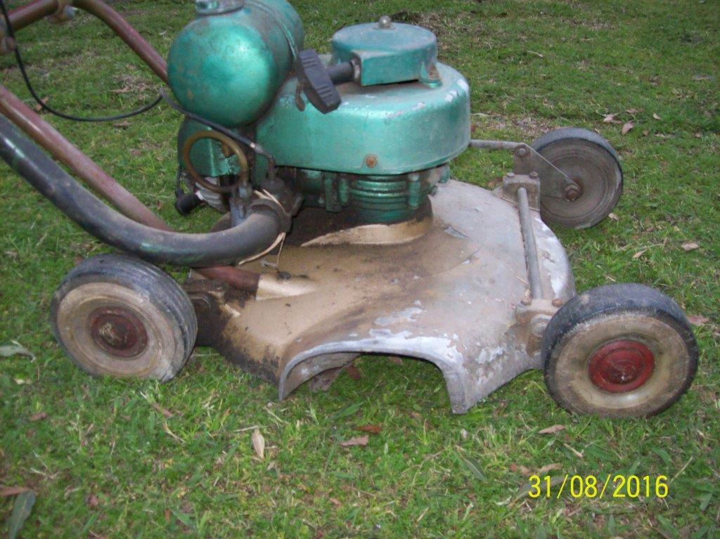

OK had some success today in putting the final touches on my Model 35 and getting her to run.
After the confusion about the fuel mixture,of which is I think 16:1.Strange I know seems like lots of oil but after the initiation start it didn't blow a lot of smoke and when I ran it around the yard it went beautifully.
I also took some new photos of it.

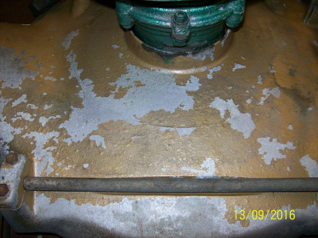

This first picture I put up as Jack (I believe) had asked for a closer picture of the front of the deck.With no Scott Bonnar casting.
Something I thought was odd about this Amal carby was the fact that it was made in Australia and the other 35's I have,had their carbys made in England.The one big difference in appearance is the lack of brass fittings.
Inside the engine itself was like brand-new.I don't know when but it looked as thought it had new seals,rings etc.So naturally it was a very easy clean up.Not even any junk in the ring groove's.
So it run very well.Here is a short Video of it's second start,before I mowed the lawn with it.I couldn't help myself.It was such an easy mower to push around the yard I was quite surprised.I'm very happy with this mower,and come the time it will be awesome after I restore it.
