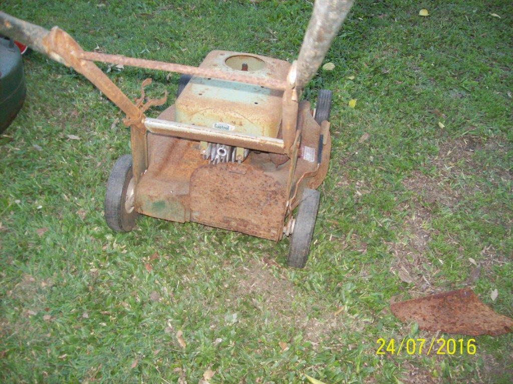

Bought this mower a few days ago for a couple of dollars. Would anyone have any info on this model? Engine was seized when I got it but managed to unseize it using some WD40. The blade disc holder nut is rusted on. Wondering what would be the best way to remove the blade holder nut without damaging the mower in any way? I think the engine may be off the "Cortina" model as well as the handle bars?
Any help/info most appreciated.

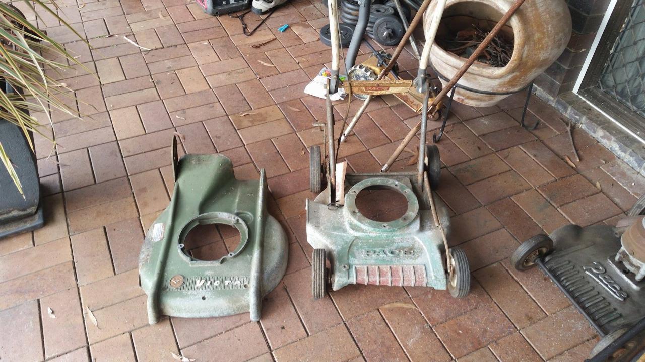

Thanks for your info regarding above mower. Got the whole thing apart today. Air powered Impact wrench certainly made easy work of the blade holder nut. Got the engine off and apart easy. Hope to do a full restoration on this mower. Also hope to find an original engine one day. Was wondering if I put this engine back on again is it possible to rotate the barrel 180 degrees so that the carby ends up on the correct side? Just a thought!

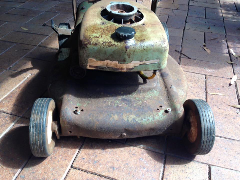

I just picked a Viceroy up the other day for $5! It needs some work but i am planning to restore it. Wish mine had a catcher!
I also have the other mower Jack was talking about, the Victa Ambassador , it may get a resto if i can find an engine, would look great having both together!
I can't wait to see how yours comes together, ours might end up looking the same!

Hi mowermechanic I know this is a few months ago but I've noticed some non-factory fitted things on your Viceroy.I do believe that at some point someone must have had a Cortina 2,as they have put these items on your Viceroy.One which stands out is the Cortina 2 cowl and starter assembly.Viceroys didn't come with those cowls.Also a little harder to notice is the handles and brackets are also of a Cortina. I'd even goes as far to say the engine also is off a Cortina as the carby and muffler are on the wrong side.The only way to get the carby to fit that side it to raise the engine,which I can see has happen.As the carby well is on the muffler side and unlike other mowers the bowl of the carby does have a close fit to the base.
I've just added one of your pictures.The two higher circles are the stop points which are the same as a Cortina 2.The bottom circle (under the muffler) is where the carby well is.
I know the condition of my Viceroy isn't great but you can see which side the muffler is on and also the stops bits on the handles aren't there.As there is a small hole where the bottom bar locks into the bracket.
There was two different models of the Viceroy the model 505 & 517.The only difference between them was the cowls and starters.As your has been changed I don't even know which model it is.
I hope your not disappointed I just wanted to point it out.As I know I hate it when I get something that is suppose to be one thing and then turns out to be a bitza.

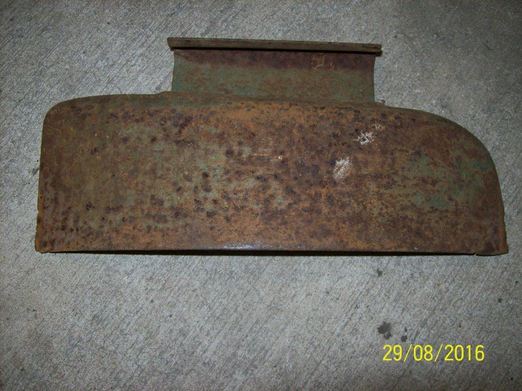

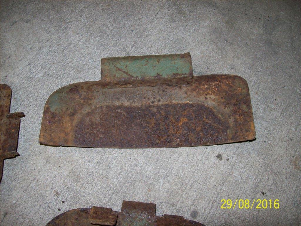

Mowermechanic blumbly any chance of a pic of the side cover I am after one just want to see few pictures make sure I get the right one
I'll get a picture of one for you some time today.

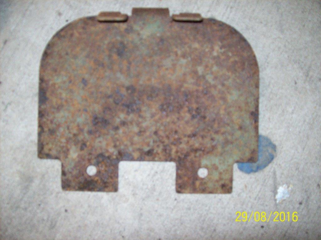

OK Gman as requested here are some pictures of what you were after.
I added pictures of all the extra bits they came with.The first is the side cover you were asking about.
Joined: Nov 2015
Posts: 637
I just happen to have a side windrow and cover the exact same as that. I also have the converter for the wind start. If I kept that Viceroy I would have heaps of stuff for it now.
