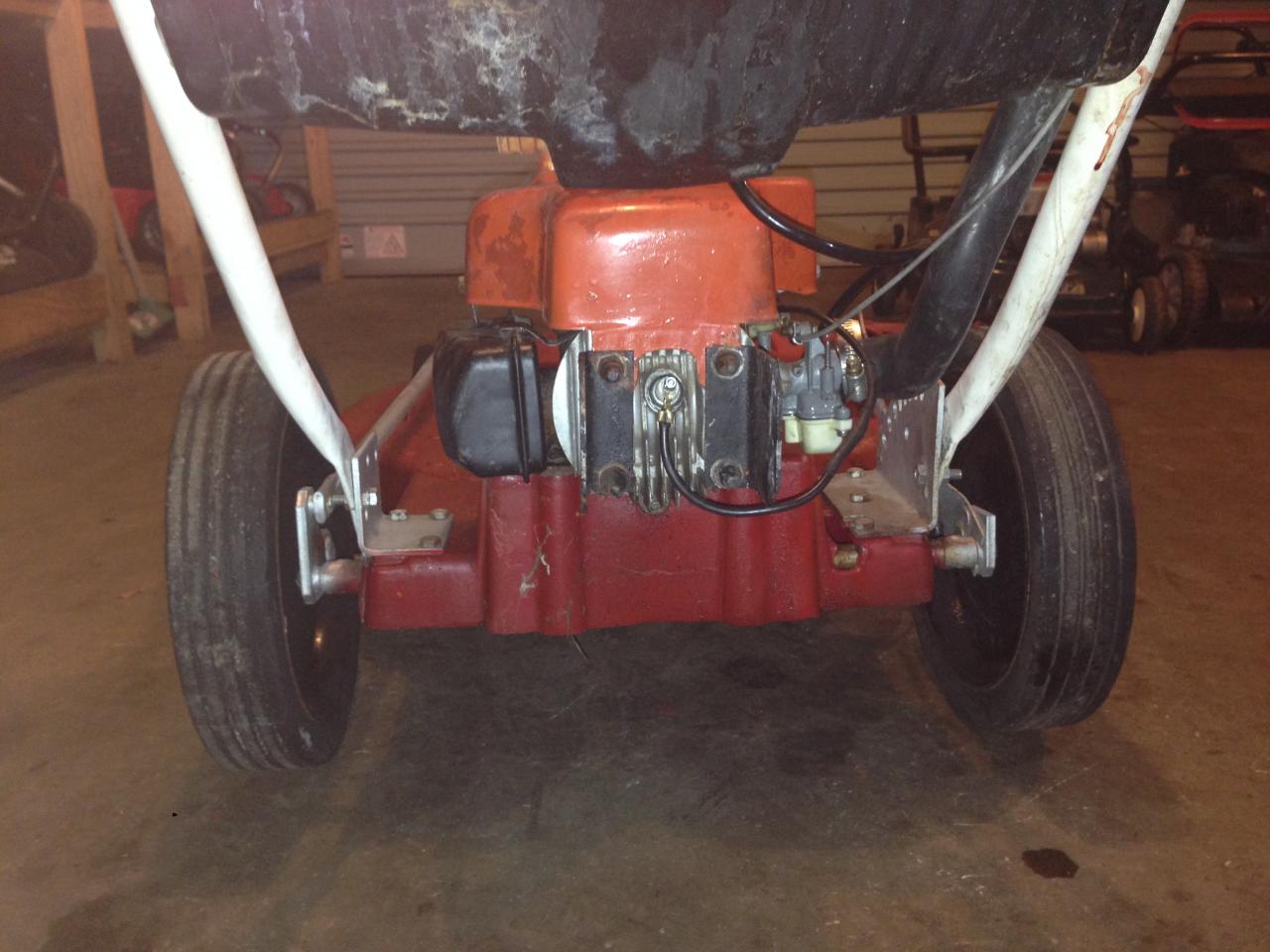

Hi Guys,
I recently picked up a Super 24 to re-furbish and get it back to use. I have only ever had one of these mowers before and I re-sold it before I got to do a complete once over. The offer I got was too good!
To date I have completed the following:
� Cleaned and re-set ignition system (points). The engine now has nice bright blue spark
� Cleaned the G3 Carb � bowl gasket was in good condition. Reset air vane in accordance with the Victa Manual.
� Repaired ignition lead
� Installed new blades
� New Air Filter
� New Spark Plug.
� Re-tensioned belt
� Cleaned all of the carbon from the exhaust port (piston and rings were in excellent condition)
I have read a few threads on these mowers and checked the following areas of concern for these mowers:
1) No damage was evident on the blade plate
2) Axles were all in good condition with no cracks evident
3) Height adjuster works perfectly.
4) Minor repair conducted on alloy base � no further cracks evident
5) Drive Belt assessed an in good condition.
The mower takes a fair bit of effort to crank over but I can generally get it to start within 1 pull of the rope from cold. This particular motor does not have a decompressor so that does make it a little harder.
Before sending this mower off to work I�d appreciate any other pointers to ensure its service is as trouble from as possible.
I have included some pictures of the finished product.
Thank you
Jaffa

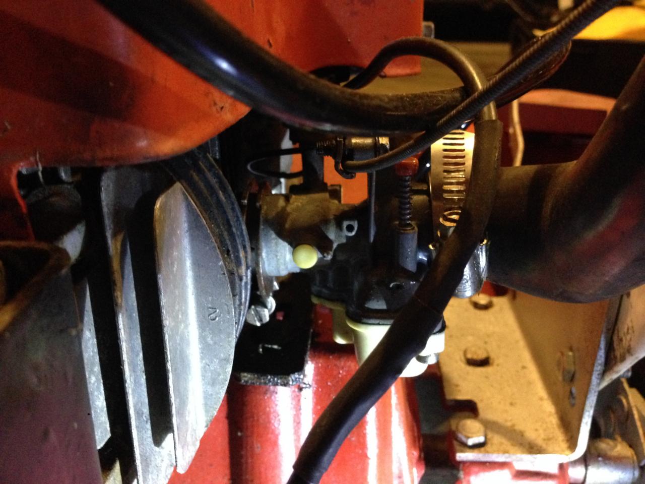

There is no port in the engine head for the decompressor to be fitted.
I have included a photo of what appears to be the vacuum line port however I might be wrong as I am not familiar with the term � Barrel intake spigot�.
If you guys have any suggestions on additional maintenance items they would be appreciated.
Can't really make out the detail well enough in that pic, I'm afraid.
The vacuum line fitting is on the top side at the inboard end of the intake spigot [this is the tubular bit that sticks out of the side of the barrel/cylinder, which the carby mounts to]. It was only used with the G3 carby, BTW - earlier models didn't have decompressors.
Like the one in this pic, with the vac line on it:
Posts: 445
Hi Gadge,
The engine has the vacuum line fitting however it was blocked off in a similar way some of the powertorque engines are blocked off when they don't have a decompressor. The head definitely did not have the port for the decompressor.
