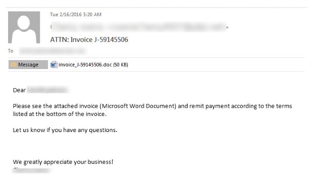

The most common way to get it is through a spam email that has a word document in it that usually comes up with a name of "invoice".Which will look something like the picture below.
Now we all know about opening emails that are zipped up or an .exe file,but until recently nobody realized about doc files.
In that 50 KB document there is a hidden .exe file.Up until the February update it wanted you to click the options button in the picture below,which then activated,but the updated version I got I believe it doesn't need that process.
Once that document is activate the ransomware (in the background) installs it's self.Immediately once it is installed it then sends a request to it's server to receive the rest of the files (and the encryption key it will use) it requires to complete it's installation.

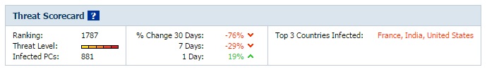

This image is a threat Scorecard,just to show you the level of the threat.
