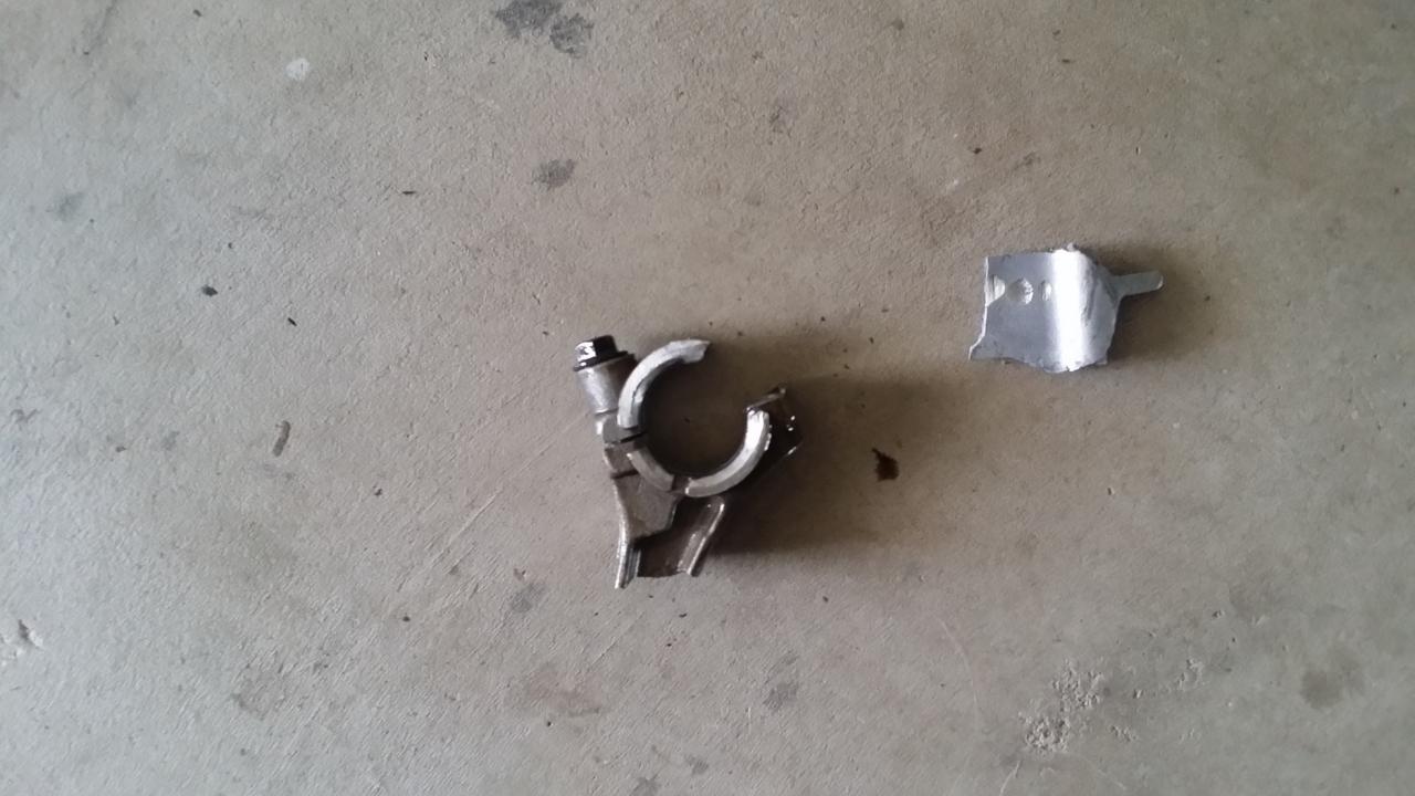

I sold this mower yesterday. I thought it was in excellent condition. I started it for the chap (started first pull)and demonstrated its power for him. He went away very happy but called me that afternoon saying the mower exploded and a part just missed his leg. He brought it back today and I gave him a refund,lol. Check out the blast area. [Linked Image]

Hello Sparker
Well, you acted in good faith and the buyer got his money back.
It will be interesting to hear from the experts as to the cause.
There appears to be no loss-of-lube signs on the journal.
There are two breaks. Which occurred first and why?
Posts: 988
Likes: 7
Is that the Tecumseh engine ? I had one do exactly the same except the broken part didn't fly through the crankcase. Yes plenty of oil present, bad batch of rods perhaps.
Posts: 8,176
Likes: 232
Paul, con rods get tired and there is no history on how these motors have been treated in the past. Some years ago I was putting an Enfield motor together for a friend and I said to him, "this con rod has done 120,000ks I think we should replace it as this is its 5th rebuild" His reply was "because it has done 120,000ks I think this rod is a good one" 5,000ks later the motor threw the rod out through the side of the case

Very true Norm, when you consider how many units are produced the number of failures is probably extremely low.

No. It's a chonda.It was the conrod that broke. Maybe we should start a collection of these photos.

Unfortunately I have seen a fair few of V40 Victa�s with these problems. Unless they are in exceptionally good condition with very little use I won�t pick them up from the local recycle yard. The Sanli mowers also fall into this boat unless they are close to brand new.
I have however found the Rover Chonda�s and the Pope Chonda�s to be quite reliable. They also come on more robust bases.
Last summer I had 2 Chonda�s poke legs out the block which frustrated me considerably as they didn�t have rod knocks and all run considerably well after being serviced. Everything on these engines was set to GXV140 specifications.
Key items to check on these chondas before refurbishment
1) Make sure they have not been over-revving. Easy checked via the linkages.
2) Check condition of the bottom seal (they seem to chew out easily and loose oil quickly)
3) Make sure the oil has no metal flakes � sign of engine damage (excessive wear).
4) Make sure the oil is full before you take on the refurbishment. These engines don�t seem to tolerate low oil levels unlike the trusty old Briggs engines.
5) Check the blade boss � I have found quite a few with cracks.
6) Check compression
I�d be curious how others assess chonda�s to minimize the chance of this type of issue. For me if the mower passes these initial tests I�ll get to work on them otherwise they are parts only.
This problem has never happened to me with a Briggs, Tecumseh or Genuine Honda Engine before!

first thing we would ask customer if we sold a good serviced mower to and and it blew up is do you have a steep block
four stroke no good conrod have no oil even if if it full of oil
people don't now this cry
There does seem to be one fairly common exception to this - the Briggs Sprint/Classic 35 and 375 series won't tolerate low oil levels, and will then 'put a leg out of bed'.

I think this one WAS over-revving at full throttle. I was interested in your comment about how you can check this from the linkages. I come across a few of these at the recycle centre and I've always been attracted to them because people still think Victa is a quality brand and it makes them easier to sell and also because they're easy starting. What's the best way to check for this over-revving problem?

Gadge I should have been a little clearer with my comments.
To clarify � I was confirming I had never had an engine blowout happen on a mower which I had serviced/ refurbished that was either a Briggs, Tecumseh or Honda etc. My comments were more in relation to my experience with second hand mowers and wasn�t meant to be a generalization about all engines.
Apologies if it came across the wrong way.
Yes I have seen a fair amount of Briggs engines with holes in the block so your comments are more than valid. I was just referring to getting mowers returned due to catastrophic failure like sparkers. Over the last few years I have only had 2 Chonda�s returned and that�s what I find interesting. No other genuine brands have had this problem from my experience with the exception of course when people run them out of oil.
I am very careful about what mowers people buy to ensure they are well suited to their proposed use. I will only sell 2 strokes to people with steep/ uneven blocks to avoid the issues raised by freebird. By following this principle I rarely get if any complaints!
