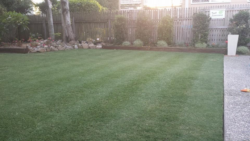

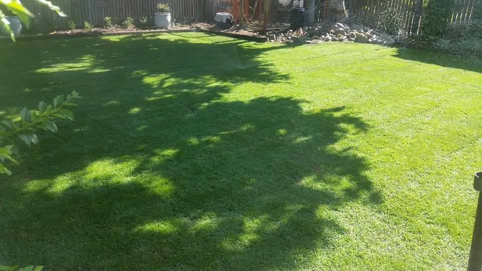

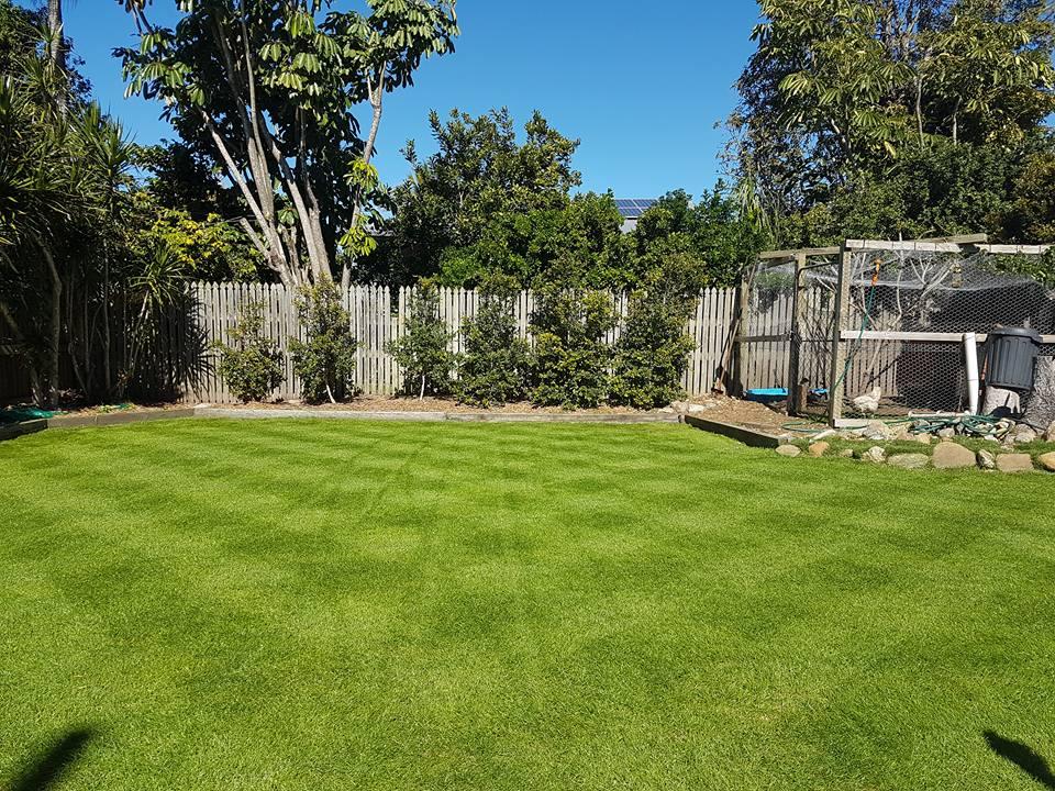

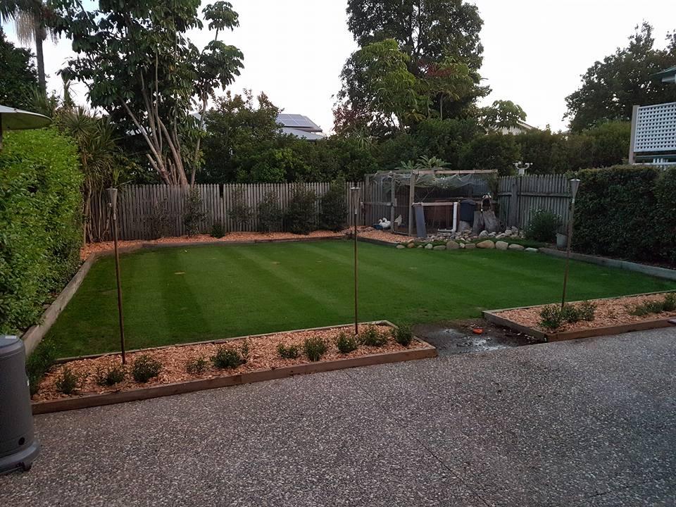

Hey guys I'm a bit random when it comes to lawns I'm constantly changing my back lawn because I get bored of the cultivar and as is the nature of my work (I'm a turf researcher for the Sports Turf Research Institute - STRI) I'm always looking for the next best thing and something different to look after. At my place I have Zoysia matrella (ShadeTuff) heavily shaded and mown at an inch, palmetto inside my fence out the front and out the back I am constantly changing the turf.
I have tried many different methods (seeding and sprigging) and all have been successful in establishment, to give you an idea what I have had on my back lawn in the past 4-5 odd years.
Aussie Blue couch planted as runners (Struggled with shade) and had to mow high with a rotary.
Sprayed out and seeded Princess 77 couch @ 10g/m2 (Struggled with shade)
Perennial Ryegrass and Chewings Fescue oversown at 4kg/100m2 over Princess 77 in the cooler months (easy to take through a Brisbane winter, struggles with heat and humidity as soon as it gets to early October unless on preventative fungicide treatments and syringing daily to cool the plant. Also note the pee marks from my blue cattle dog.
Had the large tree removed in my backyard as it snapped halfway up the trunk in a big storm. Sprayed out rye and used scarifier to bring couch back in that summer and following winter overseeded with RPR ryegrass.
Brought couch back in over summer and this winter I'm trying a mix made mostly of Kentucky Bluegrass with some ryegrass and creeping red fescue
The ultimate question was, what cultivar should I put in? I'm going to spray everything out this spring/summer and just stick with one grass and never oversow with a cool season as I'm over the work (I do it all day as a job and don't want to do it out the back when I get home from work all the time anymore). I have cut down the tree out the back so I now get full sun. Also we don't get the dormancy that you guys down south get; our average minimum temps have barely dropped below 13�C this winter. So I was thinking of sprigging a warm season cultivar most likely Santa Ana but then I changed my mind...
I'm now steering clear of that as I don't want to be smashing it with fungicide once we get our humid summer (seems to struggle with Pythium sp. on my research plots along with a lot of its seeded and vegetative competitors) so I was going to seed QLD Blue Couch (Digitaria didactyla). Once more I don't have to invest in a grooming reel for a Scott Bonnar conversion as you don't need to groom with QLD Blue couch. Has anyone tried seeding QLD blue couch before? I have only ever grown it from sod, plugs and runners. I have maintained it, read a lot of info on it and done spray trials on Blue Couch but have struggled to find any information on seeding QLD Blue Couch other than vague seed company guidelines. Any help would be much appreciated.
I reckon some of you reel mower lovers down south; particularly Sydney, would love QLD Blue Couch for your lawn as it doesn't thatch, even when mown without a catcher. Its relatively drought tolerant, quite similar in management to the green couch and green couch hybrids but it stripes up so much more easily. It is a lot more disease tolerant particularly in humid areas compared to the couches as well and once more its not rhizomatous which means it only runs from stolons (i.e on soil surface) which means if you keep a nice clean edge it doesn't run into your garden beds. The only factors it misses out on is the cool tolerance (which is why it is awesome for Brisbane) and its poor herbicide tolerance to selective grass herbicides like DSMA (which if you use pre-emerg right isn't a big deal).
Any help on seeding QLD Blue couch would be awesome, and if anyone wants any info feel free to give us a yell.

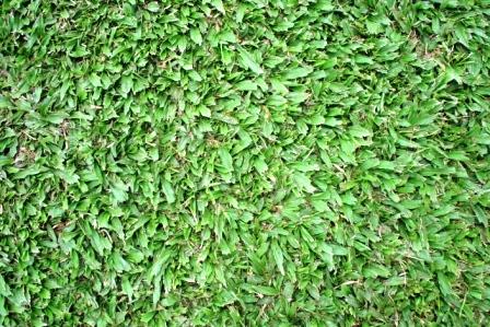

Carpet Grass forms into 2 main species: Broadleaf Carpet Grass (Axonopus compressus) and Narrow Leaf Carpet Grass (Axonopus fissifolius). People often get confused and call it Buffalo (Stenotaphrum secundatum) (Australian Buffalo) when it isn't and performs quite different in its response to various stresses such as drought etc. In Brisbane you will most likely find Carpetgrass growing in the shade or in a wet/boggy area of your lawn and sometimes quite acidic soil (low ph) (I have seen it growing around the 3-4 ph mark in North QLD and SE asia). If you go up to North QLD it is everywhere. Narrow Leaf carpet grass grows on most roadside verges and invades a lot of community sportsfields up in Brisbane and often gets confused with the weedy paspalums (notatum and dilatatum).
This is broadleaf carpet grass
This is narrowleaf carpet grass
If you don't mind it that's cool (I have seen it reel mown on fairways in SE asia its called 'Cow Grass') and it looks sweet. If you want to spray it out and you have green couch use DSMA or MSMA but if you have a blue couch lawn these will kill it. For Blue Couch use Bromoxynil (this may or may not work I have read it in a paper before). The other options are hand weeding or non-selective herbicide (round up) and growing in what you desire. Remember though most lawns are not a monoculture from the environment and cultural practices they are placed under. Weeds can often paint a picture as to what may be happening underneath in your profile. I.e your soil may be compact, pooling water on the surface making it conducive to the Carpet Grass Growth.
