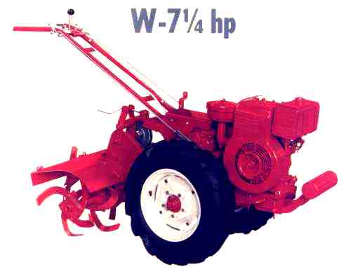

G'day all,
Interesting jigger you have there, Red Amor. Looks to be a 'Model W 2-wheel walk behind tractor', going by that model number. As CJ says, a photo would be very helpful.
It seems that in the US, these were marketed as a powerhead unit system, with quite a variety of optional attachments - rotary, sickle bar and reel mower decks; snow thrower; fixed tyne cultivator; dozer blade; disc and single furrow ploughs; rotary tillers; sulky seats combined with a lawn roller or cart; and a rather scary 20" circular saw. Pics of these are on THIS webpage.
The Owners Manual/Parts List for the powerhead unit can be downloaded from:
http://bsintek.basco.com/BriggsDocumentDisplay/heCBEN8ctO3rE3CSl5kbp796Dq.pdf
The lever on the LH side is the implement drive clutch, as the RH one is the wheel drive clutch. Both act on idler pulleys, to apply tension to the respective drive belts. It is apparently not used with the rear-mounted rotary tiller attachment, if that's what you have - only with front-mounted driven attachments like mowers.

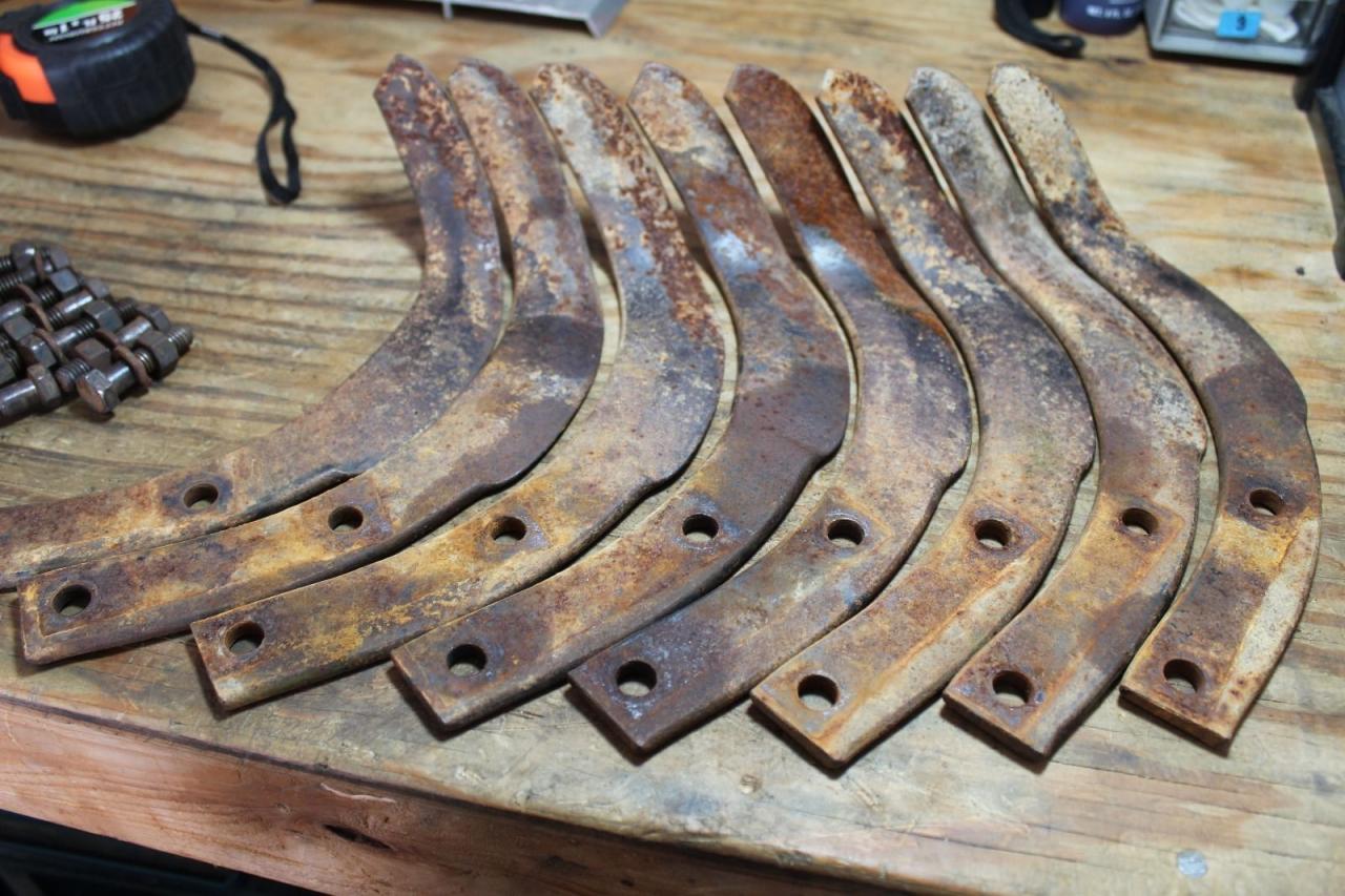

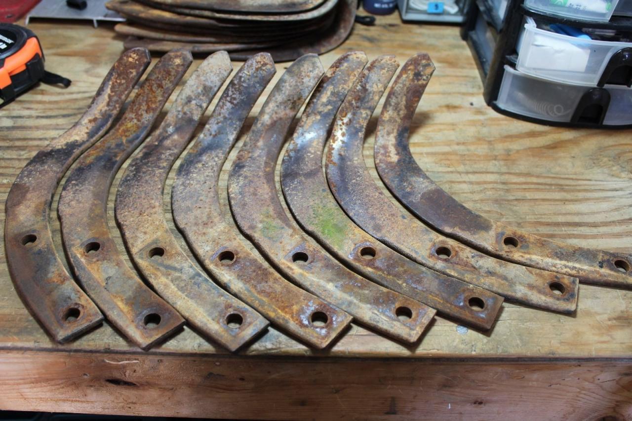

There is a separate Operator Manual/Parts List for the 32" tiller attachment, model 990191, which fits the Model W tractor.
It's here:
http://bsintek.basco.com/BriggsDocumentDisplay/heCyEN8ctO5rE3CSl5kbp796Dq.pdf
This at least shows the drive belt setup [and that there's no idler pulley on the tiller belt], and has the two [LH and RH] tyne blade part numbers to look for. It looks like these are still available in the US, but I don't like your chances of finding any locally.
Pics of a used set, pinched from FleaBay US:
