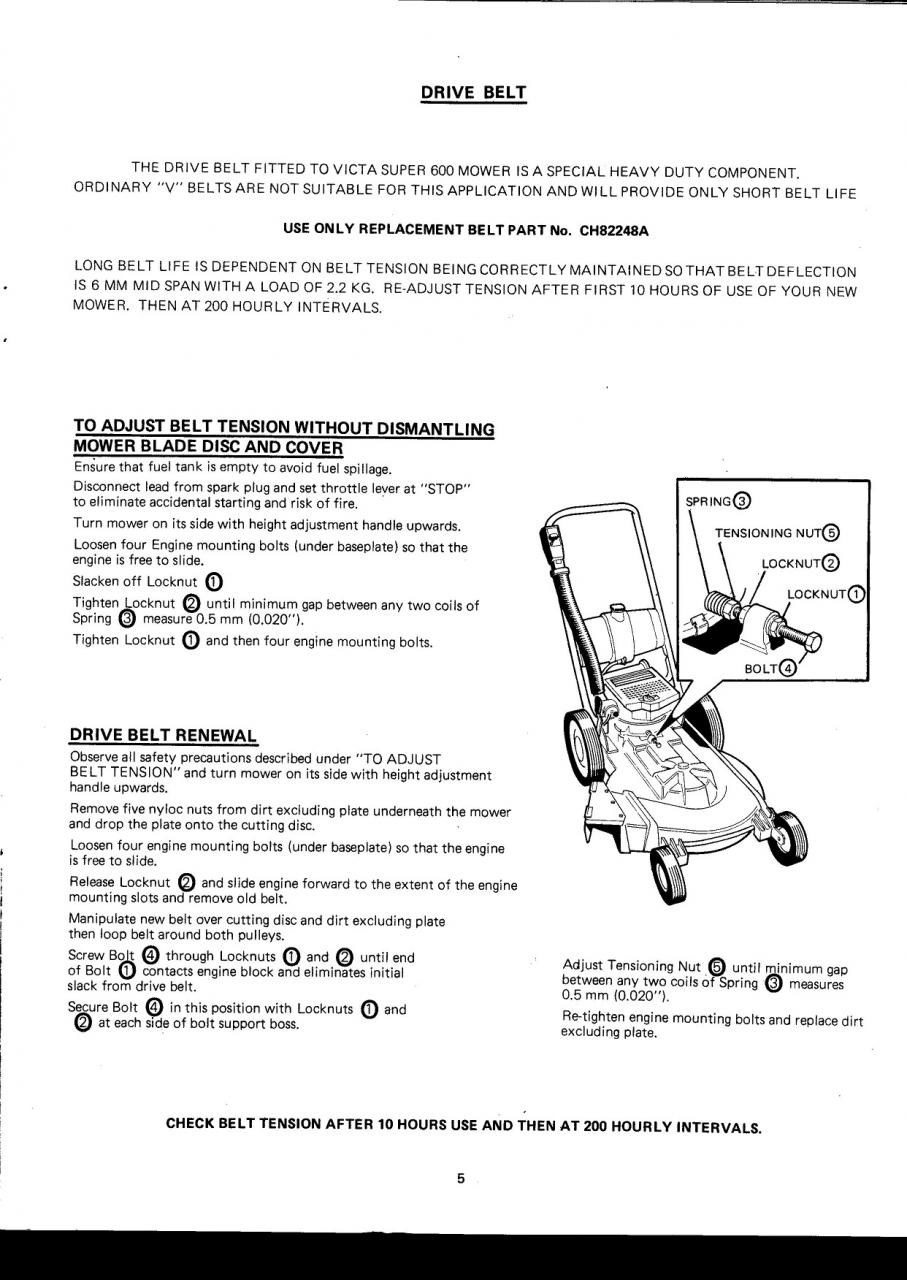

I have had a lot of trouble myself finding out exactly how you should tension the belt for Super 600 & Super 24 models, after working on one, and finding that I could not get it to output power correctly, at first i thought there was engine issues, but over a successive number of engines I found the exact same issue persisted, leading me to think I had the belt wrong. I think I might well be able to get this Super 600 working now, and back to it's extremely patient owner who has been more than happy to wait and see how this all goes (One of our own, etal from Bega) Even though I had tried a number of different tensions, it seems I was still doing it wrong, according to this, the bolt should not actually be pressing into the surrounding washer, so I'm going to try out this tensioning guide myself, and report back once I have the results!! It may be a few weeks, as I am currently needing to move house again, but keep your eyes here if you want to know how this goes! Here's the bulletin: ![[Linked Image]](https://www.outdoorking-forum.com.au/forum/uploads/usergals/2012/08/full-5013-7370-241.jpg)

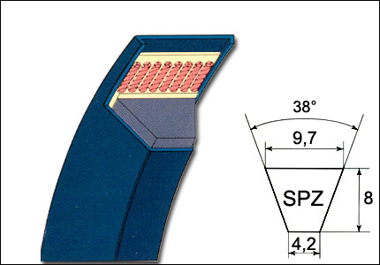

Hi all, RE: Belt for Super 600 Mower The correct genuine belt for the Victa Super 600 mower is a CH82248A (11M1150) 11mm x 7.1mm x 1150mm I found a replacement belt nearly the same specs but cheaper. I have just installed it, it�s a SPZ1140 (SPZ1140/LW) 10mm x 8mm x 1140mm, it will be interesting to see how long this belt lasts compared to the original one. Hope this helps someone.  John

Hi all, RE: Update on Belt for Super 600 Mower The correct genuine belt for the Victa Super 600 mower is a CH82248A (11M1150) 11mm x 7.1mm x 1150mm Just searching on the net, i see you can also buy a SPZ1150 10mm x 8mm x 1150mm which is closer to the correct size, i used the SPZ1140 belt because that was the closest belt size the local supplier had in stock. Hope this helps someone.  John

Hi all, RE: Specs on Belts for Super 600 Mower The correct genuine belt for the Victa Super 600 mower is a CH82248A (11M1150) 11mm x 7.1mm x 1150mm Specs on the SPZ & 11M series of belts. (SPZ1150 1150mm & 11M1150 1150mm) Hope this helps someone.  John

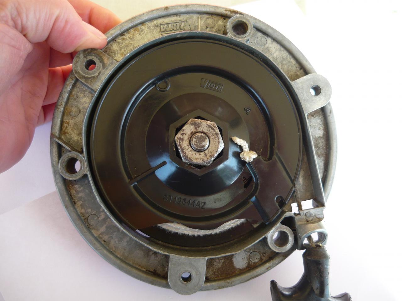

![[Linked Image]](https://www.outdoorking-forum.com.au/forum/uploads/usergals/2016/06/full-10304-28747-super_600_pulley_damaged.jpg) Hi all, RE: Correct Tension on Super 600 Mower Belt This is what can happen if the drive belt is not tensioned correctly. Be Careful !! Hope this helps someone.  John
Posts: 6,938 Likes: 322
The engine normally turns CW to start, but it can start CCW (in reverse) and pull back the starter cord & damage the pull starter pulley (cracking it), and worst pull your fingers/hand back into the engine. This is because it needs to have the spinning motion (centripetal force) of the blades/blade holder plate in the right direction (CW) to start. G'day JohnWell that is news to me - that the engine can start CCW - and do this! Great information to members for belt replacement and tensioning. -------------------- Jack

Hi all, RE: Belt Tension Super 600 Mower Quote: "The engine normally turns CW to start, but it can start CCW (in reverse) and pull back the starter cord & damage the pull starter pulley (cracking it), and worst pull your fingers/hand back into the engine. This is because it needs to have the spinning motion (centripetal force) of the blades/blade holder plate in the right direction (CW) to start." Correction: "Centripetal Force" should read "Moment of Inertia" Hope this helps someone.  John

Hi all, RE: Victa Super 600 Belt Tensioning Here is a copy of the correct procedure for Belt Tensioning on a Victa Super 600 mower. ![[Linked Image]](https://www.outdoorking-forum.com.au/forum/uploads/usergals/2016/06/full-10304-28898-super_600_belt_tensioning.jpg) Hope this helps someone.  John
