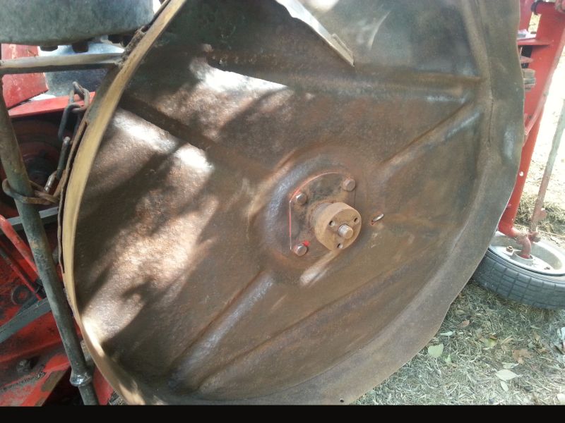

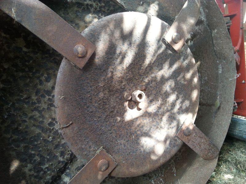

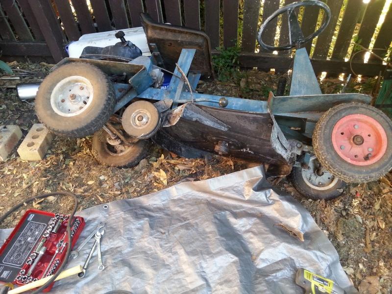

Here are some pix of the rust conversion I did under the deck. I used a sanding wheel on a small grinder and then Septone rust converter. Odd that the cutting disc bolts were an easy fit but the rest are a tight sizing. Actually, that's the other mower I bought for spare parts. The one I'm working on today is the blue one.

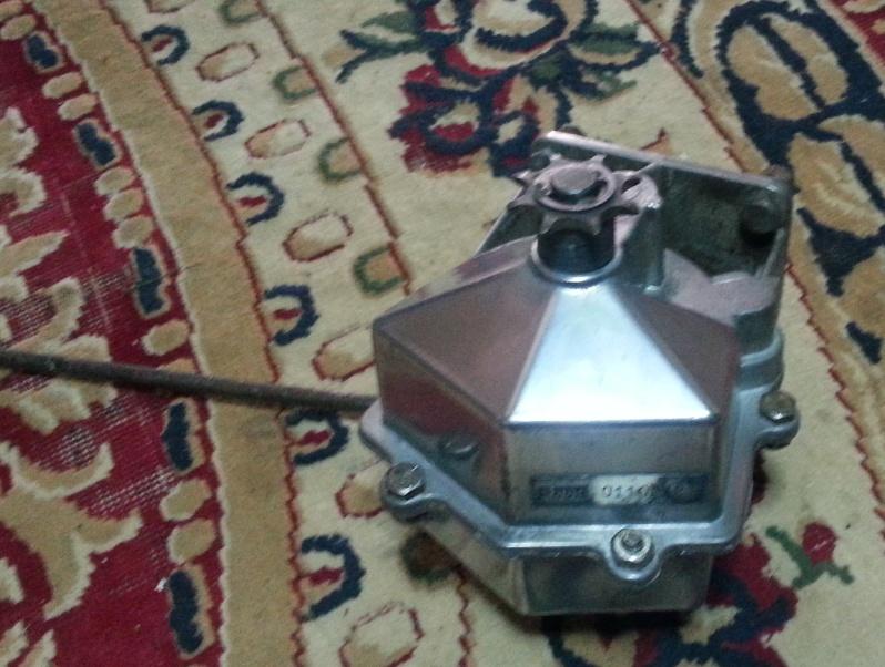

You might regret saying that, here, I've been working on a spare gearbox, 1200 wet n dry to 2000 and then a rub over with autosol. No need to go inside it as I was told it was freshly serviced.

Change of plans, am restoring the blue one and the red one will be a pile of spare parts.
Waiting on a new seat, will repaint motor matte black

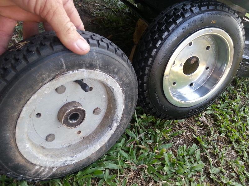

Am polishing the rims too.
Will refurbish the tires with some black I bought a while back

That wheel came up a great. Did you use rogue and a rag mop? How did you remove the oxide first? They'll look like mini mag wheels!
This
Joined: May 2016
Posts: 26
No, paint stripper followed by progressive sanding with 80 wet-n-dry, then 180, 360, 800, 1200, 2000 followed by hand polishing with autosol. It's not finished yet but after a final polish and sealing will look like that. I'm doing the next rim with a synthetic polishing mop then auto sol but this one I screwed up by using a rotary sander that was too course. Once they are shiny as I'll apply Wattle Incralac to seal them.
The paint is a bitch, I thought it was anodizing at first but when oven cleaner wouldn't remove it I figured it for what it was.
