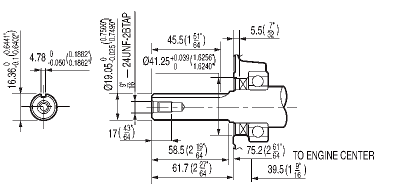

Llew, Just one thing about the Honda GX120, you'll need to order it with the 3/4" imperial PTO shaft, not the 18mm metric one.
The Kirby PTO shaft size should be 3/4", so the old clutch half will fit.
Cheers, Gadge
Posts: 8,210 Likes: 234
Gadge is 19mm 3/4"
/itm/HONDA-GX120-ENGINE-BRAND-NEW-GENUINE-KEYED-SHAFT-19MM-PICK-UP-OR-POSTED-/321943243680?hash=item4af5500ba0:g:5t8AAOSw14xWPGsm
Posts: 1,842 Likes: 14
G'day Norm, Close - 3/4" is 19.05mm. Honda designation is 'Type Q' PTO, as per their drawing below. ![[Linked Image]](https://www.outdoorking-forum.com.au/forum/uploads/usergals/2016/05/full-5630-28559-gx160_200_shaft_q.png)
Cheers, Gadge
