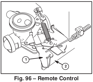

Are you sure you are actually getting minimum throttle because that cable in the first picture looks pretty dodgy. It is not at minimum throttle in the picture but then I don't know where the control lever is set at the time of the picture. The throttle butterfly cam should be against the little extrusion on the carby body and the throttle control lever against the raised area to the left just under the spring at the stop position of the control.
+1 to aussietrev on that cable - I'd say it's not moving the governor control lever [part 1 in the diagram below] through its full range, particularly at the idle end. It doesn't look like anything is bent out of shape on the lever, though.
Single spring [i.e. idle is not governed] is correct for that engine, as in this diagram from the Briggs #270962 Service Manual:
