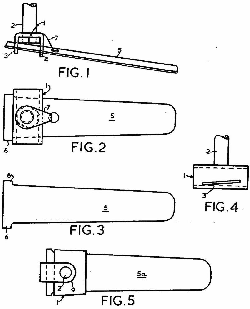

The other feature of note is the �Spring Retaining Element� shown as Item 7 in FIG. 2
from Patent 62525/60. This clip is described as being an �auxiliary securing means
for the fitment of new blades and avoiding their being displaced until more securely
located in the slotted portion � [by centrifugal force]�
This was clearly a well-throughout system, and obviously, profits would continue
with the special replacement blades needed for the system. Note, though, that this
system was designed just for Victa cutting blades that were affixed using �washer
caps and felt washers� � meaning Victa mowers designed the previous decade (1950s).
It was fortunate that the patent was found and it makes for an interesting read
of the concept. The patent is available for download below. The next part will discuss
the other system, the Quick-Lok.

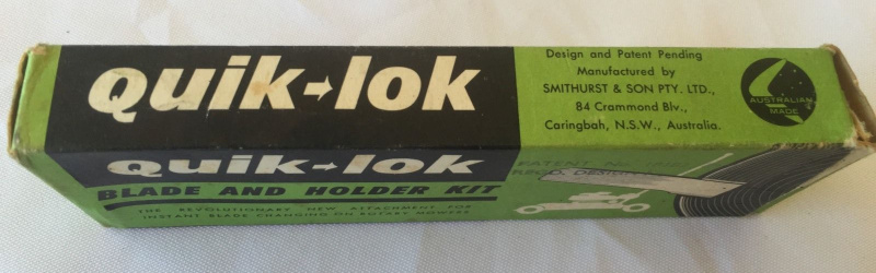

PART THREE - The Quik Lok - c1962
This system was covered by Patent number 18182 of 1962 and manufactured by
Smithurst & Sons of 84 Crammond Boulevarde, Caringbah.
Similar to the earlier Quick-Change, this system employed a taper to lock blades
quickly in place. Unlike the Quick-Change, this system appears not to have used
any angle of attack (Updraught method). Also, instead of a separate spring retainer,
this system used �safety lugs� built into the proprietary blade shape itself.
Also of note, again, is the limited application � flat blades as used on
toe-cutter bases � the box list covering the early 1960s models � Victa Special,
Standard and Utility
; and the early HG Palmer base as well.
We are very fortunate to have these extraordinary 2016 auction images of new-old-stock, boxed
Quick-lok components. Of note is the detail we have of the proprietary blade design.
