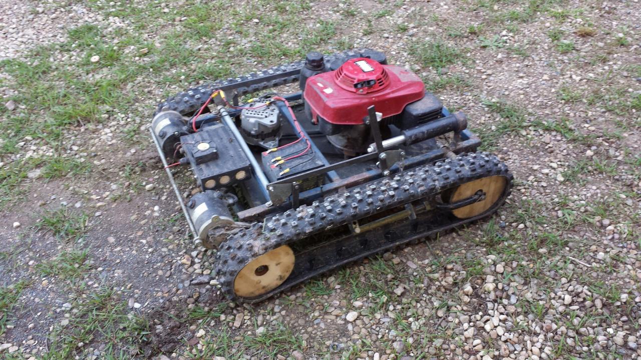

Hi all,
is there a way to increase the output of this engine (apart from raising the speed).
I would like just a little bit more power to tackle steep hills head on.
Just wondering as I really don't want to go to a bigger engine on my tracked mower.

Joined: Mar 2016
Posts: 39
Hi Norm,
it's hard to guess how much more power I need.
This engine was a donor from my next door neighbour (Jims Mowing franchise).
It starts first time everytime and does not blow smoke. I am unsure of how many hours this engine has done but guess being commercially used it would be heaps.It might just be too tired to make enough power.
You are correct in saying it only drives the alternator and blades however , the alternator then makes power for the drive motors and our property is very steep.
Might have to look at a larger capacity engine to suit my application.

Joined: Mar 2016
Posts: 39
Aussietrev,
I am running a pulley ratio of 2 to 1 with Alternator speed around 7200 rpm.
Norm,
Its going great!

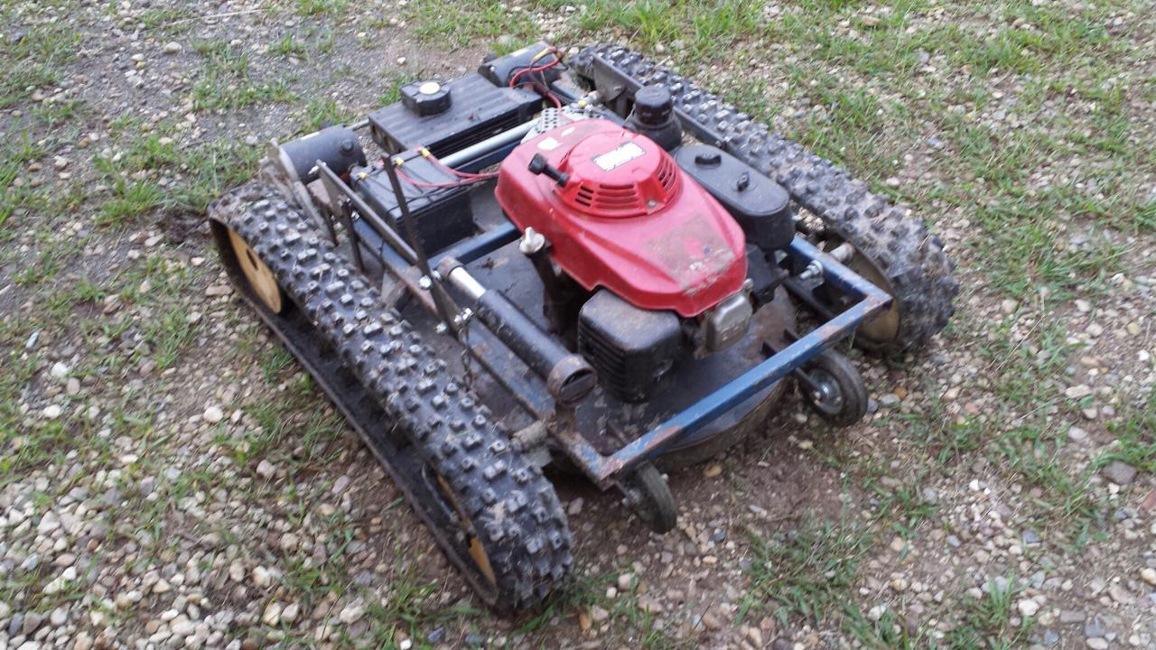

there was room for improvement on the tracks and i am currently trialing a new track system using motocross tires which hopefully will be a lot more maintenance friendly then the
previous setup. I am also trialing a floating deck and new height adjuster ( an old gas strut from an office chair).
The batteries are always fully charged before each start by design.
The travel speed is constant but the engine tends to bog down on steep hill-climbs, that's when i back off the travel speed until the engine revs come back up.
Maybe it has a governor problem or as mentioned before is just too old and tired.

What a beautiful machine, the best of Aussie ingenuity, well done. So obviously the alternator is working very hard because the drive motors are really sucking the power and this is loading the Honda right up. How thick is the grass you are cutting?
Joined: Mar 2016
Posts: 39
Hi Norm,
2 weeks worth of growth in Qld does add up to a generous height of grass however, even just driving it up the the slope with the deck raised to its highest point will cause it to struggle.
I think in future I will start on the top of our property and work my way down side to side rather then up and down.
