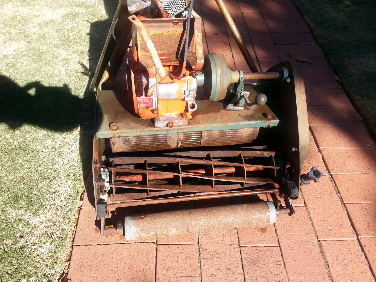

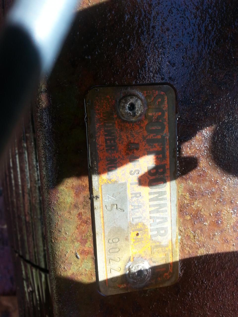

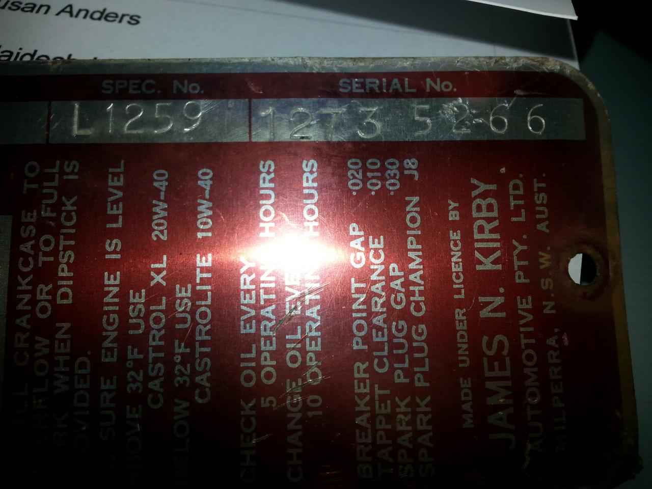

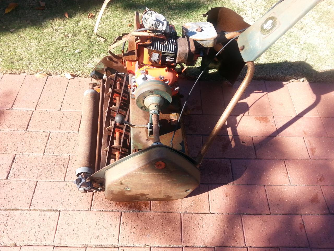

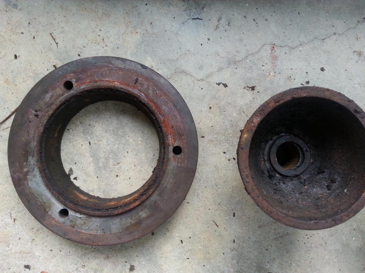

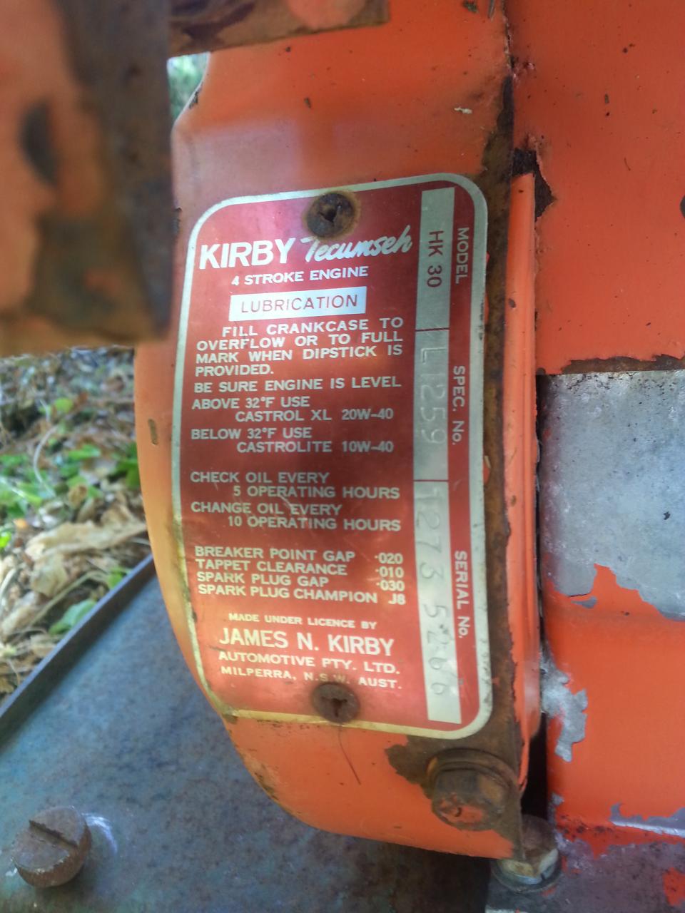

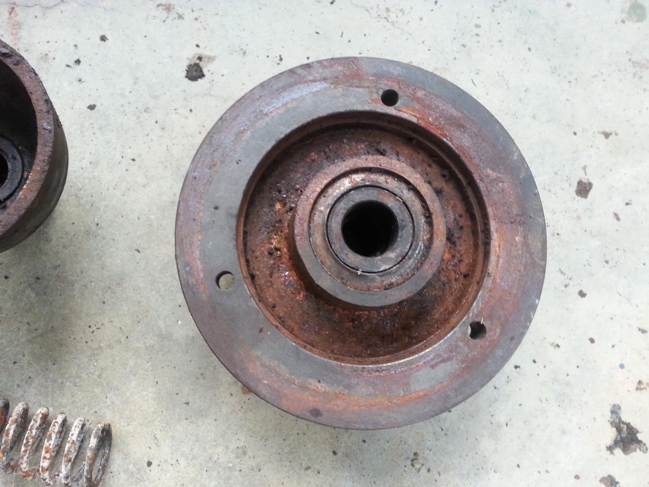

HI guys, I'm a lawnmowing contractor in Adelaide. I've always wanted to restore a Scott Bonnar mower.Recently I acquired this. A 20inch mower with a Kirby motor, which is cactus. Happy to replace it with a new Briggs. I have attached some pictures and ID plates. Engine plate HK30 L1259 Serial no 1273 5266. Plate on the mower body is 45 90225. I have removed the motor and the clutch assembly, thanks to the fantastic tutorial on the web by you guys. Basically, can you tell me the history of the mower, when it was made etc and if in your opinion{s} if it is worth restoring to its former glory. Many thanks Llew

I believe this is a 450431 - an early (first model) single deck, I
guess was made between 1968 and 1972. Well worth restoring!
A History Record is available here:-
https://www.outdoorking-forum.com.au/forum/ubbthreads.php?ubb=showflat&Number=64933
Hi Llew,
Well you've managed to get the best of the best of the Model 45.
Firstly it's a 20 inch machine, which are pretty hard to come by and secondly it's as Mod CJ has suggested an early Series 1 unit which makes it the strongest of all the 20 inch model 45's made, also it has the superb 3 piece rear roller, which was later deleted as a cost cutting exercise.
One really strange thing about this machine is that some previous tenant has changed the front roller from a 20 inch unit down to a 17 inch version, not that smart to be truthful. This may be an easy rectification by removing the roller and disassembling the three pieces and replacing the tubular section for the correct length and then re-riveting the end caps back onto the new tube.

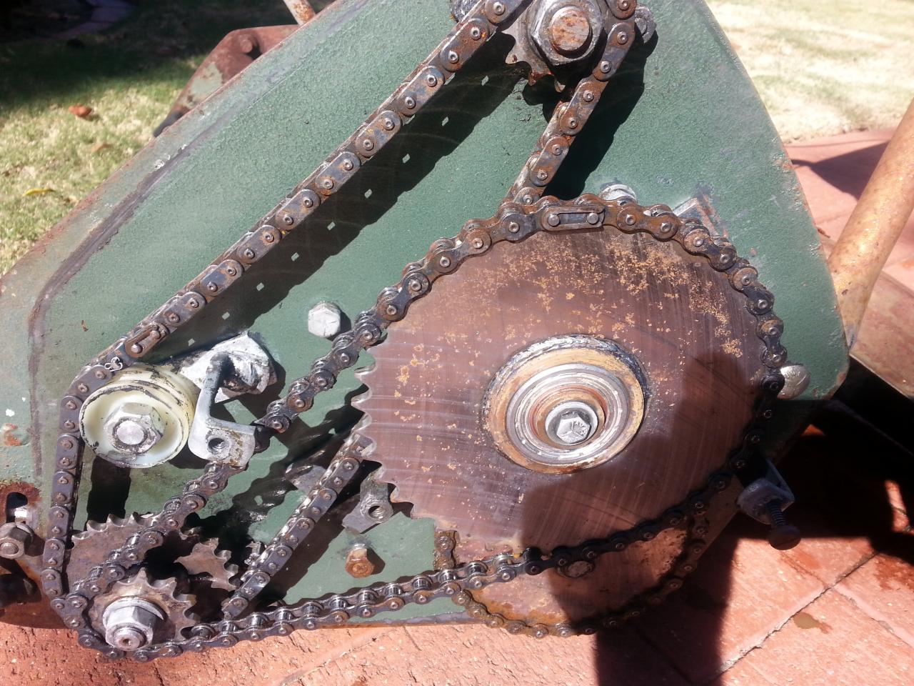

Your machine certainly looks like it's lived in a rather damp location for a while with rust being evident in quite a few concealed locations, but don't let that discourage you as this is all superficial.
Your sprockets are still quite serviceable at this point so there's no need to spend big money in that area at the moment.
I guess I have to ask what your intentions are for the future of this machine, restore it as per original or refurbish it to a reliable and useable machine to use in your contracting business. From there I can advise you much better.
Yes the Kirby is due for hoiking and replacing it with either a new 3.5 HP Briggs & Stratton sloper unit or even better a Honda power plant.
If you are going to dispose of the old dilapidated Kirby engine I'd be happy to accept it for placement into the bone yard that I have which helps out many Adelaide ODK members when they get into strife and require spare bits as Kirby motors have no parts availability apart from new carby's from China. As I can see your engine has already been quite ravished of many components, eg. Fuel tank, recoil starter etc.
Anyway let me know how you want to proceed with this mower and I'll only be too happy to help out. Also being that we are both in Adelaide I'd be able to make a home visit if you get into strife as I've done for many others.

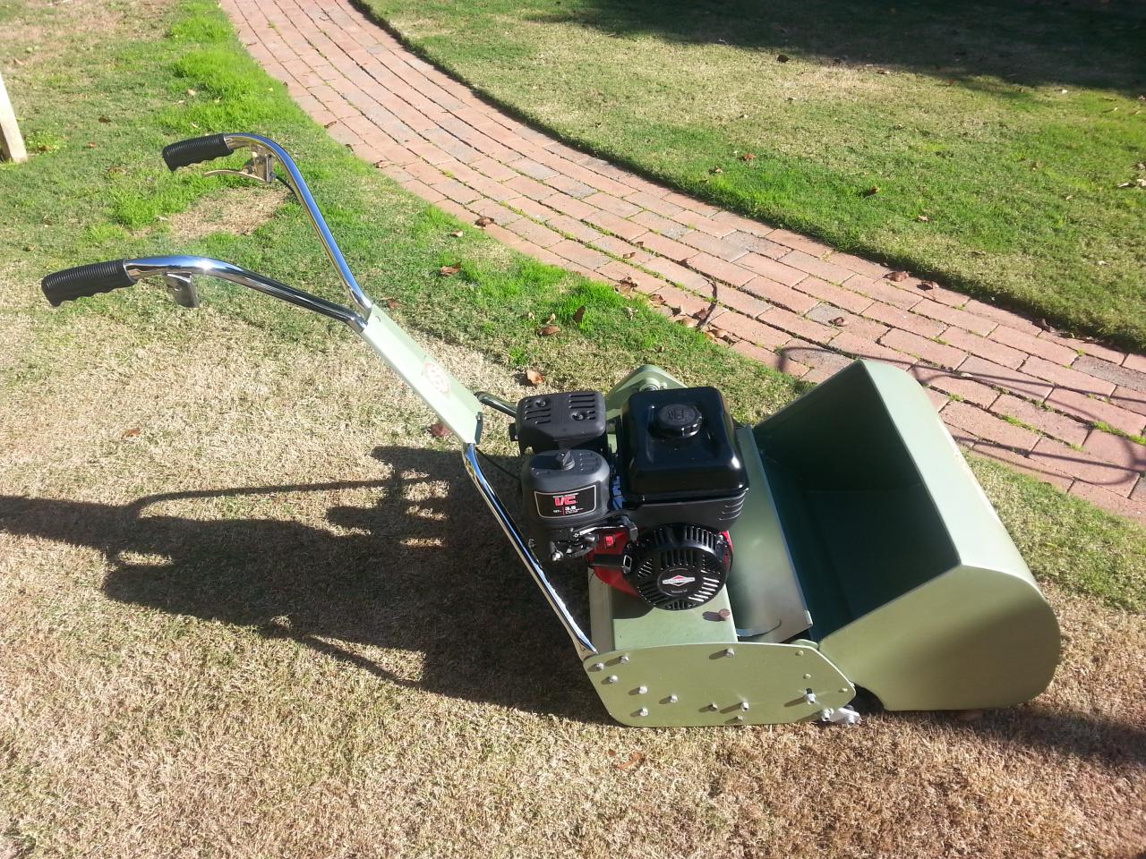

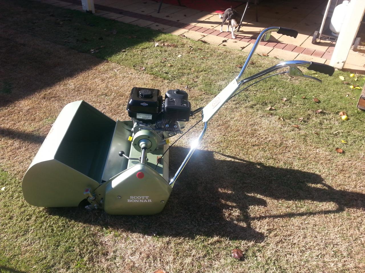

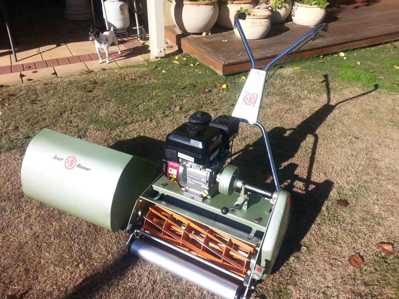

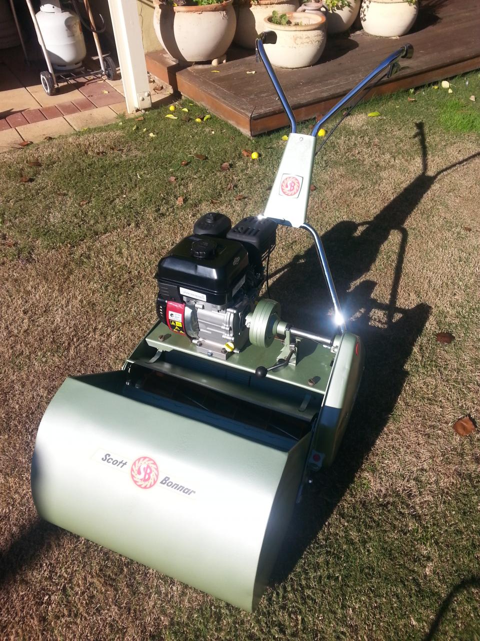

Gentlemen, Today I finished restoration of my Scott Bonnar 45. I have replaced, cleaned, re-sprayed every part. I have reused any parts possible. Highlight has been re-chroming of handle bars. Expensive...but so worth it. Fired her up today and cuts like a treat. So from 1969-71 to 2016. Most parts just needed a good clean up. Which proves my point that we as Australians could and still can make quality products from the ground up.
Thankyou to all the Gents on the forum for your kind and patient help, from the cotter pin to the engine. Could not have done it without you!
Thanks Llew

Hi Llew,
What a Fantastic transformation, well done.
cheers2 John
Hi Llew,
WOW !!!! Another fantastic outcome here by an ODK member, you "BLlew" me away.
Yes re-chroming is certainly a huge bonus to the final result.

I have moved this one to Restorations as the projects is complete.
Thanks to Llew for giving the record great photos and text of the resto.
And whenever a photo is taken, a dog will want to appear in it. smile
Model 450431 S/n 90225 has a new life.

Thanks guys. I really enjoyed this resto. I may do another one for each of my sons. I used Delway Brass in Edwardstown for the chroming. Cost was $385 inc gst. I,m glad I did not cut any corners with this as it is the highlight of the machine.
