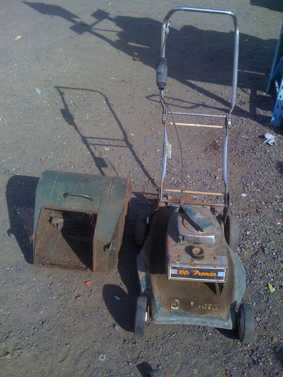

After missing the Masport I consoled myself finding this one. It was pretty complete: Only thing I notice missing is the air filter + air pipe. Wheels roll fine, much better than Eric.
Alloy base with some damage (small holes, guides missing chunks underneath) can be my strip, fix and repaint project I suspect.
The Victa logo was completely covered with the dirt- needed to use my foot to find it!
However it says 160 Premier on the motor front and I cannot recall (nor google find) a Victa like that? The base has both a side chute and a rear catcher. Is this possibly a corvette base with an engine off something else ???
The impulse starter was under tension, I would it slightly more and it tightened but no ratchet noise noticed? Cleared the space, checked the blades and pulled the trigger...engine turned over and sounded like it had compression!
Any help gratefully accepted, more photos later when I clean it on the weekend.
Patrick
looks good too . should have a green airfilter yes , same as the bracket thingy you see clamped on lower handles , chrome dress coweling looks to be the same as corvette so just the sticker you can change even the chrome parts look to be ok so for and catcher looks almost mint !
whats the bits in the catcher hope its the side trimmer cover ? hard to find now but i know of a few about the place . the side chute was for cutting upto the edge not really was a chute but i know some will argue wink good luck with it , they do up sweet maybe just a points clean is all it needs and carby too ..
good1
Psssssst .......... most premiers were some sort of store branded machines , samo samo though , just a different sticker/decal wink

Cleaning today- trying CT-18. Photos later. Base has several "ventilation holes" in it...sounds like I get to practise with JB-Weld... grin
Is this likely to be the famed "avocado green?" Some fresh paint in places, esp under 30 yrs 2-stroke+dust coagulation & inside the starter arm.
Original fuel tap + fuel pipe I think. Tank relatively clean (can see shiny metal). Champion spark plug. What appear to be original wheels + covers. Side trimmer cover there, not attached.
Catcher intact, but surface rust in areas, paint thinning.
Patrick

I'd seen one or two "Pace premium" images on google. This mower threw me as it looked (to me) original.
So
Pace-labelled (Victa still?) engine + Victa Base = Bitsa. Oh well. Still it looks cool (to me).

G'day Patrick,
Originally Posted by Pitrack_1
Thanks for the warning about CT-18. But was wondering if you've mixed it up with alloy wheel cleaner/degreaser which is strongly alkaline or CLR which is acidic? My bottle of CT-18 explicitly states "pH neutral". There are also no warning symbols and it pretty well states it's benign. Not even a "use gloves" on the bottle.
Nope, I do indeed mean CT-18. BTW, the MSDS for it quotes a pH range OF 7.5-8.5; 7.0 is neutral. So it's not very alkaline, but it's definitely not neutral, despite their claim.
This long-term corrosive characteristic of the stuff is one that's caught out the unwary [particularly trailbike owners] for some years. It's only a serious problem where 'cranny traps' exist, such as the examples I gave. But the corrosion it causes to aluminium is of the nasty 'exfoliation' type. Just what you don't want in the spoke nipple dimples of alloy wheel rims, as it propagates outwards from the spoke hole, and thus weakens the most highly stressed points of the rim first.
Maybe CT-18 ain't what it used to be anymore?!
The oldest MSDS I could find online was dated 2005 [ http://www.oztrampolines.com.au/pdfs/ct-18msds.pdf ], and the pH spec is the same as the current MSDS on the Chemtech website. So it doesn't look like the formulation has changed in that time.
BTW, the MSDS does advise to 'avoid contact with skin and eyes'...
Joined: Aug 2015
Posts: 202
Yes Gadge I did rethink after I had posted...wondered about a salt effect. I suspect when the water evaporates out and the solution concentrates it can then attack, probably hygroscopic so absorbs water from atmosphere to continue. It did say that it works well when allowed to dry!
I'll remember not to use it on my bike wheels.
Was going to look up the SDS, hadn't got around to it yet. Thank-you.
Was going to experiment with some other cleansers I've had experience with previously. Hence the need for a 'guinea pig' machine. Already wish I had a whopping great ultrasonic bath to chuck things in!
You're all probably scratching your heads at me, I'll add some info on my background at some stage so you all understand where I'm coming from- but it's technical scientific.
All you experiences are invaluable to me and greatly appreciated. It's a great world when we can stop certain 'histories repeating'! smile
Patrick
G'day Patrick,
I'd say that the chassis is a 1967-68 Corvette 2, Model 543 if it was a 160cc or 545 if it was a 125cc originally.
The download linked at the top of THIS page is very useful for working these older Victa and Pace models out.
The engine number is from 1967, so it could be the original, just with a Pace front cowl. Or a complete swap from a 1967-68 Pace Premier...
The carby is a 3S, which is correct for the Corvette 2 160cc [but not the Pace Premier], according to the Green Book. Yep, it's missing the tickler. Carby info download is HERE
That fuel cap is missing bits - looks like it was originally a mechanical fuel gauge type, which Victa used for a few years on their top of the line models. Working [or even complete] ones are very rare now. They never did work very well, and were superseded by the optical gauge of the VC series.
Yours looks like it has had some sort of bottle cap shoved into the gauge recess, as a plug.

- And what's the little sector of metal- is it a shield/shroud part from the starter unit itself (pics further down)?
Usually called 'starter cup' now. The 'starter drum' was Victa's term in those days though.
Your Q's: Yes x4. It's worn out. You can see why I warned against using an impulse starter with missing cowl bolts...
Starter base from underneath
- Again, contact from where the base has touched the drum?
- Contact likely caused, I assume, by collapsed shroud bolts?
- Should there be three 'prongs' (dogs?) extending, also is the broken off part likely the shroud around the outside between the prongs/dogs?
Yes to all Q's, once again. There should indeed be three pawls/dogs.
Flywheel
- Basically every flywheel blades seems to be broken- again contact, no doubt, collapsed cowling?
- Contact again can be seen at top of drum(?)?
More like some neanderthal with a hammer has been at work. That isn't the correct cup for a 2-stroke, BTW - that's a Kirby 4-stroke type. And it doesn't engage the lugs on the top of the flywheel, as the correct one would.
Cylinder outside
Probably least of my worries, but
I wonder where all the contamination came from, and whether the engine overheated (and was damaged) as a result.
That's a quite normal crud deposit, on Victa cylinder fins. Dirt and fine clippings always tended to build up there.
Ignition and compression test
Last thing was to test the spark: I pulled the plug and spun the engine, both by hand and by a rope around the pully. I guess I would have simulated a zip-start speed. Even moved the throttle cable, though I can't see any kill mechanism connected. No spark found, darn. frown
But it does seem to give compression, so that's help. smile
No ignition cutout switch on these models, so there must be other problems.
Next steps
- Pull the carby
- Pull the exhaust
- 'ave a look inside
- Pull flywheel (get to test my new purchase )
- Look at ignition
- Examine/dismantle carby
All worth doing.
Conclusion
So my first-off opinion is whilst it may be fixable it's pretty well a write-off from the start. But no matter, that just makes it great to learn on, doesn't really matter what I do to it! grin
So I'll probably pull it apart and try and get bits working anyway. Some may even be salvageable. I suppose if the cylinder's good then the flywheel, magneto, carby etc can be replaced/repaired and it can work anyway, perhaps replace starter with something else.
Already a good learning experience! new lol
That's the best way to regard it, I'd say - a learning experience!
Joined: Aug 2015
Posts: 202
Thanks Gadge,
My learning appreciates your experience! cheers2
Did a bit more today, pulled the carby off totally, exhaust off and had a look inside. Pics to come. To do next is more degreasing/cleaning, pull the flywheel and have a look at the ignition.
The torpedo-type exhaust looks good, feels solid and intact externally so might give it a brush down, lick of rust converter and paint. I assume it's meant to be hollow on the inside? Did shear off the rusted bolt from the fixing ring when trying to remove the nut which was rusted on pretty solidly though.
Had a look inside both the exhaust and carby ports (yesterday) and all looks OK- no major gouges, rings there. But it's actually my first look at an actual used piston/cylinder in-situ!
What I did find was the exhaust port is half-occluded with carbon, the piston will have to travel a considerable distance more (~1cm) to expose the exhaust as a result. I'll have to pull it to dremel/grind the carbon off, a screwdriver's not working, besides I'll damage the piston.
Oh, should the rings be able to move up-and-down in theoir grooves?
Thanks for the info, I had just noticed that the lugs were incorrectly engaged today. But there are three of them and three matching notches so it could have been matched if they'd paid attention. This would also have altered the height of the cup/drum, so Neaderthal is about right. Doesn't bode well for further investigation underneath, does it? smile
Does the N-21 plug sound right, are they available and what would be the gap? (Small engine manual says: consult the dealer)
Yep, that looks right for that engine [north-south orientation 160cc], of that vintage. They are available, but I'd use the equivalent NGK B4ES - better quality, and possibly easier to get from Autobarn, Bursons, Repco etc. Gap 0.025".
Thanks, NGKs have been a favourite of mine for years too so good to know they exist in this size!
Pics to come later...
Patrick
