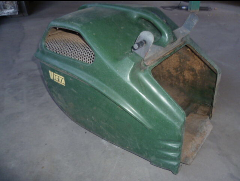

[Linked Image from imagizer.imageshack.us]
Side view of the old girl before she got a good scrub!
Original catcher in the green, showing the 'bull horn' handle bar mounts that I would so dearly love to come across in perfect condition
