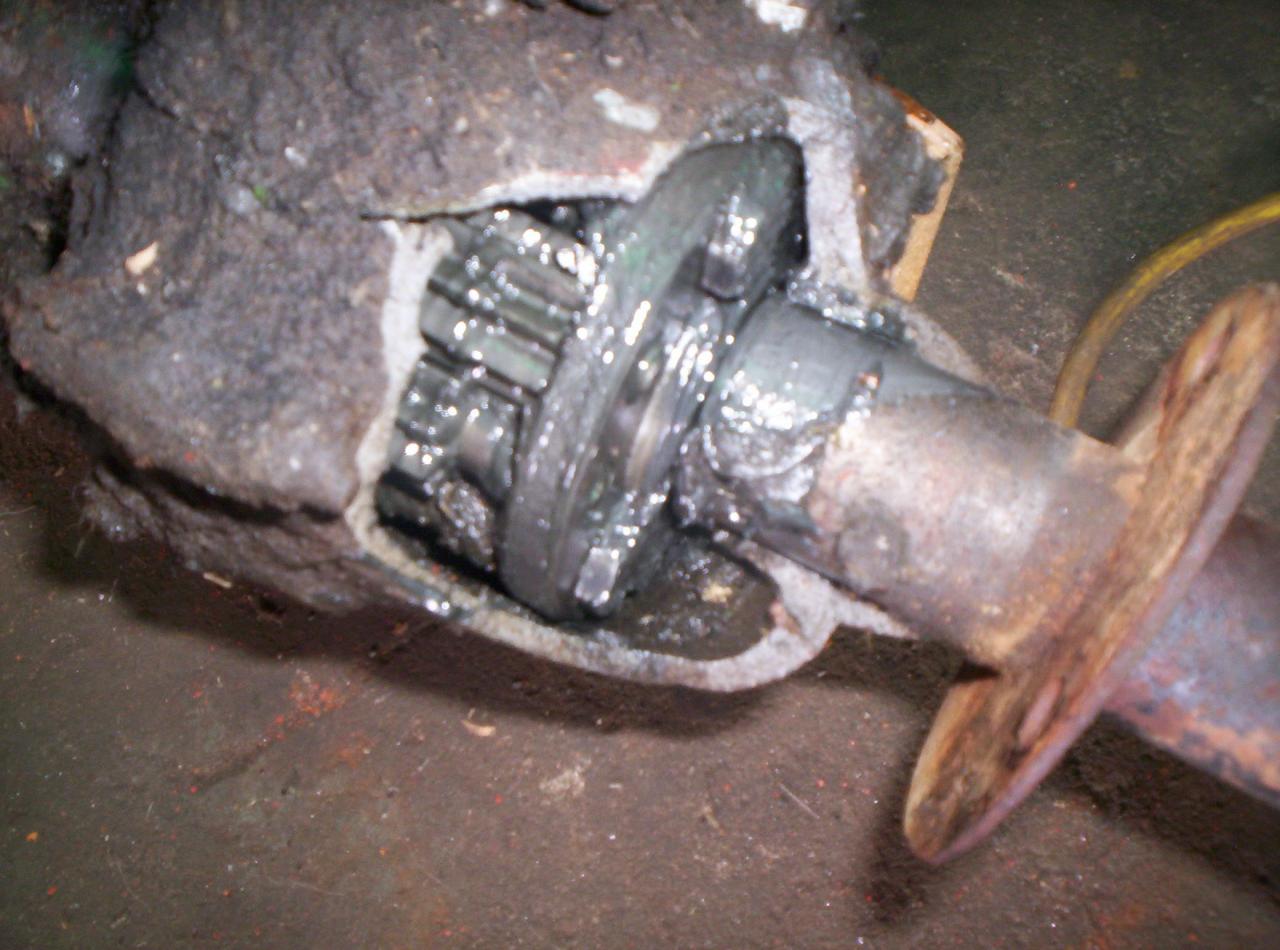

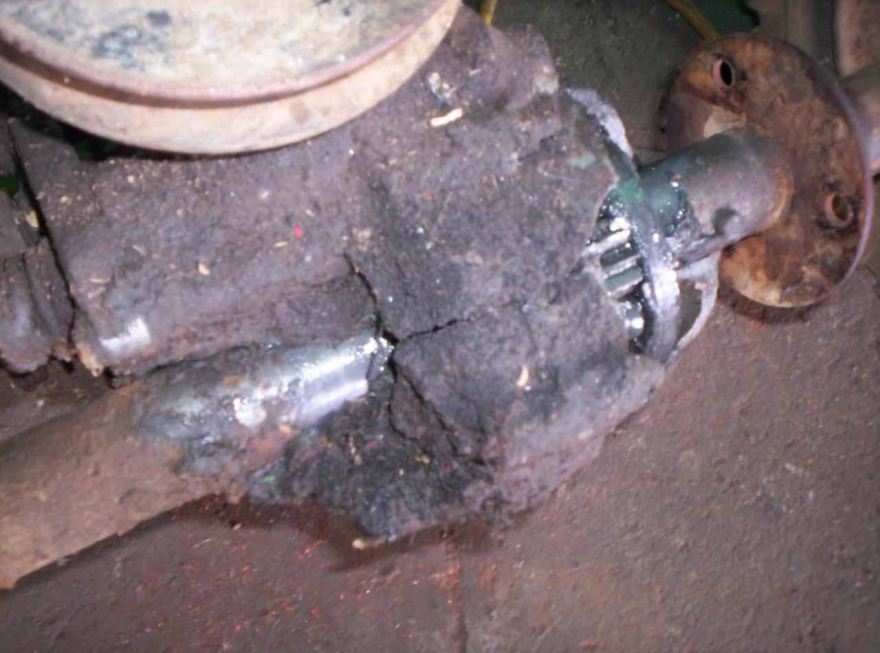

Bit of a problem with the Duetcher, diff housing is split, this may require some little bit of handywork frown at least the Honda motor fired up instantly. They are a tough old machine, built with real steel, be interesting to see what sort of fix I can come up with.
Posts: 387
You can get those welding rods that you just heat up and melt on with the oxy. Not actually welding. I've never used them. Assuming it's an ally housing? If you clean it up squeaky clean a local engineering workshop should be able to weld it up easily enough.

Posts: 8,087
Likes: 221
Slash the welding is not the problem, I would need to find all the missing parts of the case. When I get time I will pull it out and put up a pic, it is ugly smile

Posts: 8,087
Likes: 221
There you go Slash, I know you love pics, I feel it is a bit beyond a welding repair laugh
Daryl, I haven't found any info or label on it. I'll get onto Duetcher and see what they say
G'day folks,
Norm, you were certainly correct about it being ugly! If that's grease in it, I don't think it should be there - AFAIK these always used gear oil.
Deutscher have always made their mower transaxle units in-house; with the exception of their post-1993 ride-on models.
There are some variances, as early SP models just had one or two forward speeds; the late ones have two forward/one reverse.
There was one self-propelled model [the G26] that had a multi-speed variable-pulley belt drive, too.
Norm, have you worked out just which model you have? THIS Deutscher newsletter should help with that.
Last edited by Gadge; 18/04/20 08:04 AM. Reason: Attach copy of Deutscher Mower ID brochure
Posts: 8,087
Likes: 221
Hi Gadge, thanks for that I now know exactly what it is, it is a Model R 360.. Yes that is grease in it, might have had a oil leak at some stage so they stuffed grease in it. Hopefully I can get a new transaxle otherwise it will have to go to the scrap bin. At least the motor is good
G'day Norm,
The transaxle housing halves are still available from Deutscher, but list price is nearly $440 for the pair...
Parts list/manual is HERE.
These machines do sometimes pop up cheap, with rusted out decks.
This past thread has some useful info; https://www.outdoorking-forum.com.au/forum/ubbthreads.php?ubb=showflat&Number=59010
The used parts supplier mentioned there, Terry Scanlon, is still around with the contact numbers mentioned. Just doesn't have anything up for sale on FleaBay ATM.
