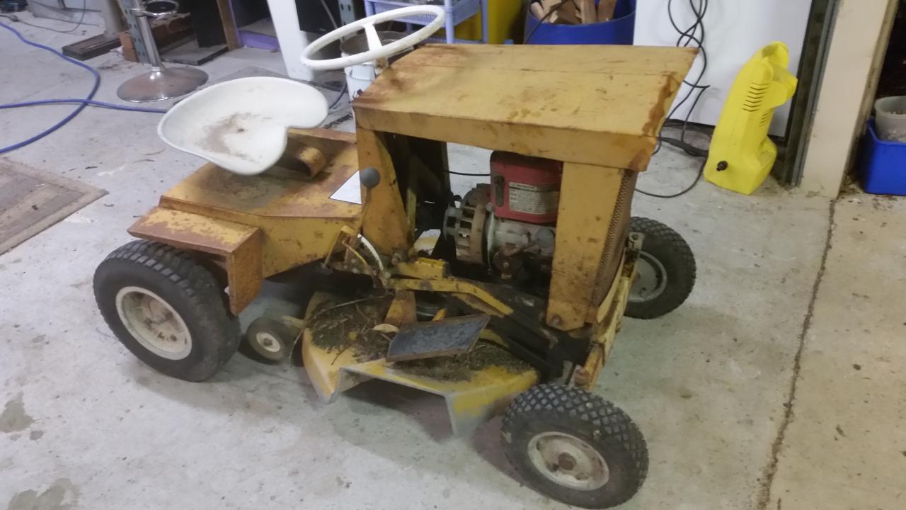

This is my HD8

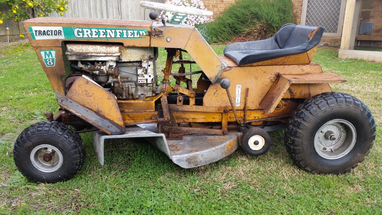

And My mini Tractor 8 75 model

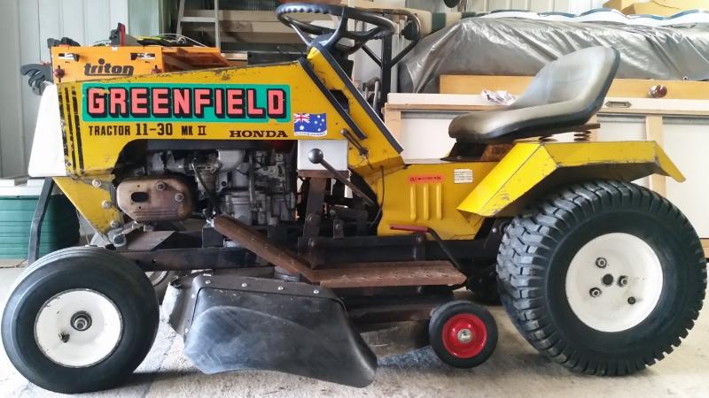

This is my 84 model 11/30.... GV400 Honda powered

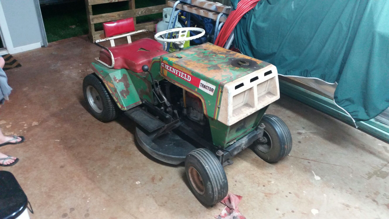

Hi fellas,I've made a quick trip to Swansea (Tas).The old greenie was here waiting for me & fired up with first flick of the key . Here's some pics for you, hope it helps solve the mystery. Hope I've got it right,bare with me.

Fascinating.
Relocate the tank to get a stylish low cowl effect. Why not.
A perfect example of engineering evolution. Assuming the mini tractors were on the market by the time this beast was born as styling replacement for the HD8 (and my guess is that they were), it's not hard to imagine old Theo standing back, looking at the two models and thinking, 'Wait a minute, Why don't we....'
Like super, I desire one.
Now the search is on for an IPC.
Good to see you've got it tucked up nice and warm smile
Posts: 310
hahahaaa the race is on .... yeah, like left over old style fitted into a modern body style of the era..
Good thing with these Greenies is they're Fabricated steel not pressed sheet metal..
can just about remake anything on them..
