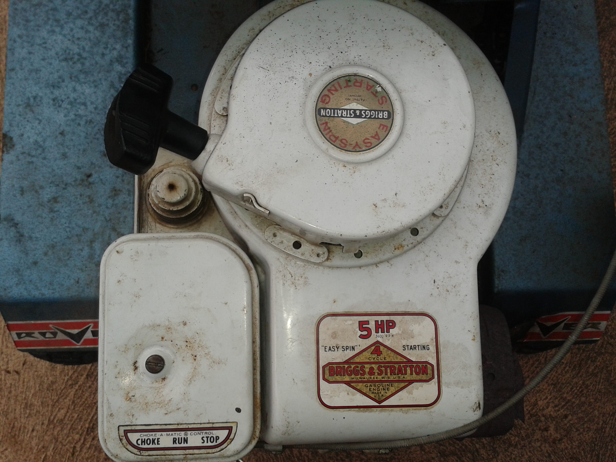

Found rover colt major ride on (model 7313) in pretty mint condition and runs well!
all original decals including briggs n straton 5hp
Dont know what to do with it apart from offloading it.
New here will try to post pics - pic posting tips appreciated
1 member likes this: Mike Bravo

Its a Rover Colt Major
On motor
Model 130902
Type 0521-01
Code 76111507

The Code tells us the engine was made on 15 November 1976. The mower was therefore probably made towards the middle of 1977, allowing for shipping time. The mower looks quite remarkably fine for its age - I suspect it hasn't been used.
