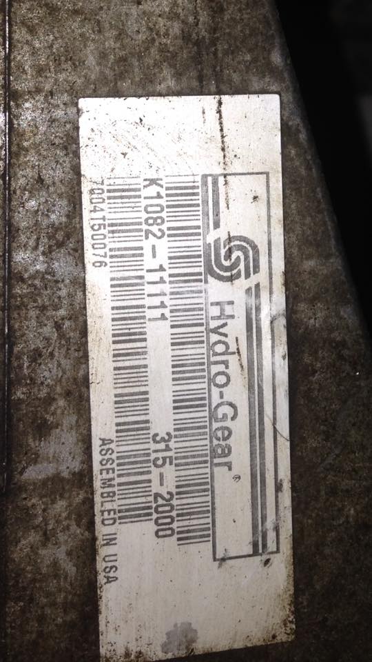

Nephew has a Kubota T1770 with a broken gear in the Hydrostatic transmission.
I've been trying to find a Parts Manual to verify the actual transmission details, but without buying one from Kubota for $60+, the best I can find (so far) is it may be a HydroGear 311-2000 (K1132-11112).
I've asked for a photo of the Kubota model label and one from the Transmission label to help identify the actual details. Hoping he will get these for me on Tuesday afternoon.

Your above Parts Diagram is very helpful and indicates the transaxle as being K1132-11110 which, from what I have just read, has now been replaced by K1132-11120, being a HST3500. Referencing this, it appears to be from the Hydro-Gear GT-3500 series, which has about 8 different models, so it looks like I will still need my nephew to get a copy of the transaxle identification label to verify the actual part reference numbers to confirm his actual installed.
As a side note, Transaxle parts K1132-11110, K1132-11120 and K1082-11110 are not listed in my 2009 HydroGear Cross Reference information, but I do have K1132-11111 and K1082-11111, along with the list of GT-3500 series models.

Good morning all.
Doubts have been clarified with a photo of the transmission label received from my nephew (below).
The actual Hydro-Gear transmission in my nephews Kubota T1770 is a K1082-11111 model 315-2000, being one of the GT-2000 series models. :-)
Have now sourced the specific exploded parts diagram for the 315-2000 and am waiting on Scott (nephew) to call in and advise which gear (or gears) is the one that he has broken.
The parts I think he needs for the 315-2000 are the same as the 311-2000 and are available from the USA.
Until Scott verifies the part, there's not much I can do to see if I can get them here in Oz.
