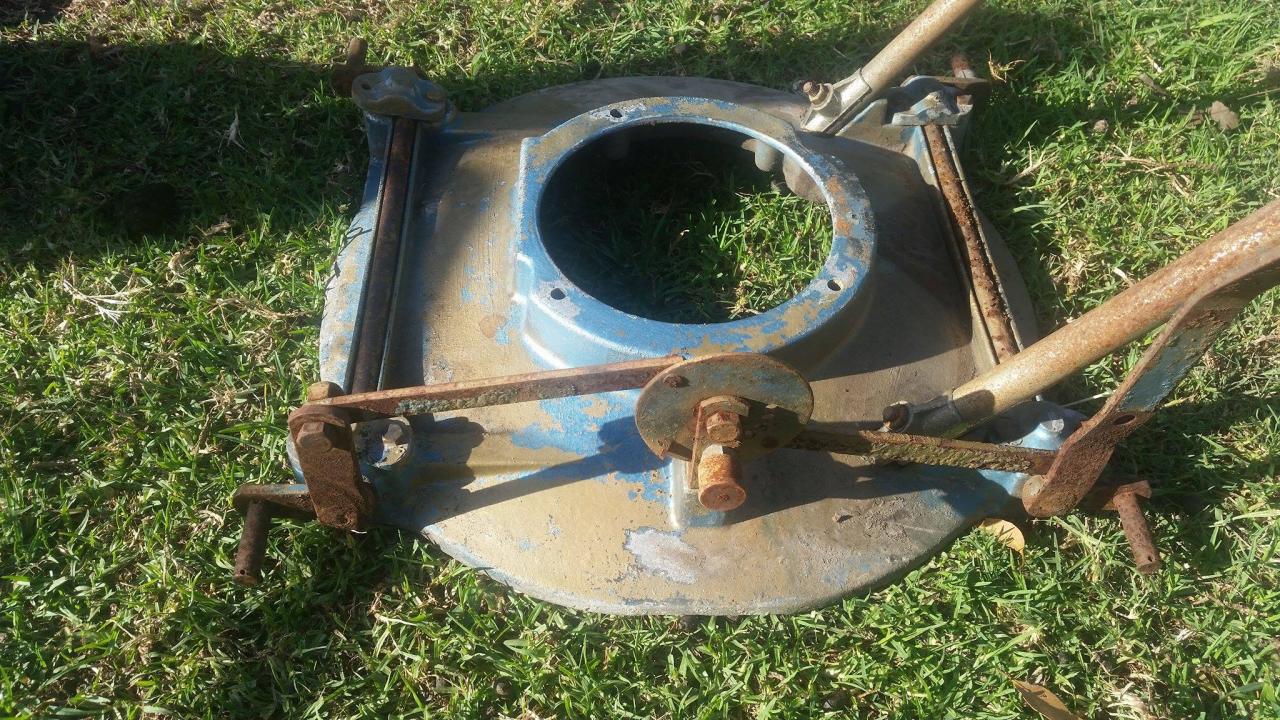

I have recently been asked about this mower. Sadly I can't find any info about it. So i thought i would ask you guys!
It almost seems like a Victa Special model 3 made to match a Kirby LV-30 engine. It also doesn't seem to have any names in the base.
Any information is wanted laugh .
Thanks For Reading!
Kye.
Thanks for reading!

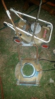

I have more images!
Bottom
Side
I am sure we will be able to identify it soon, he has said something about a plastic thing in the handle bars that says Victa. laugh
Thanks For Reading!
Kye.

That sure is a queer looking rooster. Could it have been an electric to have such a large centre hole and only three mount bolts? If Jack and Kye can't figure it out then I don't reckon there's much hope for the rest of us.

I think the wide hole and 3 bolts is for the Kirby LV-30 4 Stroke engine.
He has showed me the badge that he said he thinks is from it, it was sadly just a normal Victa Special, but i have asked him to get pictures of any other badges in that same style just in case.
The base looks very similar to a Victa Special model 3 and so do the handle bars, The height adjustment looks like it is from or inspired by a Hurricane.
Sorry everyone I added the wrong picture! here is the original.
As you can see the base is very similar to the Victa Special.

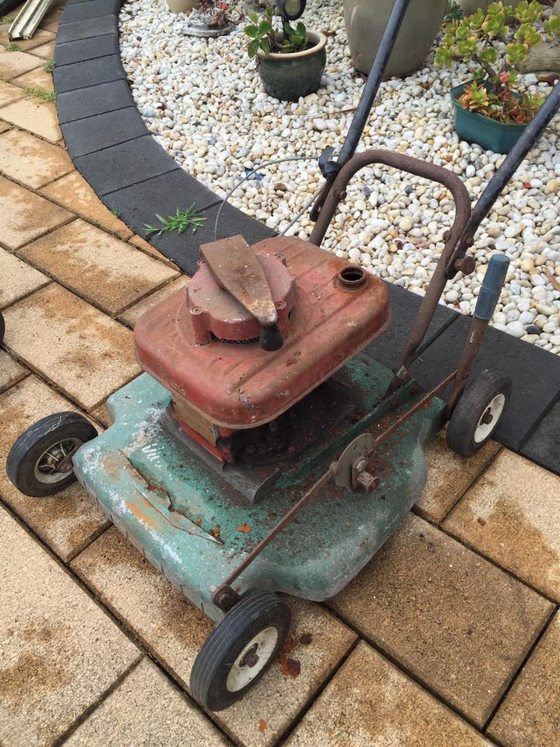

Kye, I don't know what a type 3 base is but does this help

Kye, I have one I believe to be early sixties, it looks like a Rotomo base with a lever adjuster on the right rear wheel. Ill get a pic of that base later this morning. I just checked the link you posted and that seems to say the type 3 is the one without the edger rail. I have one of those I can get a pic of as well

Sorry Kye, just checked them all, all have the edger rail, I thought there was at least one without it. The one I have that looks like a Rotomo base does have the Rotomo style badge but it has a lever height adjuster so I believe it is 60/61 or somewhere about that

This is a utility base that only has a passing resemblance to any
Victa model. It is a toe cutter design and I estimate it dates from between
1960 and 1963. Because we only have the base to go on (no other clues)
I believe the height adjuster is the most unique feature.
Kye has pointed out the close resemblance to the Hurricane 4 I identified

By deduction, I am of the belief that this utility mower was also
manufactured by Hurricane or its parent company ACL [Automotive
Components Limited]. It might be called a Hurricane Utility until we
get better information as to who sold it.
Joined: Nov 2015
Posts: 637
I was swaying towards the Hurricanes today while I was thinking about it! The golden colour on the base is very similar to the SeanW's Hurricane 4 and the one i saw on ebay also had the gold paint. The gold paint does look like it may have been added after being bought though, unless it had a blue undercoat.
Thanks for reading!
Likes: 308
Hi Kye
Well, it's the best evidence I can find at this time.
It is more probable than not that Hurricane (or ACL) made the ute base.
p.s. I forgot to mention that Norm's photo is awesome.
