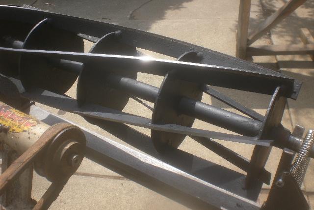

hi all i purchased a reel grinder some time ago to look after my scott bonnar mowers my self , when my local mower shop of 60 years closed down I brought it.
sharpened a reel and bedknife today from my 17 inch scott bonnar, grinder is quite simple to use, first true it up to the reel axles, then grind each blade one at a time with some back relief from the cutting edge.
the bedknive I sharpen on my milling machine, this one was badly rusted and I had to take off more than I would have liked to remove pitting and get a nice clean edge again,
any odk members in melb I can sharpen reels and bedknives for $40 pm me if intrested
thanks all damo aussie

BTW Bowling Clubs get their reels done on far bigger and more accurate machines than this one. Those high tolerance reels are done on Spin Grinders which spins the reel at high speed while grinding.
Also reels should be ground with their bearings mounted on the shaft as that how it will sit in the mower and this is what one is try to replicate.

hi all not much use going to any of the bowling clubs round were I live, most don't use mowers any more they have synthetic turf, a while back when Victoria went through a bad drought and we had water restrictions the turf got ripped out.
yes its a old machine but that's the way all reels were ground once apon a time , things have improved a lot in 60 or so years of turf care since then, this machine is meant to grind the reel on its shaft as the reel is not spinning, the reels shaft axel are held firmly by springs and each blade is ground individually , you can see this being done on utube,you would think being ground to the shaft is more accurate as the solid shaft has no play at all unlike a bearing,newer machines have to use the bearing to spin the reel up, it still gives good results a razor sharp reel, when set up slices through paper like butter without even backlaping as I,m to lazy to bother,
btw its not rocket science cylinder mower reels have been sharpened for nearly 200 years

Thought I'd put my 2 cents worth in as I have been a bowling greenkeeper for 40 years.My cylinders are done on bearings and are spun while ground (no relief).I think the single blade grinding is just fine as well and dodegy it sounds like you have got great results.I used to get my cylinders ground regulary.In recent years I have rarely had them done.However,30" Queen mowers can reverse cylinders to bring the trailing edge to the cutting edge.This combined with daily backlapping and quality non worn bearings has seen sharp cutting for the life of the bottom blade.The only time I grind seems to be when top soiling greens.I highly recommend backlapping at the the end of each cutting session.Wash or air dry,backlap and set mower for next time when everything is dry

Dodegy has said that this is the way reels were ground once-upon-a-time.
Absolutely. I have been recording and cataloging reel maintenance methods
for years.
In the 19th century - in the field - the main means of sharpening reels
was by means of files and emery dust. This would be undertaken in con-
junction with backlapping. They went hand in hand.
The quality of the result was dependent upon the quality of the tradesman
(or novice). Manufacturers would have used powered grinders (powered by
water or steam).
Everything changed by the turn of the 20th Century. It may be that
this was driven, in part, by an increasing demand for precision
mowers in the public sphere - sporting grounds; golf clubs ...
Lawnmower manufacturers and specialist companies starting making
purpose-built machines. The major advancement was with the
advent of domestic electricity, and these grinders were made
in hand powered and then electric powered grinders.
I have found many ads from the 1920s that promoted a new type
of grinder that sharpened the blades in situ. In my books, not
a great method for residential mowers, with no planned service
intervals. Most mowers should be disassembled to check bearings
and re-lubricate the internals. I would also point out that ball-
bearings were the more expensive option to plain bearings at this
time (on domestic mowers).
The more common machines were as per dodgey's machine.
The mass-produced versions were built with precision, having
rigid cast iron side frames for this purpose. Reels were spun
on hardened V blocks.
Dodegy's machine is not a mass-produced job, but like many
grinders of that time, were one-offs build by small engineering
works as need arose. The precision of these machines varied -
some better than others. Dodgey's machine would have only
average precision built into it.
These machines can produce acceptable to very good results,
but they are more labour-intensive and do require experienced
operators. So the price dodegy has quoted seems extraordinarily
good value - and may make many machines viable for repair.
Of course these grinders will not deliver the precision required
for modern professional equipment (as BB said), but that is rather
a different argument, not pertaining to the service offered here.
The proof of a good result is in whether a good set can be
achieved 'out of the box' - meaning once the reel and bedknife
are ground they should immediately give a nice set without
need for backlapping.
On that note, I'm glad sb30inch raised the issue of backlapping.
It is the single most underrated procedure to keep reels sharp
during the season. With backlapping and good setting, there is
no reason why domestic reel mowers would need sharpening for
many seasons.
I know two methods of setting have been spoken about on these forums.
I can say that ODK can not recommend any method that changes the
manufacturer's recommendation. The non-contact method has a limited
application for some professional mowers. For most reels,
the contact method is the method to use - but always check what the
manufacturer says.
