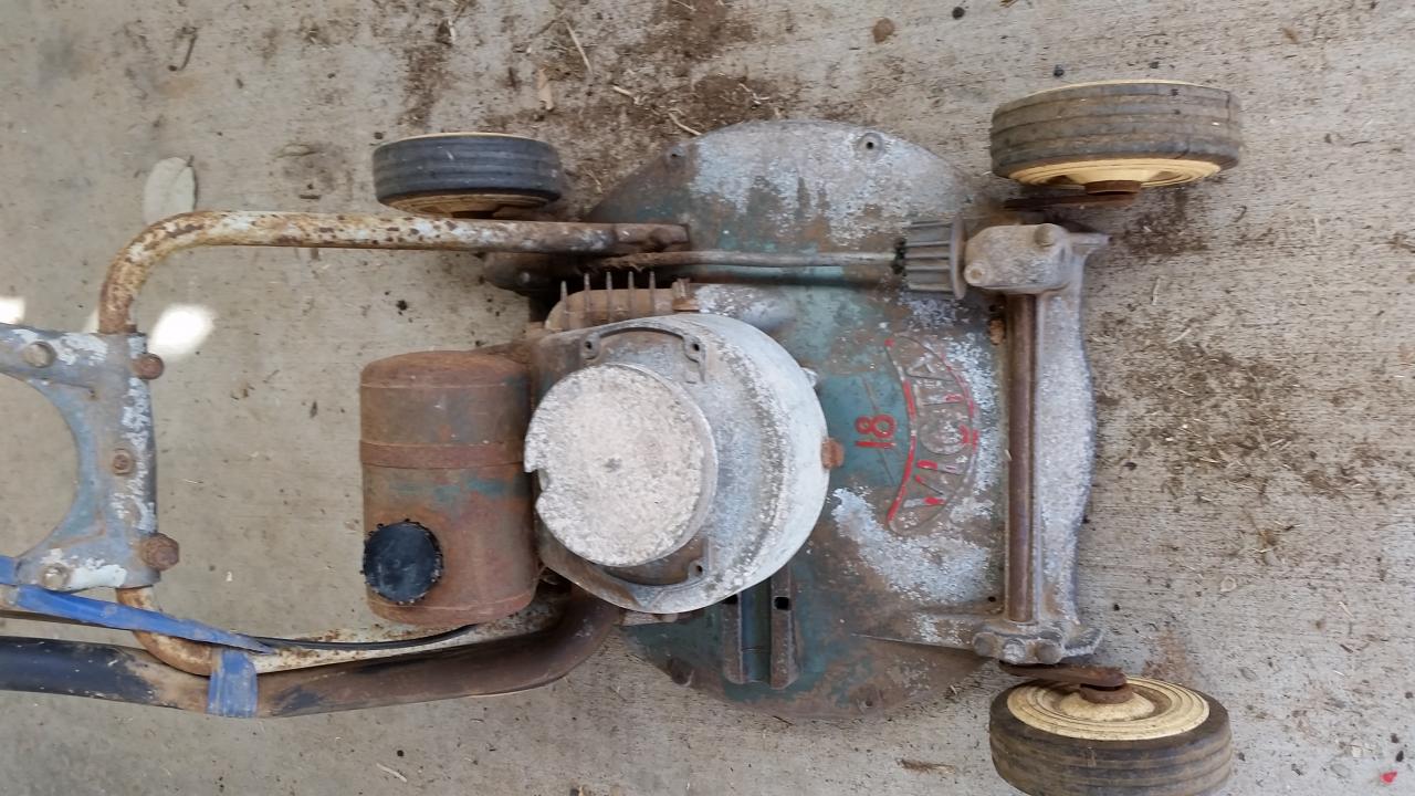

Can someone please identify this model for me. The engine number is 136175 with the number 3 under it.
Posts: 988
Likes: 7
Hi and welcome,
A picture of the complete mower would be helpful as an engine could be fitted onto any chassis
With that engine number it may be a Victa model 4 standard

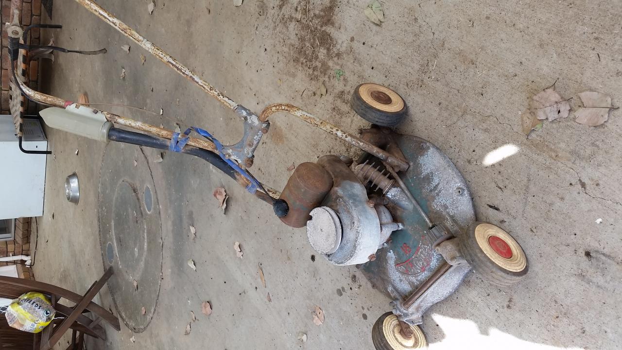

I purchased it for $20 2 days ago, not even knowing there was a following of these things. I just thought it would be a good project for me and my 9 year old to get going and to get him away from the playstation.
I have found one drama, there is no spark, so im thinking a coil issue? are they easily sourced?
Posts: 988
Likes: 7
Good project, no spark might just be a combination of dirty points and a poor coil lead. To get at the points you will need to remove the cowl/fuel tank and then the flywheel. Use a puller on the flywheel, there are 3 threaded holes to take the puller bolts. I think the bolts needed are 1/4" whitworth.
Oh and to get the starter pulley off you need a block of wood and a hammer, knock the pulley backwards by putting the wood against the rope slot and give it a good hit to jar it loose.

1957 I think, it is missing all the Auto parts, which are the dear parts, luckily for you! These are not needed to make a full restoration, as you can see on the second link I say, these mowers were sold like this. You can find an Auto with all the stuff on it here , they cost lots! But yours is a Victa Special with a Auto chassis, which is the first one here . If you really really wanted to you could collect all the parts, but the side flaps recently went for $700 on ebay, the rear flap went for $600, and I haven't seen a front flap, so they become an expensive mower! I have been told a complete one sells for around $5000! good luck with the resto and i can't wait to see it!

I would say that the engine number is too high to have been an auto, the chassis kept going for a while after they ditched the auto idea.

Yep, the highest confirmed engine number for the 'Model 4 Predicta/Auto' is around 128-130,000, as far as ODK members have been able to determine.
So as you posted above, that would make this one a 'Model 4 Standard', 1957-58. These were made concurrently with the Model 5 Special Series 1, seemingly to use up the Model 4 chassis that were on hand.
Therefore, setting this one up as a Predicta would be incorrect, as it wasn't originally sold as such.
