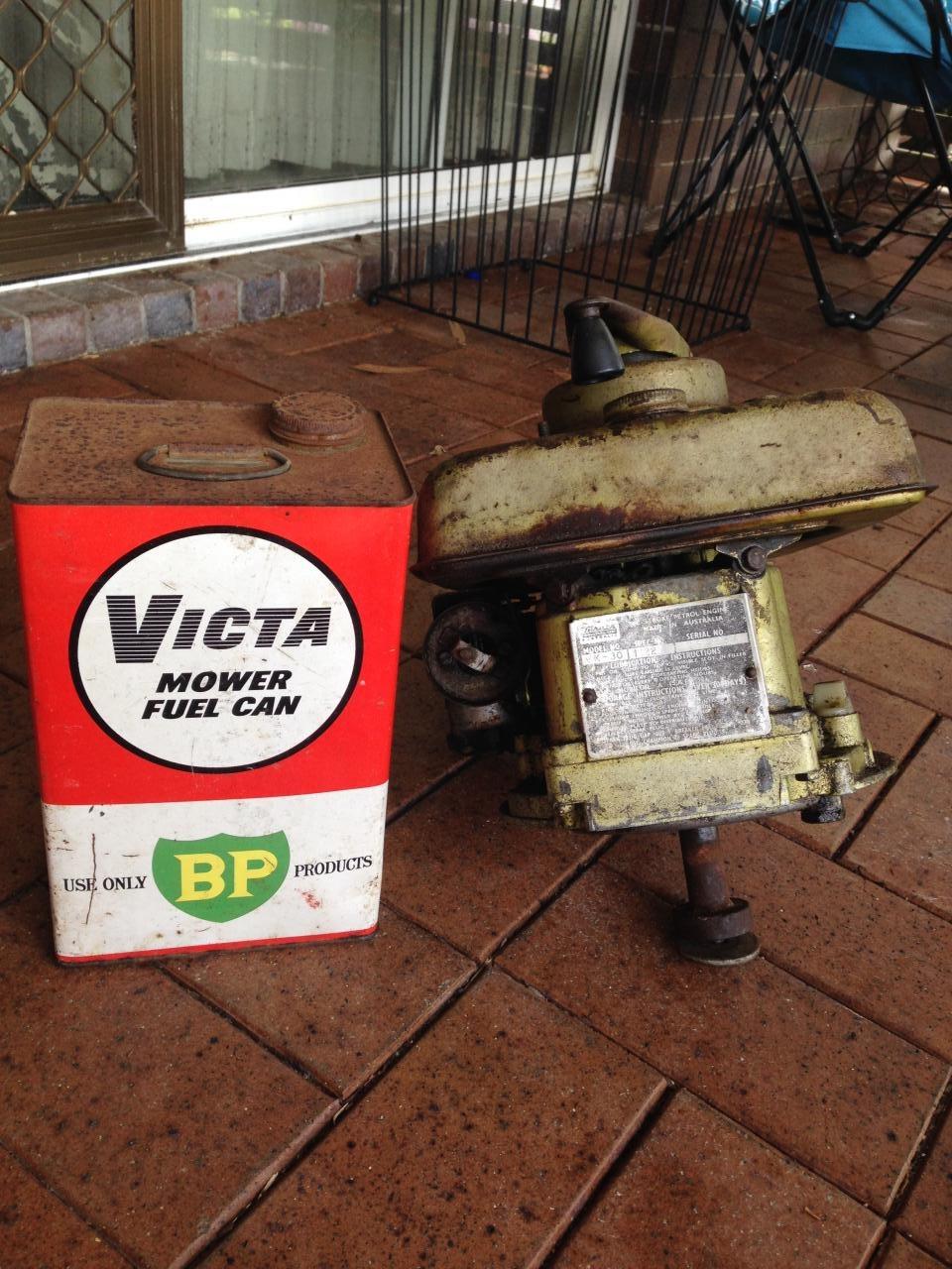

I bought myself a nice little Kirby KV-30 today. Has a Turner tag on it, possibly of the Turner version of the Eric!
Also got a nice Victa BP tin and the Pace hubcaps I needed for my Pace Super.
Expect another "this weekends scores" post tomorrow afternoon or tonight, I am picking up a mower I have been waiting all week for that I am sure you will all like.
I can't work out how to make images straight, no matter which way I hold the camera it never ends up right on ODK. The second image doesn't have the Pace hubcap since I had already put it on my Pace when I tried to re-take the picture.
Thanks For Reading!
Kye.

We had that exact mower can when I was young.
