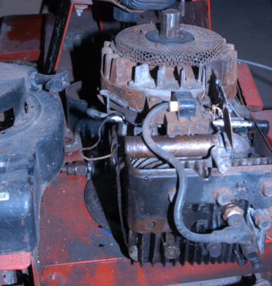

turns out it's not a colt8 it's the 5 going by the diagrams of front end as the 8 is slightly different, so far have replaced front wheel bearings and put front end back together doing the back next, the engine that was in photo is going to be trashed as can't get any parts for it and it's not the right engine for it ,will have to find a 5 hp B& s engine, well could have fitted the 8 hp if it had had all the missing parts though don't know if it runs .so not worth all the hassle easier to find another engine complete and drop it in.

The 206cc cowl definitely relates to 5HP.
The original Colts were powered by 4hp (10 Series) and 5hp (13 Series) Briggs.
In the 1980s this was upgraded to 5hp (13 Series) and 8hp (19 Series).

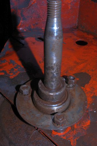

I have been trying to get the flange bearings off so the wheel bearings can get replaced so far not moving used half can of rust penetrating lube I got and good rub down with emery paper and wire brush got the grub screws out
I am beginning to think these may be pressed on

Not pressed on they are rusted on, you have to get the lock collar to move and in some cases the only way is with a bearing puller that hooks in between the collar and the bearing. You may get it to move with a cold chisel by trying to split it through the grub screw hole, this will start to expand it but it means you would need to get new ones. Lift the motor off again and tip the mower upside down, easier to work on

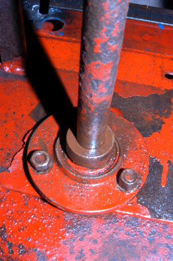

had a small win with getting part of the flangette bearing off ,the one in second pic
above,(in update) I took the whole rear end to a small engineering firm a one man shop, he took one look at the set up and said that the hole opposite the one with the grub screw are what he called centrifugal ,think that's what he called them ,he got a long pointed item like a centre punch but bigger length wise put it in hit it a few times and it came off with no problem what so ever ,the one he did say there will be a problem with is the one that's part of the disc brake could be very tricky to get off, though he did say if I get stuck just bring it in and he'll put some heat on it and try to get it off with out damaging it,so I am getting there slowly ,it would have helped more if the manual rover had on the colt 5 gave details of how these parts come apart and in what order,but then that would be too easy.

Well progress has been a bit slow but there is light at the end of the tunnel , the rear axle is already to go back in got it back from the engineering place after work today , they done a top job on it more than I expected ,not only did they strip it down they cleaned it , regrease everything and fitted the new wheel bearings as seen in the photo's so it's ready to go back into the mower ,might do it this wk/end,then can start toying around with fitting the new engine ,
shouldn't be to big a hassle just have to modify the back of the seat corners ,also got a new seat, then there's the pulley that the john (in Kirwan ) gave me it's a bit bigger than the original so will that affect the v belt or would I be better off trying to round off the damaged bits on the original and then refit it?

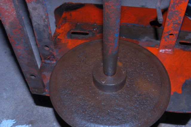

here are some shots of the pulley's the one on the left is the old one (damaged) I did take it into work and rounded off the sharper edges at the damaged areas only .
the pulley on the right is the bigger pulley

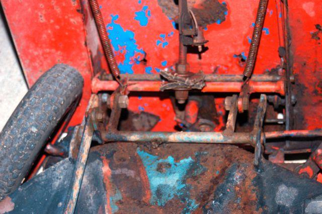

the belt tensioner is another problem there isn't one,so I went up to see old john in Kirwan and he's got to colt 5's coming in to him in the next 2 weeks some I may be able to get the tensioner off one of them.
fixin-it #74683 17/04/16 08:22 AM
Posts: 8,216
The one on the left I would say is out of the question. Are the bore sizes the same one looks bigger than the other. The bigger pulley should be ok but you may need slightly bigger belts. Do you have to original belts to check it with?

Well dragged the mower out into the yard and gave it a degrease underneath hosed off cleaned up well
it was originally blue as was the deck
then someone painted it red and black for deck
and as it's already half stripped just considering a complete strip down and get it re painted or sand blasted and the powder coat it. ,as most of existing paint underside is peeling off and will start the rust off .
