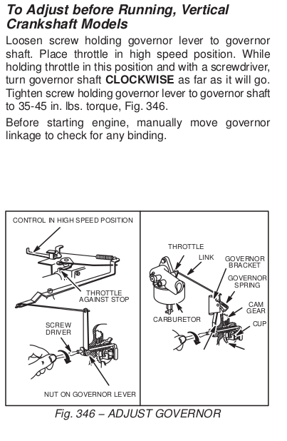

Possibly, but it would be a little difficult to get it right, without an original to duplicate. It's not a complex part - nearly straight, with z-bends at either end.
The critical bit is the length between the z-bends, and their orientation. The wire is nothing special - mild steel will be fine. You may have to make up a few lengths, to try them out. There is some leeway in the setup, in the form of adjusting the governor lever on its shaft.
This is the adjustment procedure:
There is another part P/N (260971) which appears to be for the models pre 1982 (pre 82121010) , that is available in Australia, would that be close enough?
Not extremely likely. But if it's cheap enough, it might be worth trying. From the IPL [ http://bsintek.basco.com/BriggsDocumentDisplay/Z6nlxBVJ1DajI.pdf ], it seems that the throttle control plate [part 222] changed on that date. But the throttle shaft and governor lever did not, so the reason for the link change isn't clear. It might be as simple as a slight bend added, for clearance.
