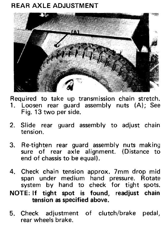

Can anyone please tell me how we can tighten the chain on a rover colt 5 ride on mower?

The whole guard assembly moves back and forward.

Olga
Thanks Jack,
seems to have worked, although really hard to move!!Probably 25 hyears old and never been moved!!

You're welcome.
The main thing is that each side is moved evenly for alignment.
