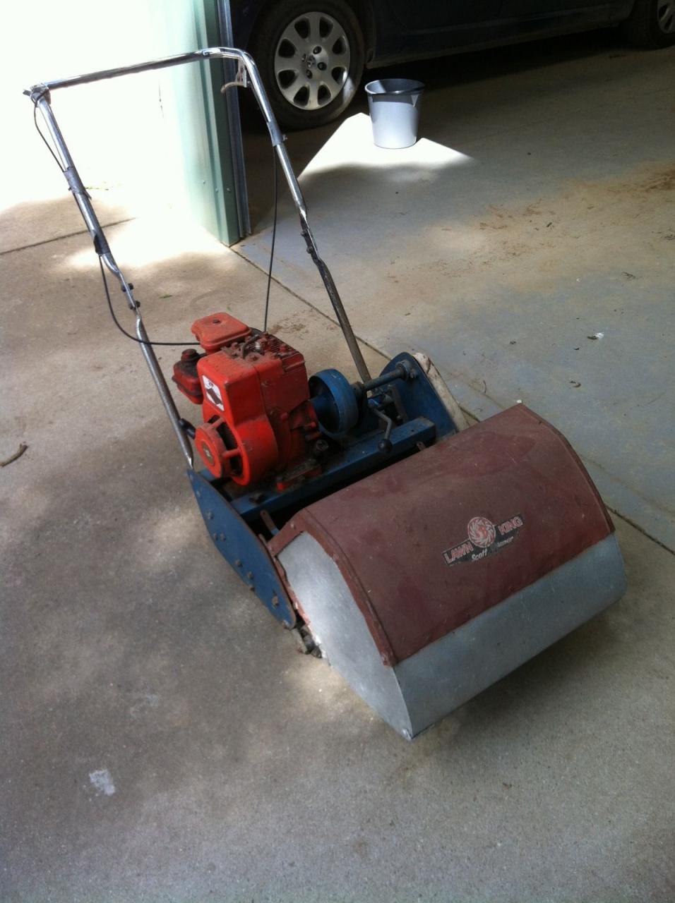

While this is a Model 45 Lawn King, this mower displays the blue livery with the same decal as shown on the silver version. I though that I would add this just for completeness of discussion regarding liveries and decals.
