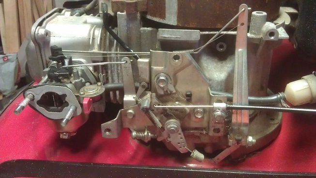

Ok, di some more checking. Decided if I'm going to ask for help, I better supply some more happy snaps. [Linked Image]
This is in Stop position
This is in the Start/Choke position
And this last one is in the Run position.

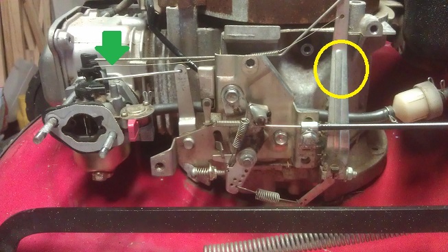

As previously stated, got the engine running, but to get what I would consider normal revs, I had to manually adjust governor bar (Circled yellow) towards rear of mower. Could this be due to a bad adjustment or is the governor spring (green arrow) suspect ??
Posts: 8,086
Likes: 220
Sorry but now I can't help, it is a case of working with it to see where it runs best, quite possibly just an adjustment somewhere. For it to run for 30 seconds before you turned it off sort of indicates the carby is probably ok. There is a lot to be said for the old carbs with a slide instead of all the junk they have plastered all over them now, springs,levers,arms everywhere all in the name of progress
