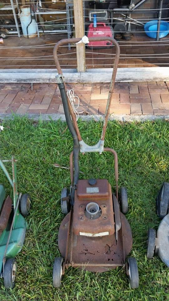

yes i am planning on trying some modifying once me and my dad get some time, i might just modify the exhaust so it sounds louder then usual. Performance will come second behind looks though! i will probably put some brass or copper pipe from the fuel [Censored] down to the carby instead of the plastic. I will get a pic of it next time it is sunny, here is a pick of it so far, so far i have changed the original 1967 (i think) engine (was seized badly) with an earlier Utility engine i bought for $12 at a swap meet, changed all axels and wheels, took of the pull start, put on new air filter and air hose and put a screw into a hole on the handle bars for a pull start to be wrapped around, so despite not looking like much a fair bit has been done. [Linked Image]

Kye, that copper fuel line's s a cracker of an idea I might do that myself sometime it'll look a treat all polished up. Having a project with your dad is an investment in time. So much to learn about what works and what doesn't how to do things and how not to do things. My young bloke is 5 and already loves loitering in my garage and finding treasure.
Anyway back to that toe cuter, she'll be a ball tearer mate. You can refine many skills from welding to mechanical and fault finding. Best of luck mate and keep us posted.

thanks slash, my brothers 8 and he hates working on my mowers, until there fired up and running laugh. Its all good norm! I have a few bases and the holes in the base add to the rat rod affect! if even thinking about putting an exhaust i found in a scrap pile on a farm out west into it that has super bad weld marks, moss growing on it and has rusted through!

Looks awesome, inspiring me on what to do with my rover regal barn find. I love it.
I'd clear coat the deck to protect it and ensure the rust does not continue getting worse. I believe you can buy rust stopper or something like that.

i would victa pro, but i'm scared it will kill of moss starting to grow on it laugh
