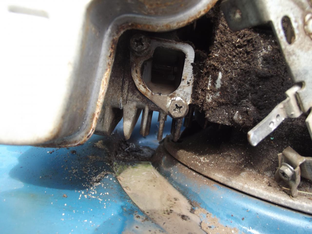

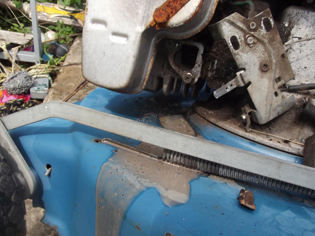

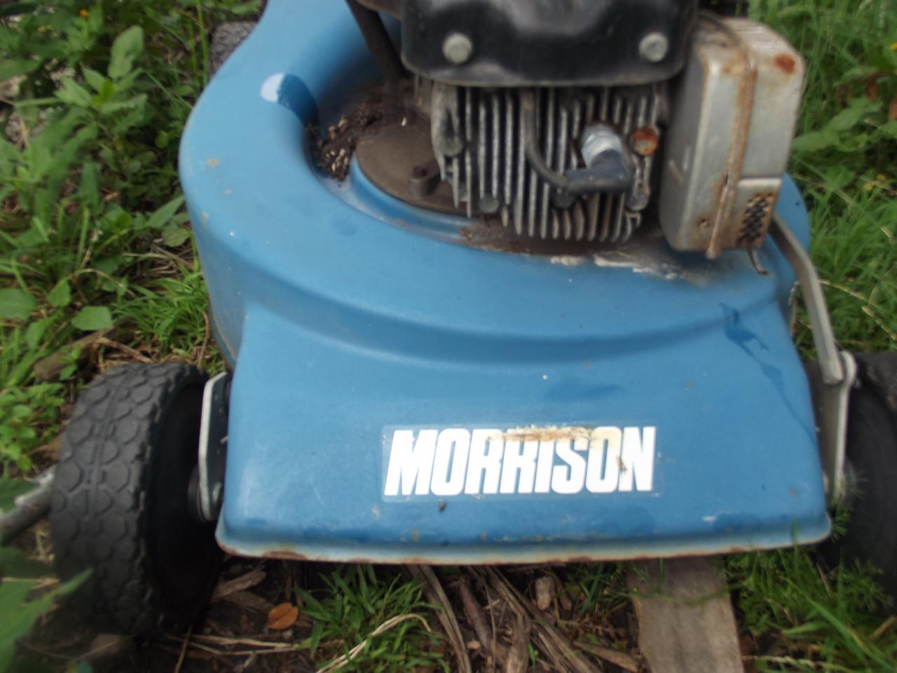

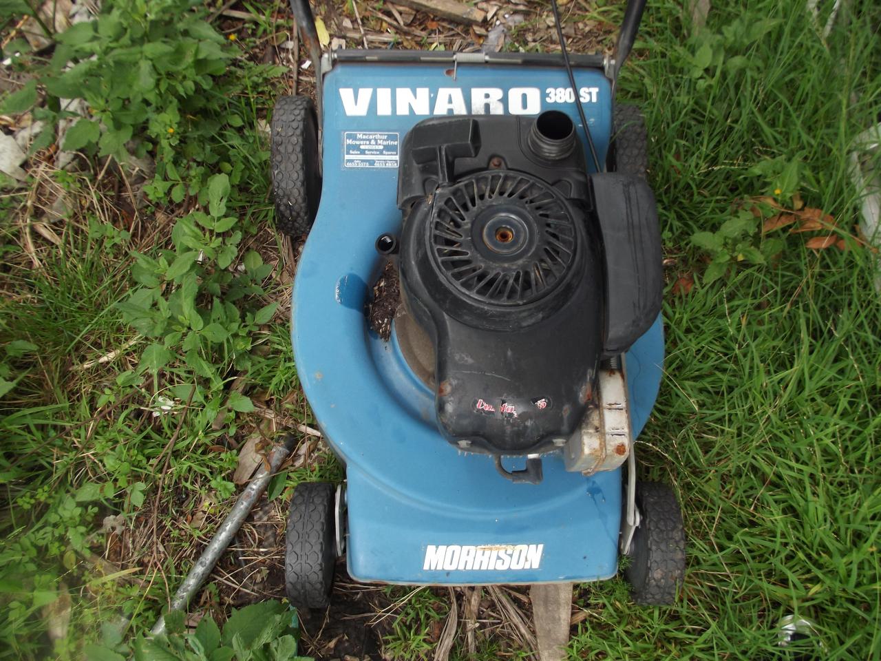

seanw
from nz i think. i like the wheels
strange. it had now fuel cap of oil dipstick.
got it 5 mins before it started to rain.
seems a very sturdy frame with blade bar with retracting blades at the end
anyone seen one before?
sean

Seen a couple of these at work over the years.not sure ....maybe Tecumseh engine.honestly cannot remember
Posts: 23
Never Heard of it, looks a lot like a Tecumseh to me.
Victa Pro 12- project rust bucket
Posts: 960
Seen heaps of them, It's a masport in disguise and got an Italian made tecumseh on it. A carby rebuild should see it good to go.

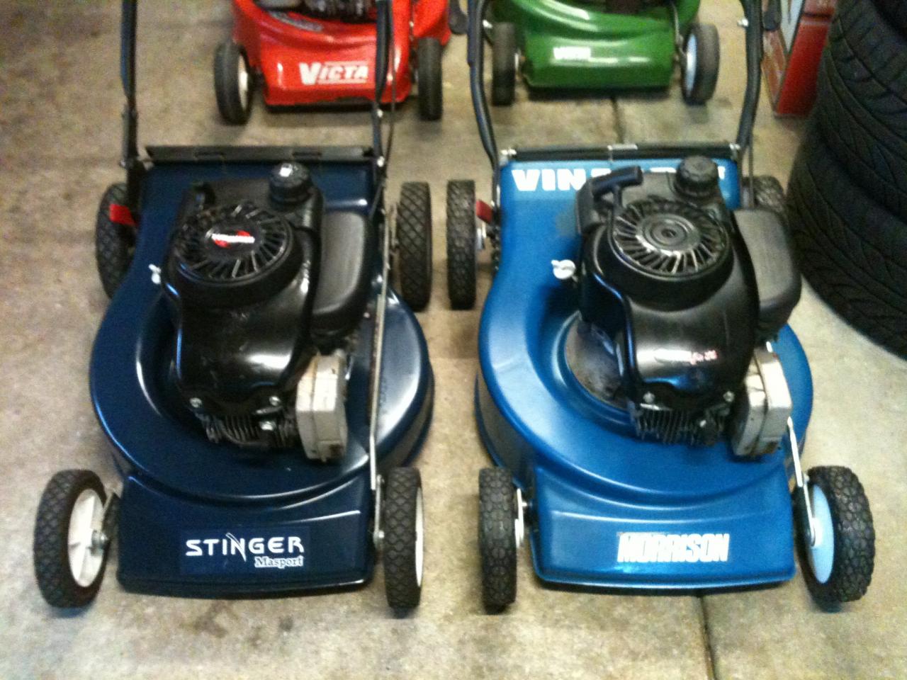

Here's a couple i prepared earlier
Posts: 988
Likes: 7
Here is the Tecumseh on a Victa base, would have to say not much style about the engine cowl. Looks much better painted black
Posts: 715
seanw

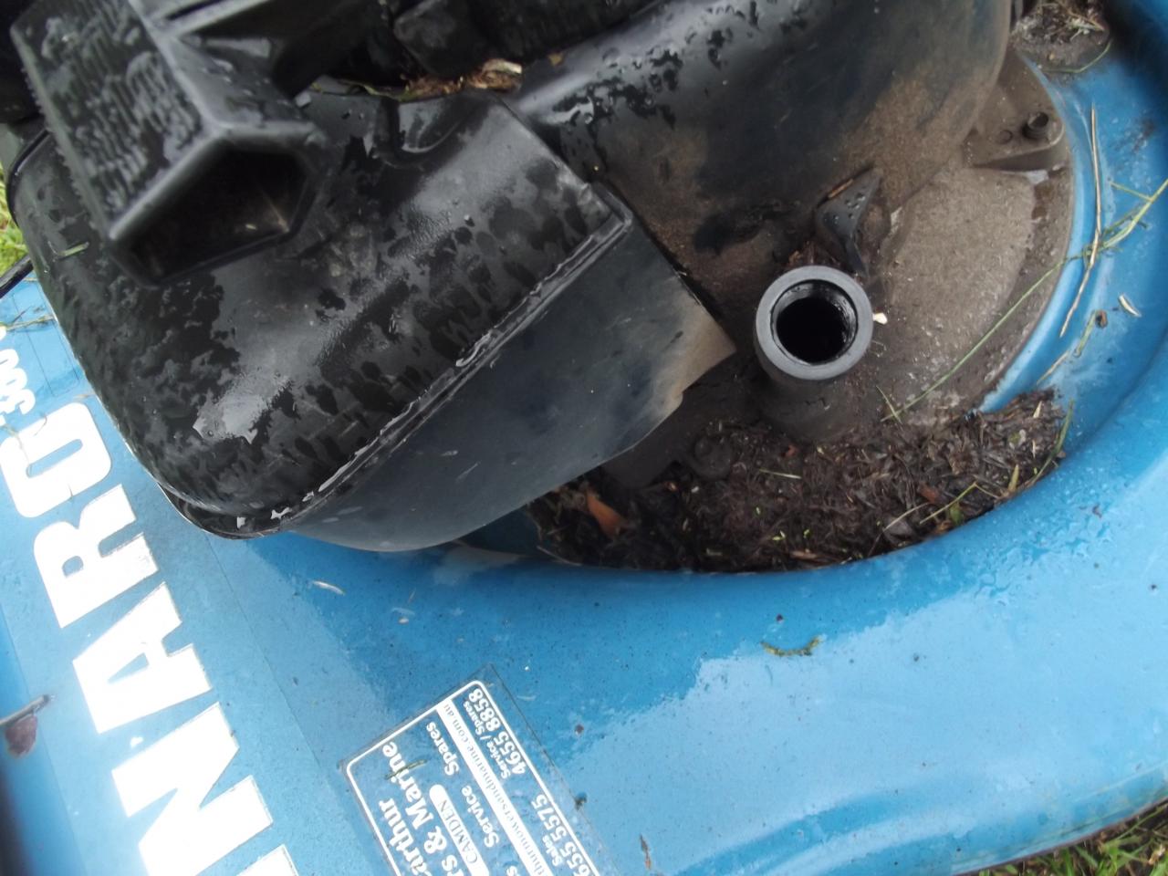

thanks for the input fellas. question, this came without a fuel cap and oil dipstick/cap. [Linked Image]
can i just find a bolt to suit and block it of. i measured the oil level with a skewer, it has 2 inches of oil in it. the fuel tank was completely dry and clean and so is the oil.
thanks again
sean

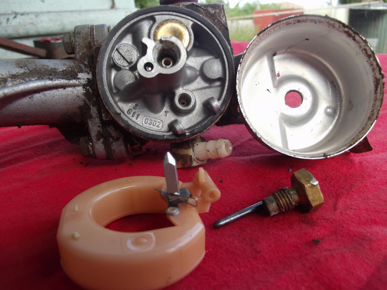

seanw
upon removal of the carby. i found this
the carby was full of clear water
few fiddly bits in this one
